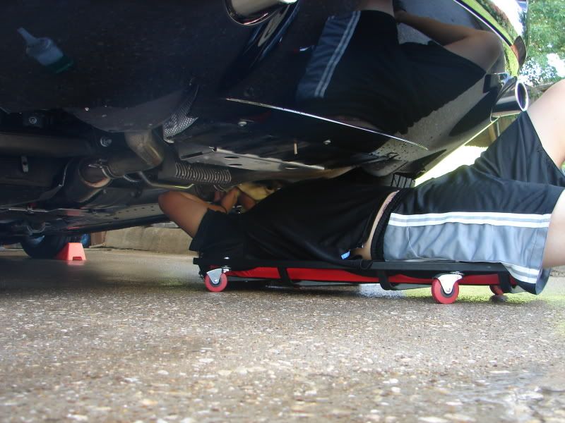

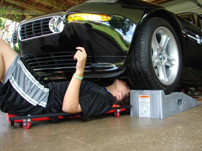

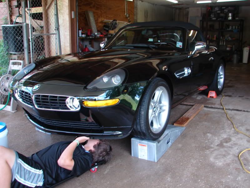

Before I got started on anything I wanted to get the undercarriage out of the way. So we drove it up on rhino ramps and squeezed under the car to wash it out.
It was a tight fit but we managed. Basically rinsed it down, then washed it with an old mitt, rerinsed and gave it a good wipe down with some MF towels.
It was really not very dirty at all, just some water spots and a little grime around the wheel suspension parts but nothing too much.
We finished the back side then flipped the car around and did the front side.
All and all took us about 2 hours.

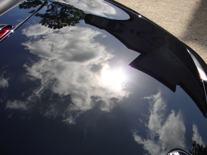

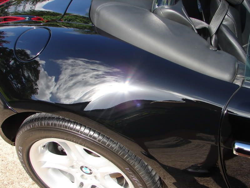

The next step was simply a jeweling step to enhance the paint even further so I used Menz FPII (final polish II) with a black pad at 1100rpms.
The results were perfection.
I then rewashed it and protected it with my new favorite sealant, Blackfire Wet Diamond.
I applied the sealant with an orbital and a black pad at speed setting 3.
I just showed the 3 step process with the rotary, 1 step cut out swirls but left behind buffer trails, 2 step took out buffer trails, 3 step jeweled the finished for perfect flawless depth and brilliance. Rewash and protection applied.

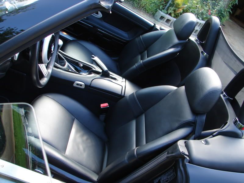

Of course the interior was dusted, vacuumed, 303 wipe down.

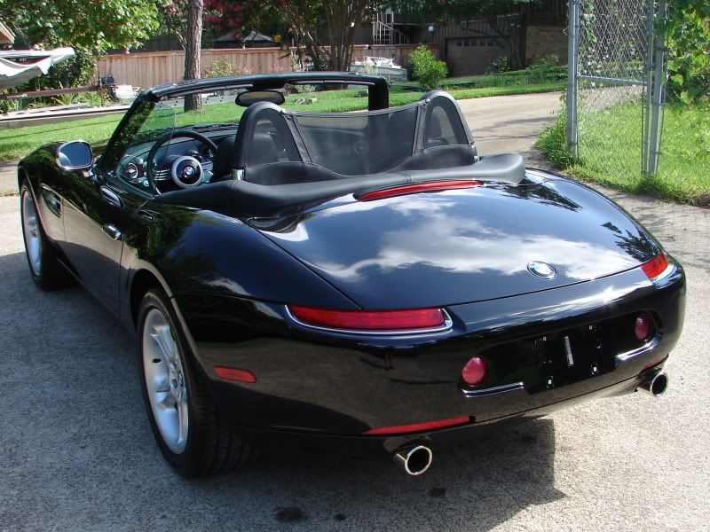

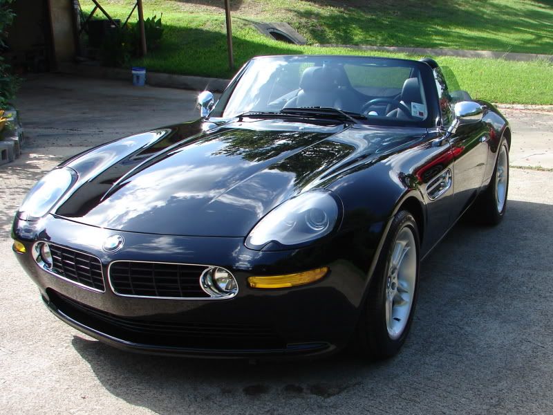

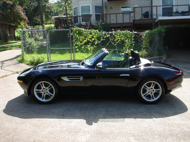

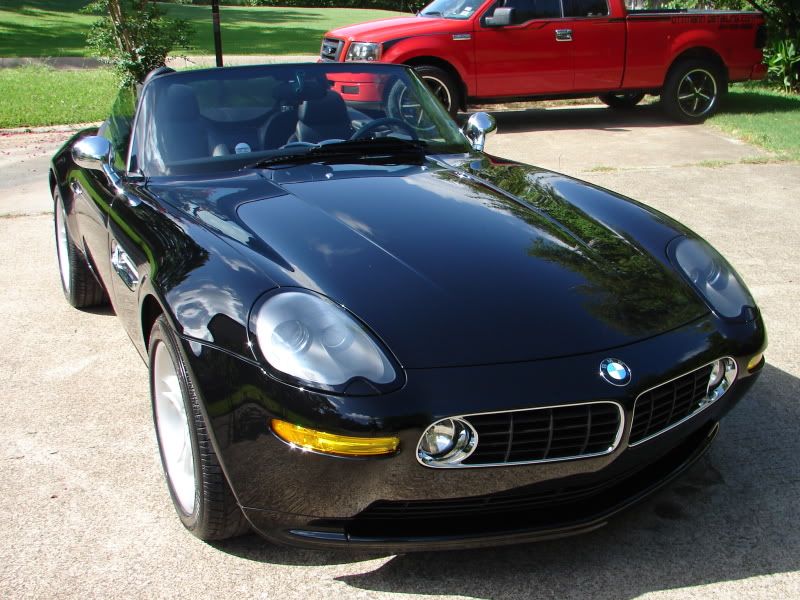

Here are some afters.
Oh yea, even polished behind the license plate.

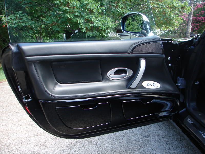

Interior looking nice.

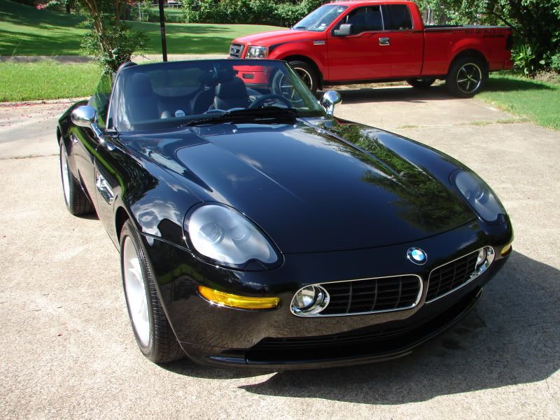

These are the best sun shots I could get. Sun was playing peek a boo.
All and all 19 hours spent from start to finish but it ended up being a 3 step job on the paint and 2 hours of it where spent under the car and about 1 1/2 on the interior.
Some full shots to come.

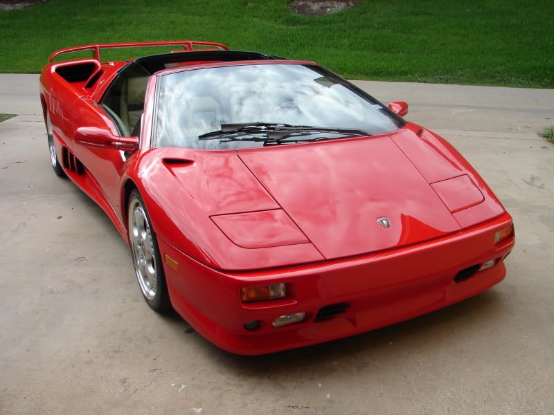

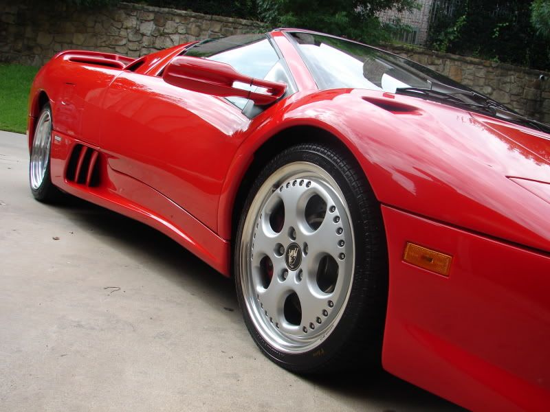

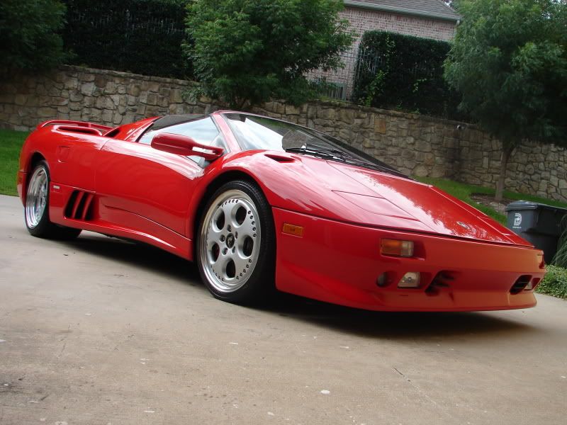

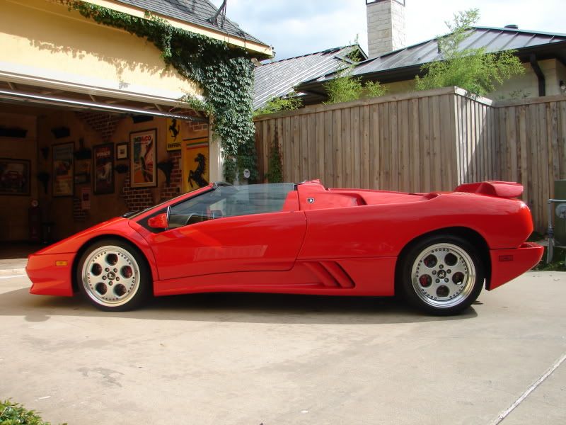

Next up is a 98 Red Lamborghini Diablo VT Roadster.
This was a little more basic detail. I performed my Stage 1 Polishing process on it, took about 7 hours total start to finish inside out.
After I washed, clayed and did all the wheels and such I buffed it once over with M105, orange pad at 6000 opm's.
The before and afters are very hard to see, but I'll do my best to show you what I saw.
Basically a bit of hazy paint was all there was on this car, not many swirls and I felt like the paint was really hard as well.
Here's a before of some haziness. (tough to see)
After M105 with orange on ROB machine.
Cleaner and haze removed.
The whole car was this way but I just couldn't capture it with my camera due to lighting and color of the car.
So I will have to move onto the after pics.

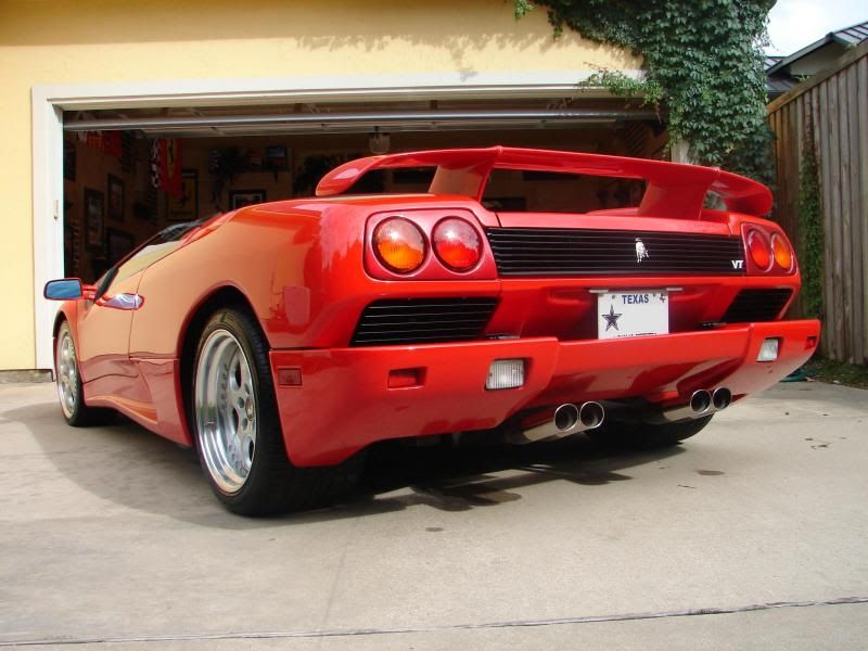

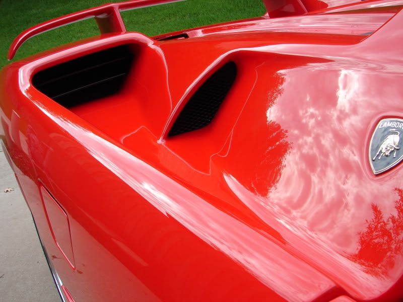

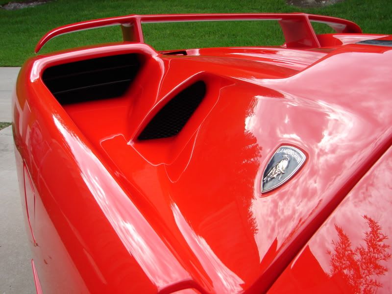

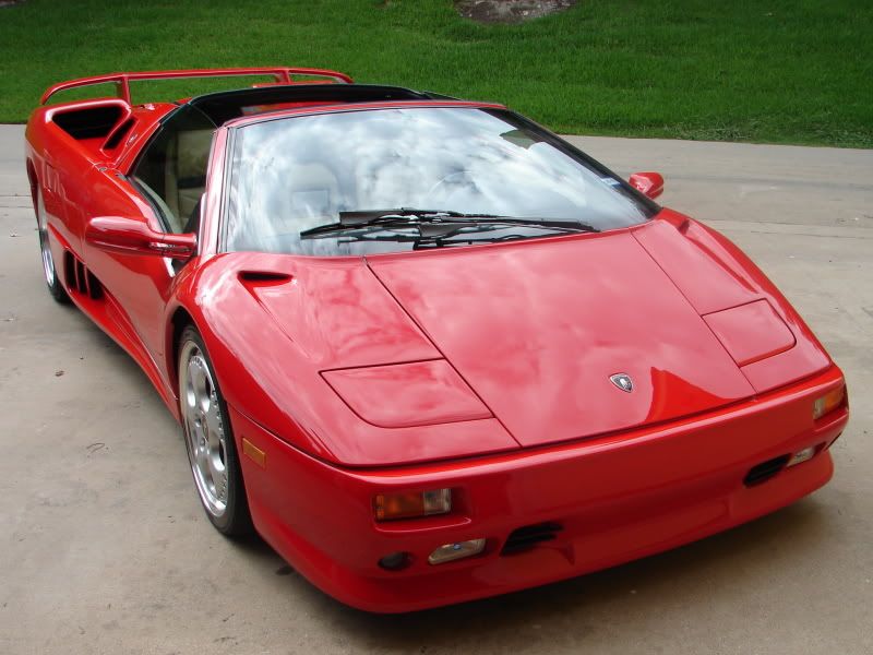

I rewashed it after the 1 step and then use Blackfire Wet Diamond to protect it.

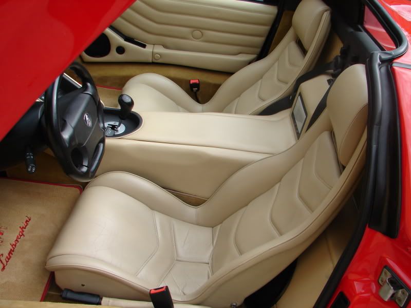

Interior was dusted, vacuumed, 303 wipe down and Zaino Z10 leather conditioner on all leather.
I think it turned out rather nicely.
Here's me working on the hood.

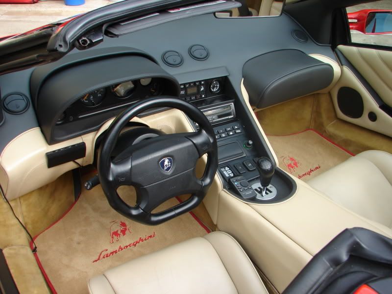

A couple interior pics
Interior was in excellent condition for it's age.

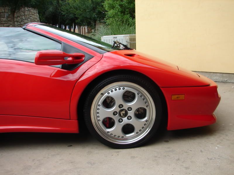

A couple more cool pics and I'm done.
Thanks for looking, which do you like best?? It's a toughy for me. I love the Z8 but the Diablo Roadster is just killer??
