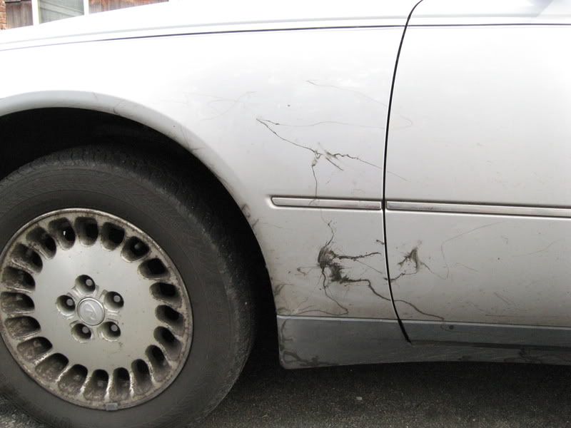

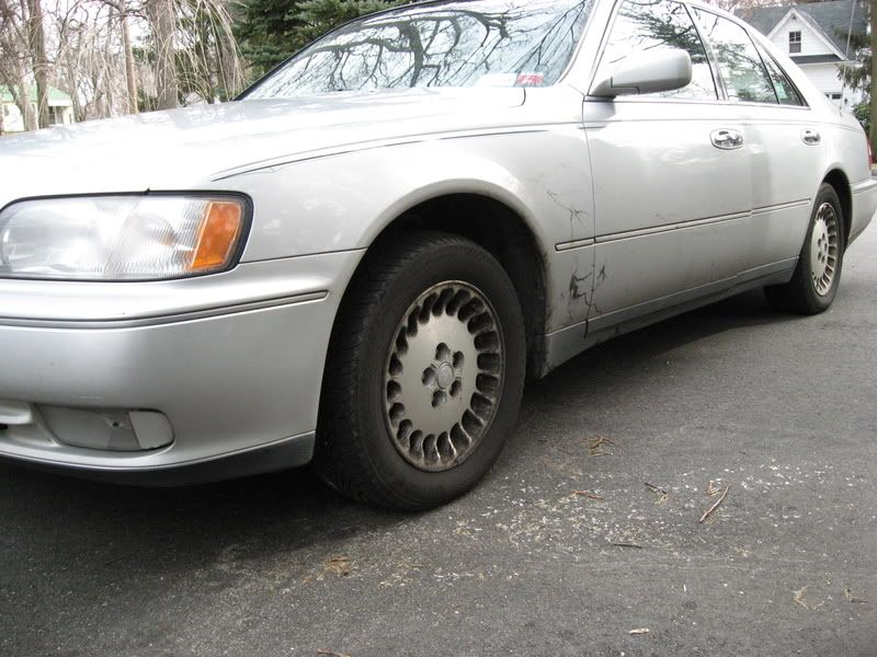

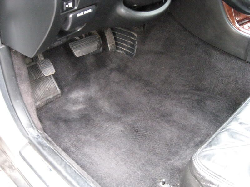

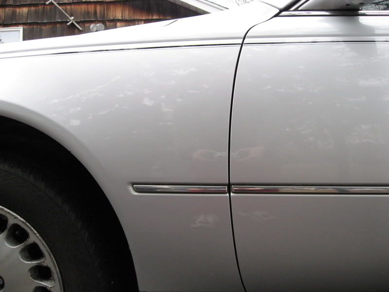

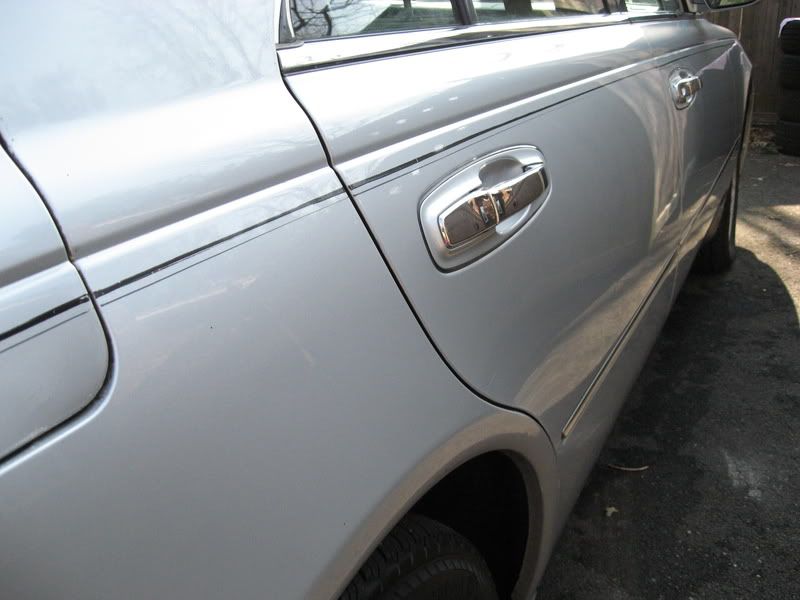

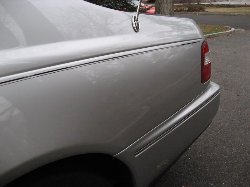

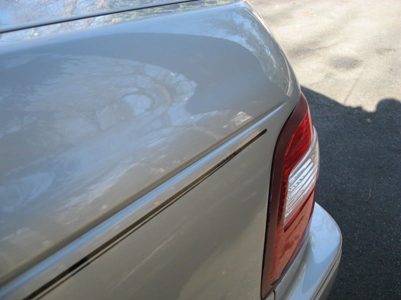

The owner said he had not washed the car in over a year. I believe him. There was a lot of tar and birdbombs on the paint, and so much crap in the interior that I think it actually protected the carpets.

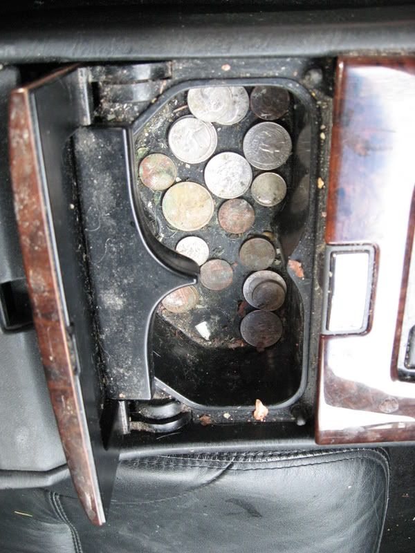

The shot of the coins in the tray are ones that I couldn't physically remove with my hands because a pack of coughdrops melted in there.

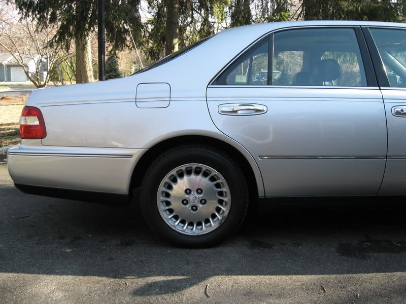

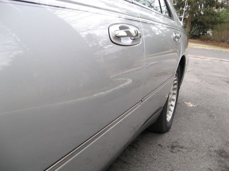

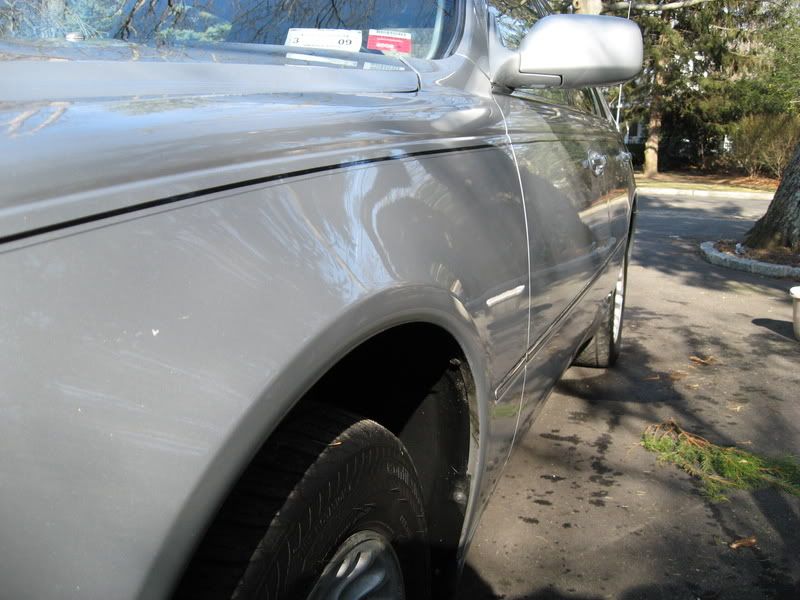

Process: (I tried geting rid of some old stuff on this car)
Soaked Entire Car in Turtle Wax Bug & Tar Remover
Wash w/ NXT
Meguiars Clay
Hi-temp Medium Cut on Orange Cutting Pad, Speed 6
CG WMF on White Polishing Pad, Speed 5
FK1 2180 By Hand

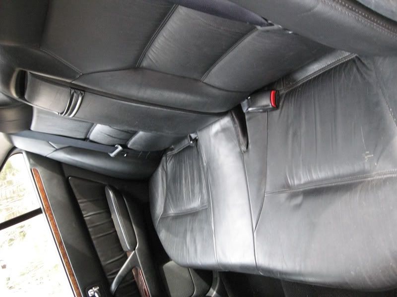

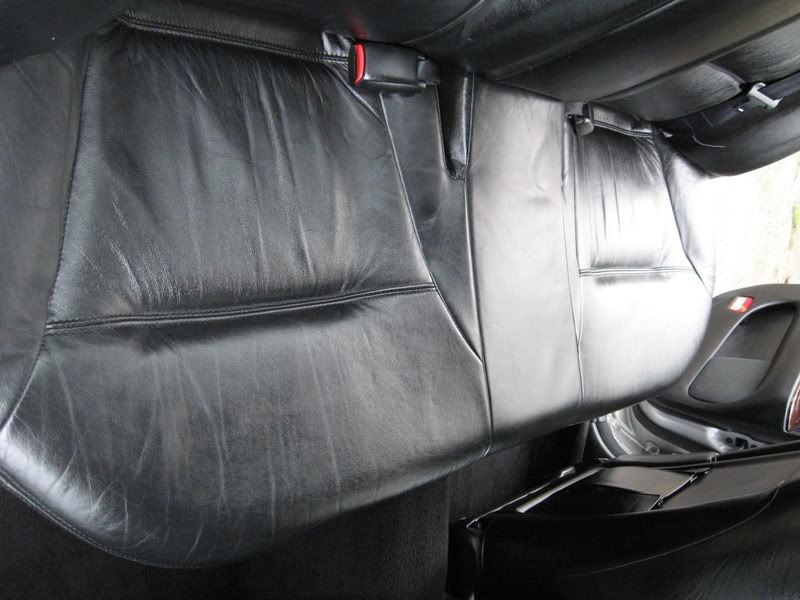

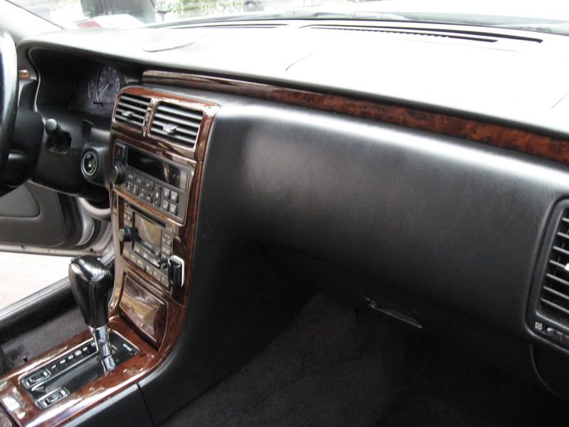

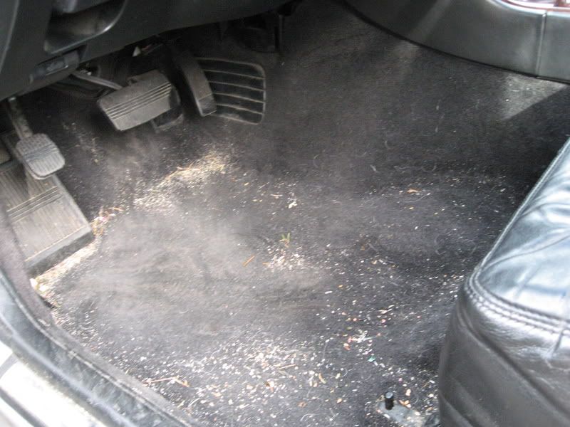

Interior:
Woolite to Clean all Interior Plastics, Vinyls, Leather
Oxiclean on the Carpets, LGCM Extractor
Lexol Leather Conditioer
Armor All Dressing

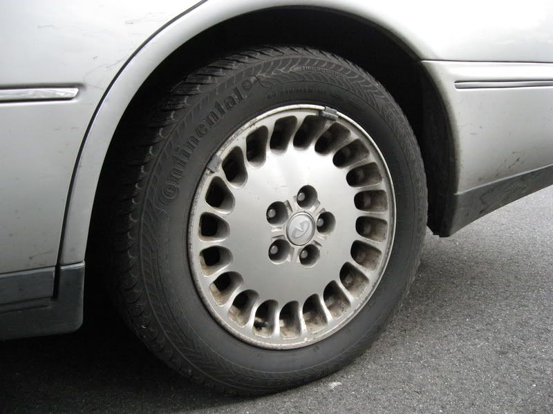

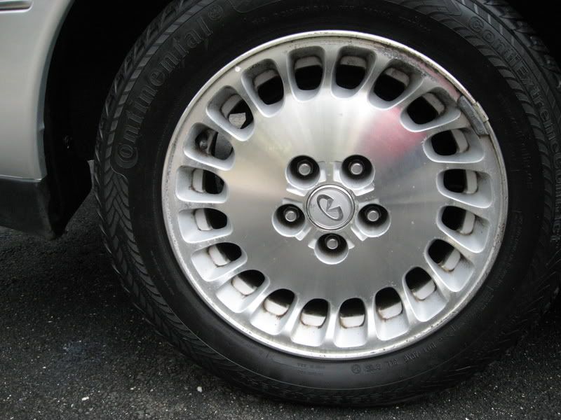

Wheels had over 1 year old brakedust on them. They were pretty much a goner, but I did what I could.
Castrol Super Clean Full Strength w/ Heavy Duty Schotbrite Pad left this:

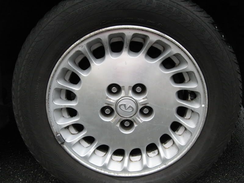

Polished with Hi-Temp Heavy Cut on an orange pad, follwed with Hi-Temp PPG, dressed with Long Haul Tire Seal:
I hate cars like that, they dont turn out perfect no matter how good you are or how much work you have put into them.
Great work none the less!
That owner was not driving a luxury car anymore. Once it gets to that condition it's like driving a dumpster on wheels. Shame too 'cus those are nice vehicles.
The interior shots look very impressive after and as much as you could do with the wheels they look great compared to how they drove up.

Any reason why you didn't reach for Dawn or mix some APC into the wash mix? Even with the big&tar presoak, I've always had good success on vehicles like that mixing in a strong degreaser. Again, great work.
G35stilez said:
Nice comeback!
I never thought of it. The TW actually did a great job removing all of that tar on the driver side, but it probably would have just been quicker do use a stronger wash.
