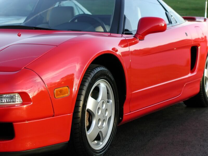

In the garage after FX-185/FX-100 step.

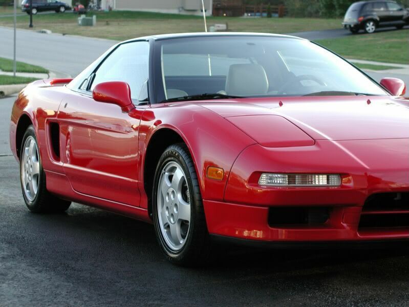

Driver Side:
Passenger Side:

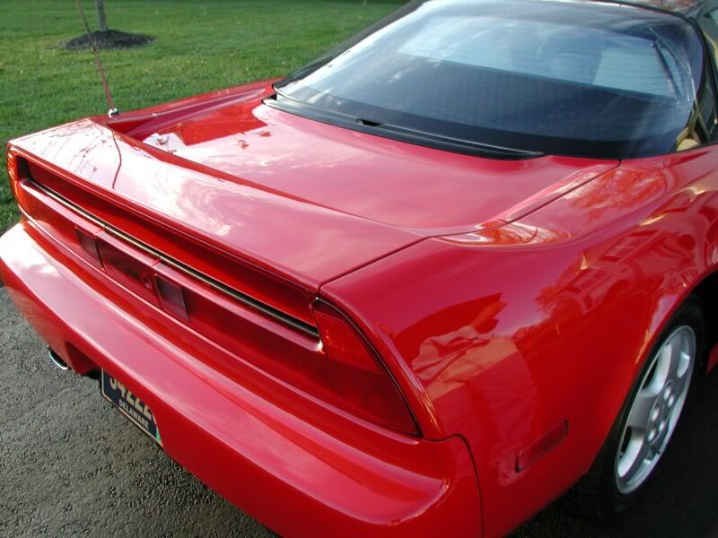

Deck Lid:

the 1st pic in the garage looks nice. this car drips with wetness and the bnb looks nice on the tires. the time you spent :yes: on the car really shows your end results, great work.
