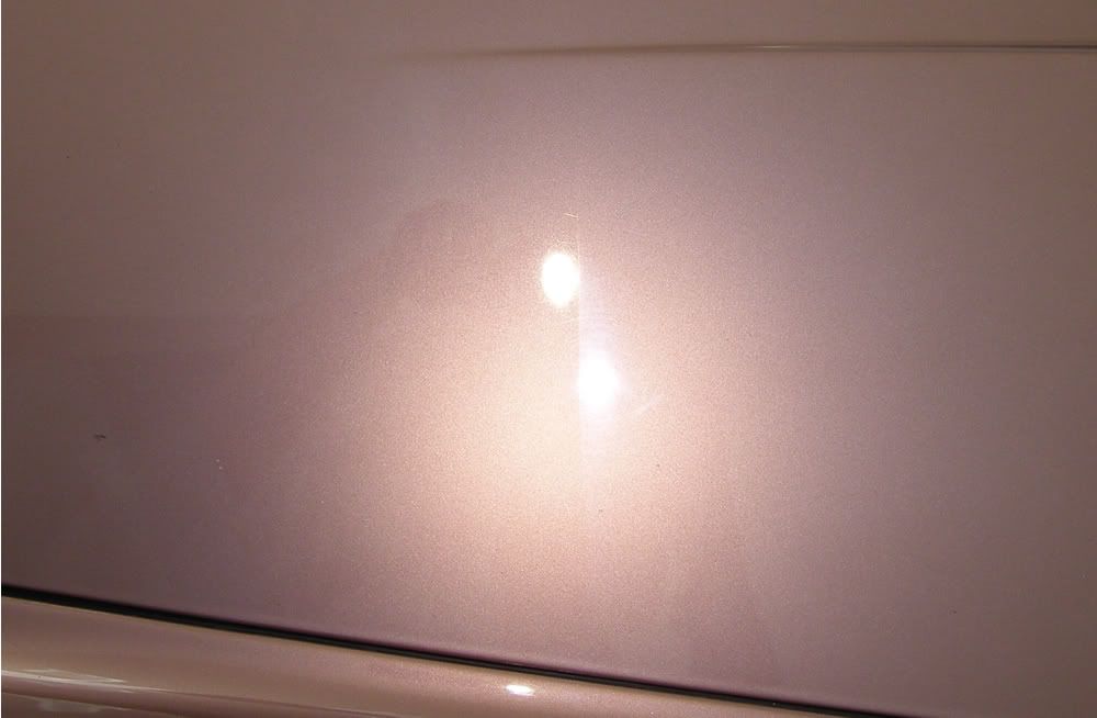

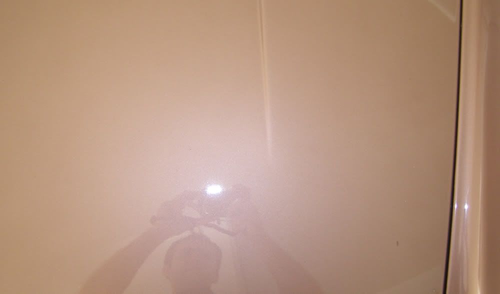

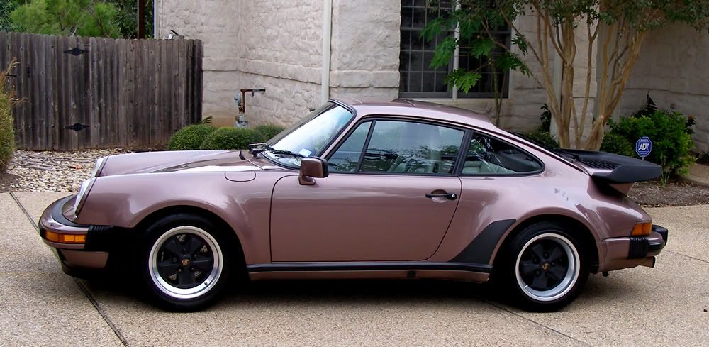

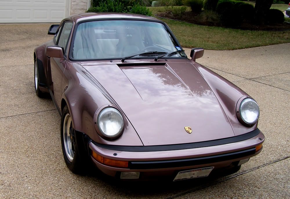

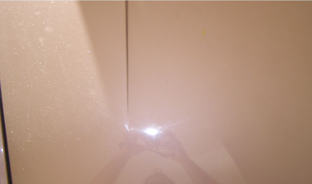

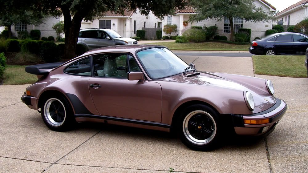

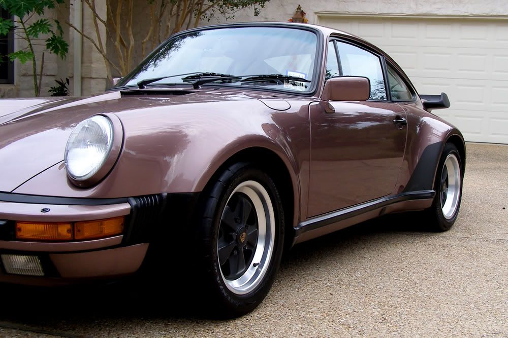

The owner decide to put the car for sale. i refresh the exterior , is not a full correction
i would say the exterior is better than what u get new from dealer :D , anyway is an `87 porsche turbo , was done some mod. to it and i will add them later.
205 on hex polish pad and DA , opti-seal and bfwd sealant as protection
test spot, and some pic before /after the hood.
Afters:
Looks great cos. What color is that? I don't think I have ever seen that color before.
How do you like the Hex pads?
