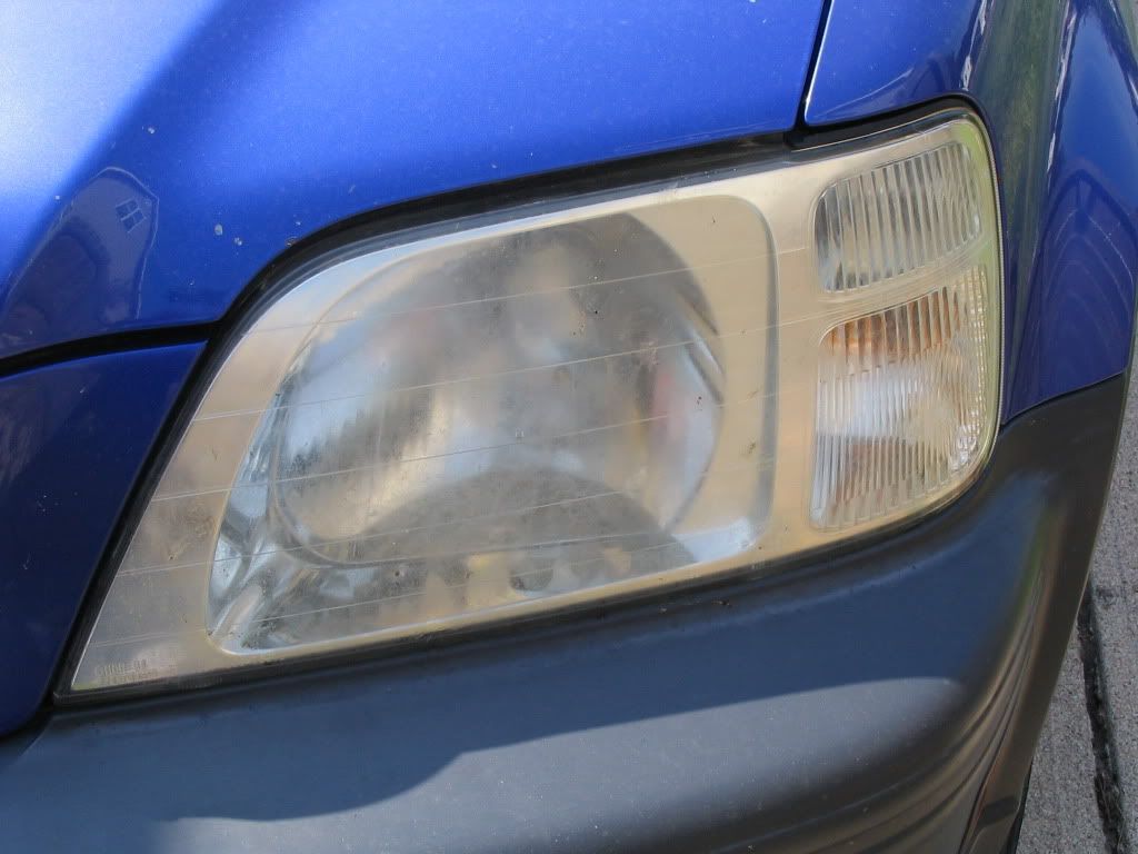

My wife's 2001 CR-V have some of those hazy, cloudy headlights.

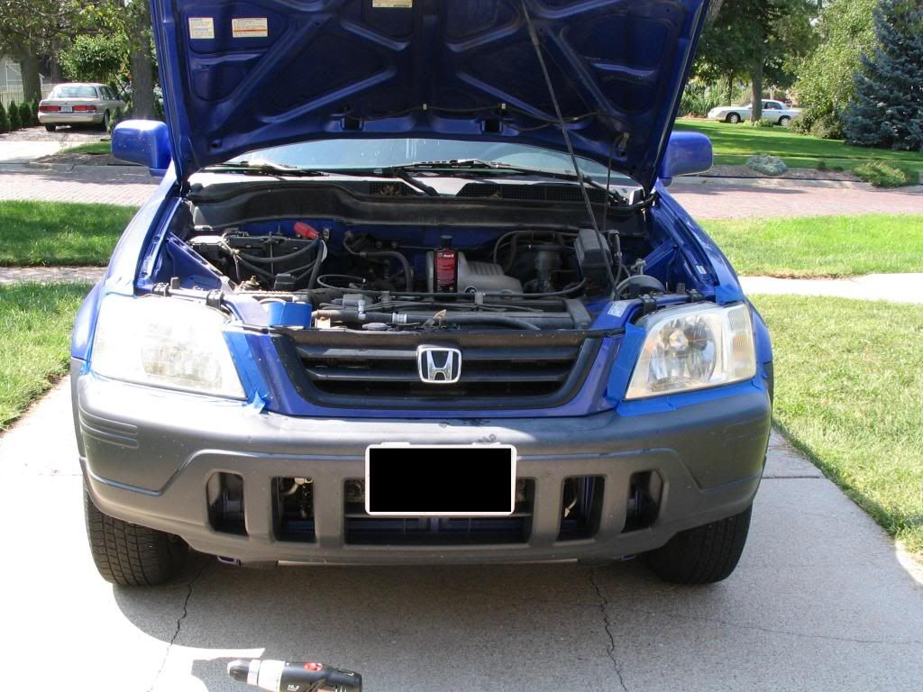

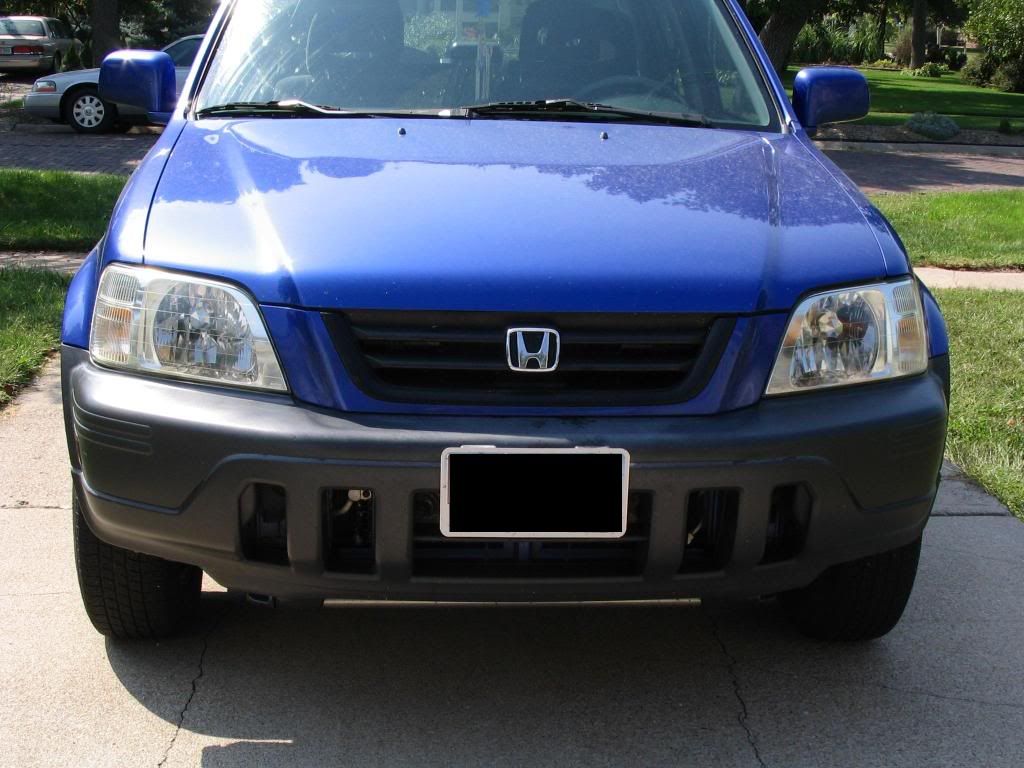

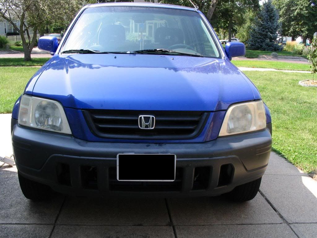

Well, I took a combination approach. I got the Meguiar's kit since it contained PlastX, a wool (?) pad (3"-4"), and a MF (can never have too many).
Here are some pics:

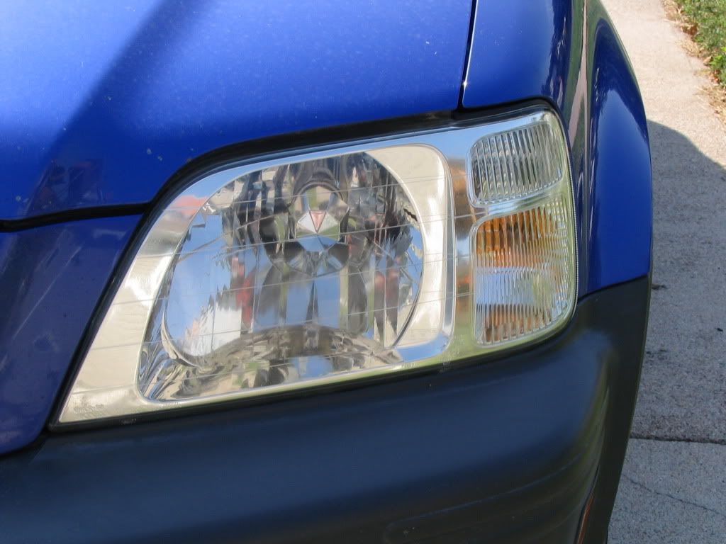

On the driver's side, I used PlastX, AIO, and Plexus.

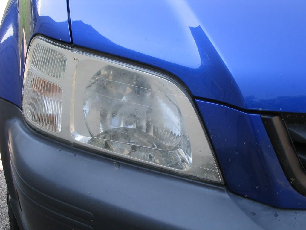

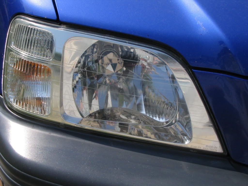

On the passenger's side, I used #80, #9, AIO, and Plexus.
IMO, the results are very similar. After seeing the results, I think something a bit coarser (such as #105 recommended above) might make a better start.
I burned through two cordless drill batteries and finally dragged out the extension cord and DeWalt corded drill. It took multiple applications of both PlastX and #80 to get most of mung off. The lights do not look brand new, but are markedly better.
