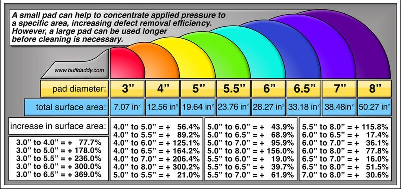

The less mass makes them more stable but technique will still play a major role.
Here's a picture by Kevin Brown on the size differences between various buffing pad sizes.
The chart shows how much bigger my 7" pads really are ... dayum ... no wonder I was working so hard.
LOL! Those 7.5" pads are relatively worthless on you PC. Yes, the Meg's pads are smaller, but you'll get MUCH better results. Did you buy the maroon cutting pads?
