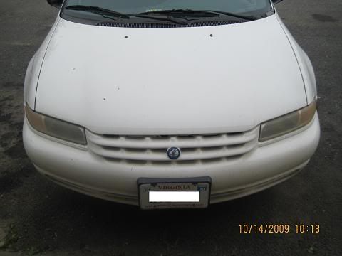

My mother in-law asked if I could do her fix her headlights. I seen the 3M Headlight Restoration at walmart. Has anyone tried it, or heard anything good?
