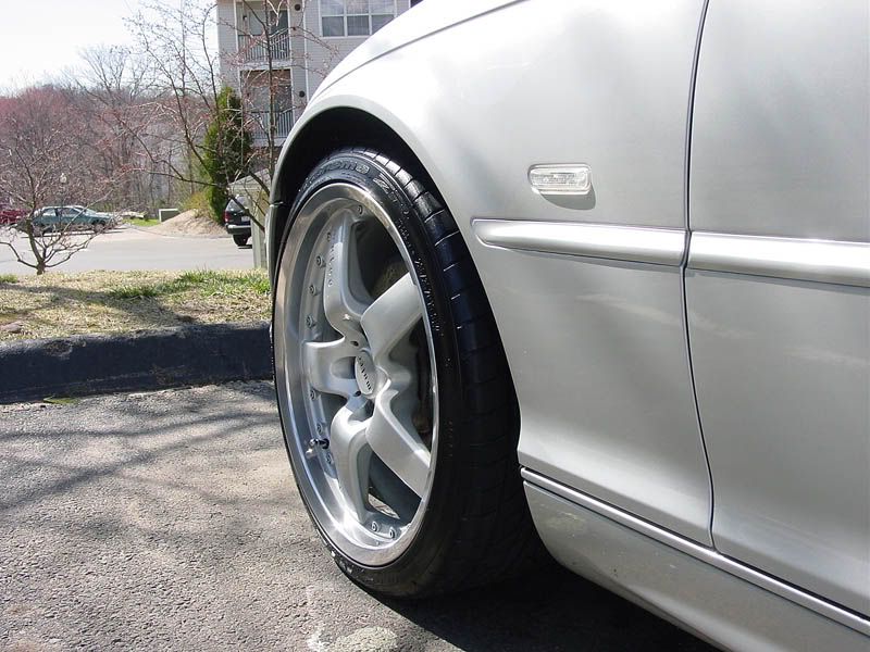

Bimmer is in nice shape but the rims are another story. They were purchased used and weren't kept up too much. They had very bad etching, staining, dulling, baked on brake dust, and some isolated clearcoat failure. All in all, they don't look terribly bad but they were definatley the hardest rims I've ever cleaned. I ended up spending a solid 90 mins on all 4 including the tires and wells. Final processes:
-QEW presoak
-APC presoak (full strength)
-TOL's Wheel Wash (found out the hard way that the lip was uncoated
-Polished by hand with Menzerna IP
-Polished by hand with Flitz (MVP of the day!)
-BnB on tires/wells
I used an assortment of brushes, wash mitts, #0000 Steel Wool, and applicators. I did my best on these things and unfortunately they did not come out 100%, but they were much better. To comment on Flitz, it's an all purpose chemical polish that polishes/cleans/protects all in 1 step with no abrasives. VERY similar to Klasse AIO for all of these attributes but MUCH stronger in cleaning ability. I was impressed.
-QEW presoak
-BnB on tires/wells
