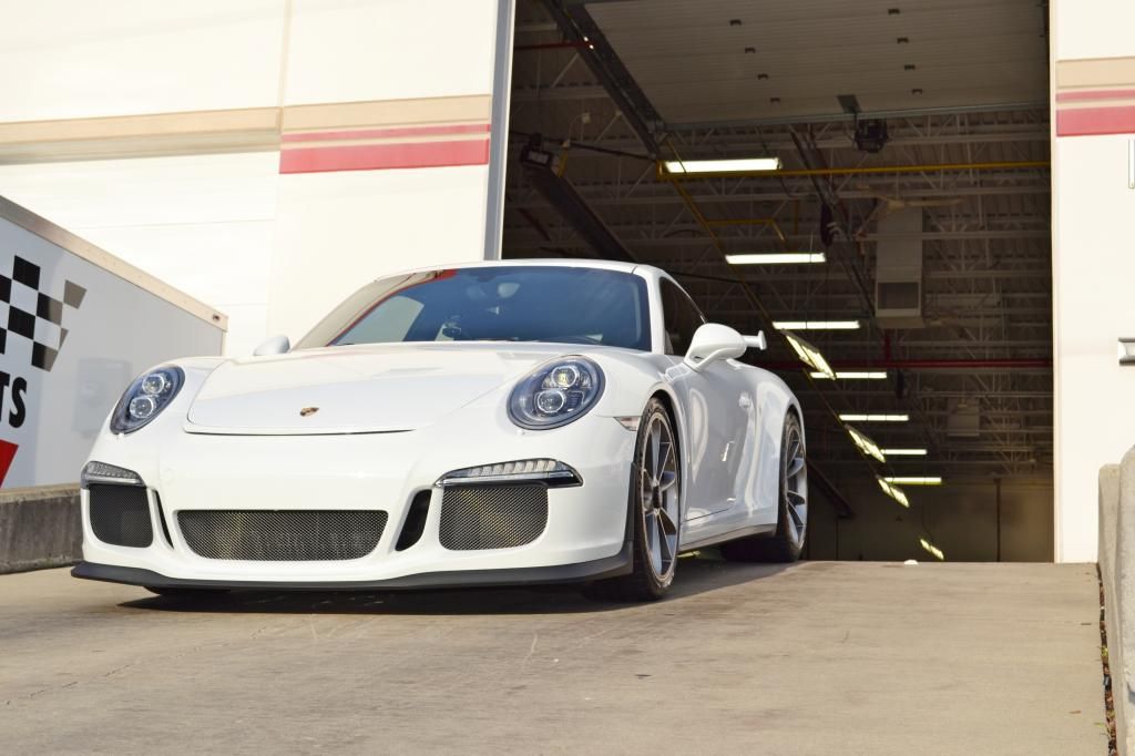

This was my first detail of the year. A good friend wanted to have his mother's car done for her birthday. We set it up for a enhancement detail, one step polish and wax with a special emphasis on the interior. This was scheduled a few weeks ago but because of the snow storm it was rescheduled.
The vehicle was dropped off for the weekend which was great so there was no rushing.

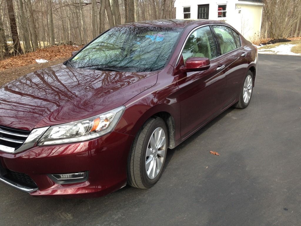

Condition upon arrival
Can't even see the barrel

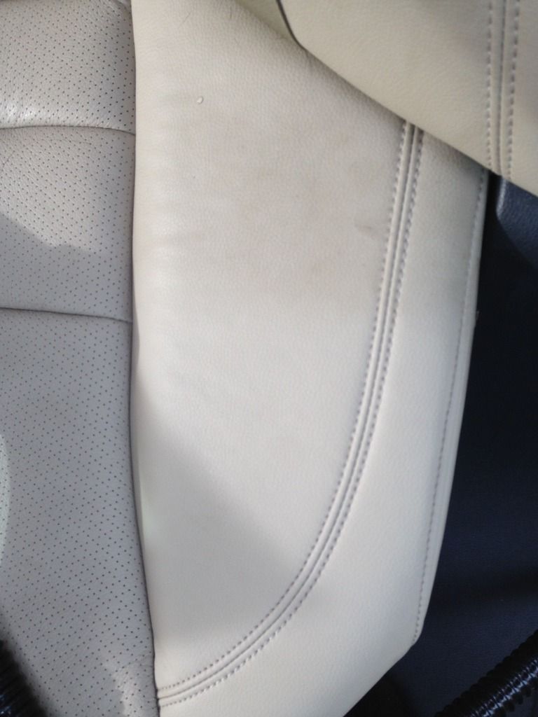

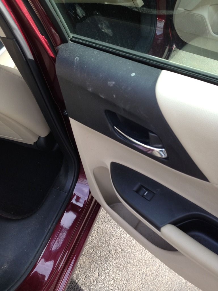

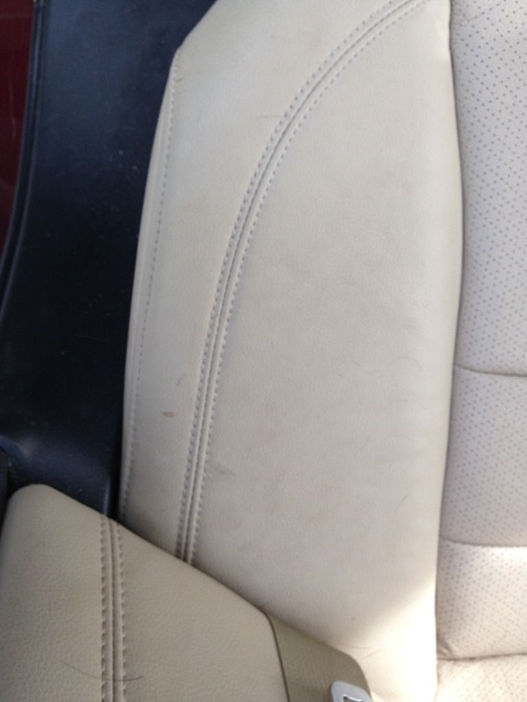

interior
light staining on leather

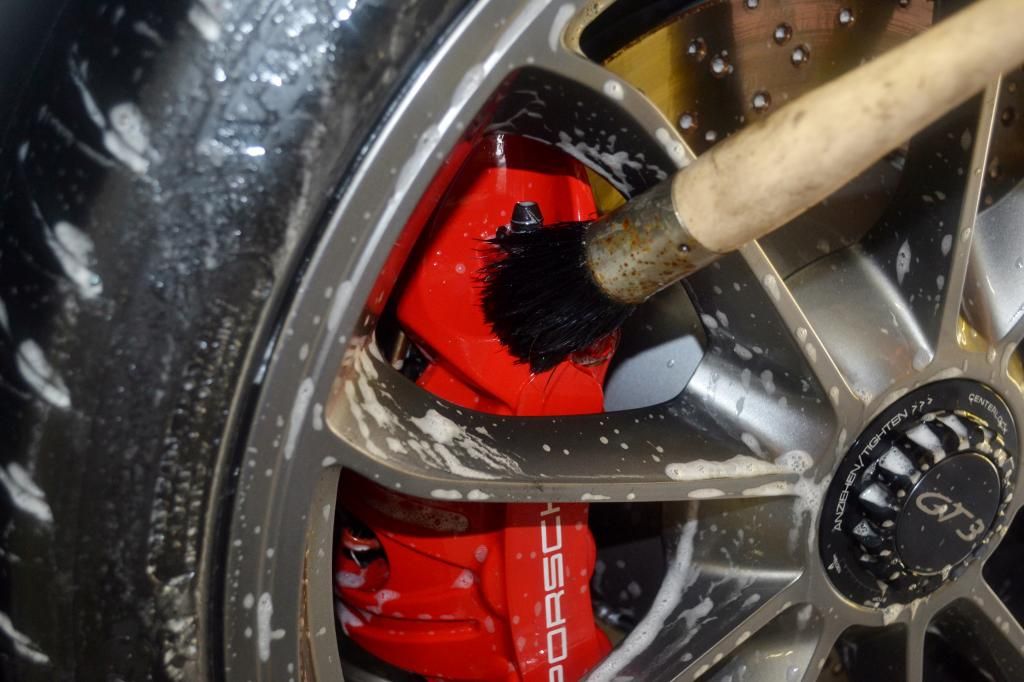

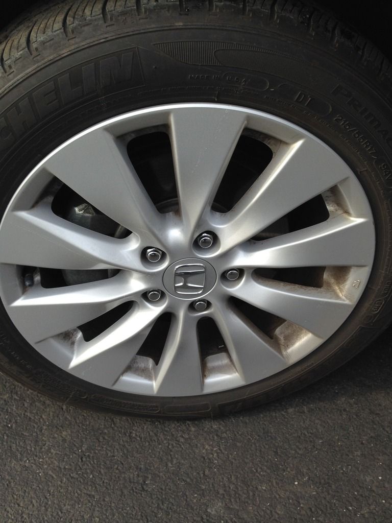

Tires and Wheels cleaned with Megs APC and Megs Degreaser, scrubbed with various brushes.
iron X to remove ferrous materials
Tires dressed with Megs hyperdressing
Wheels sealed with Menzerna Power Lock sealant

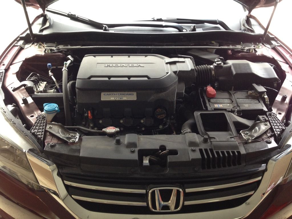

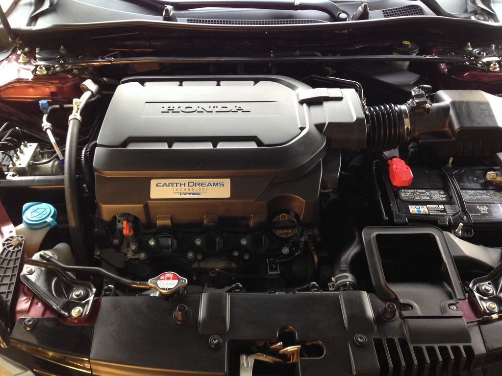

Engine
steamed to loosen dirt
Megs degreaser and agitated with various brushes
steamed and wiped down with terry towel
dressed with Megs hyperdressing to give the low shine clean look not overdressed

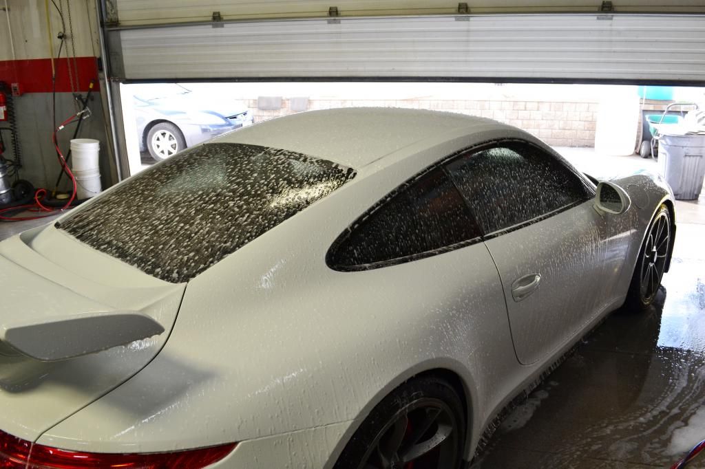

Wash
HP rinse
presoak with hyper wash and APC to loosen dirt
HP rinse
2BM

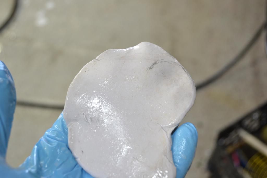

Decon
Nanoskin mitt/ fine clay with ONR lube

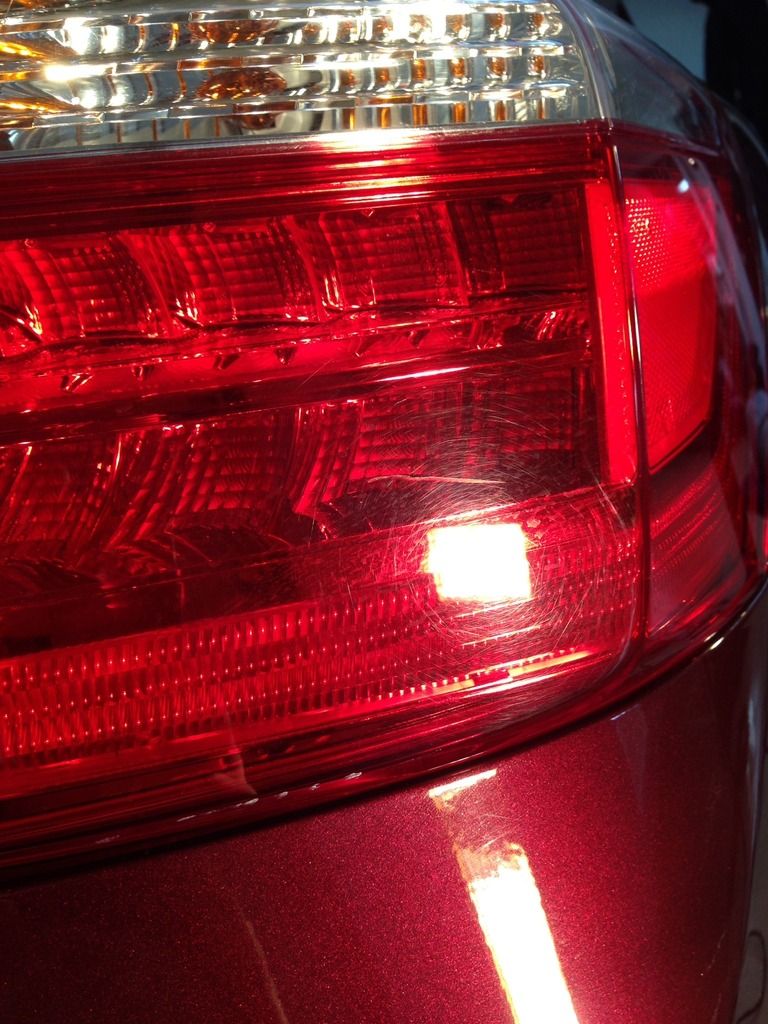

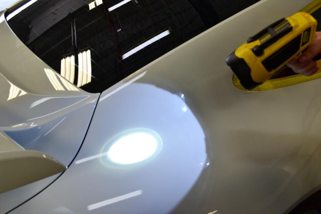

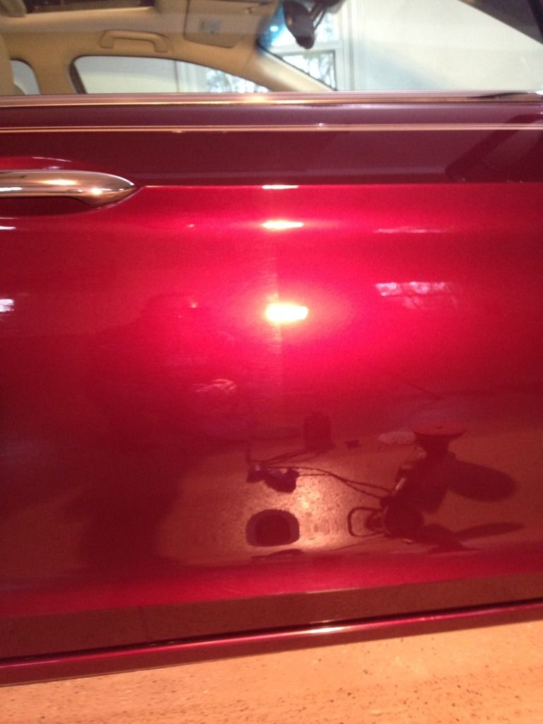

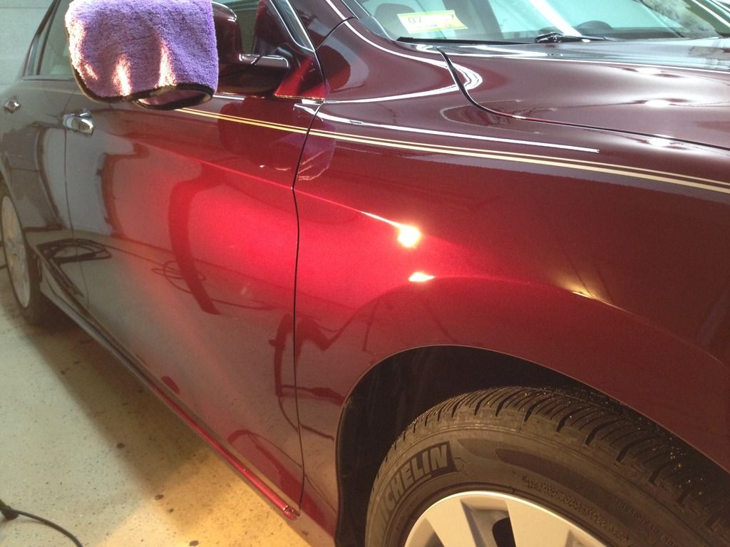

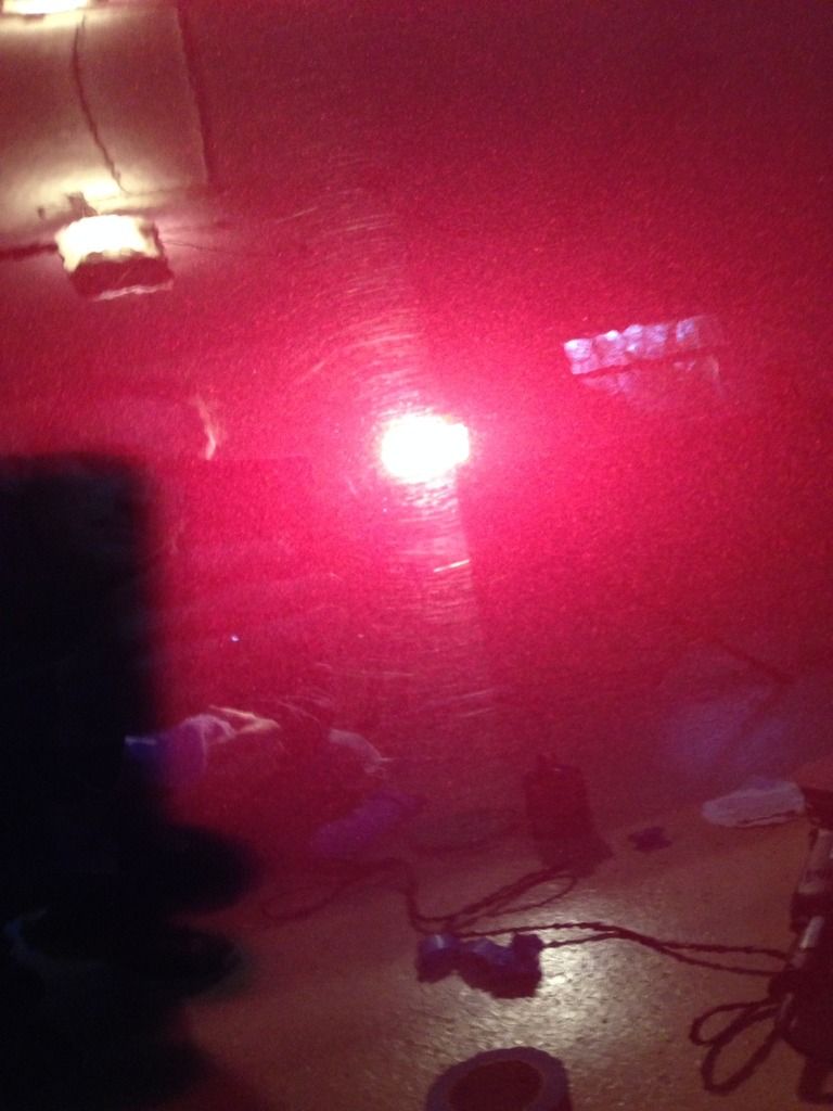

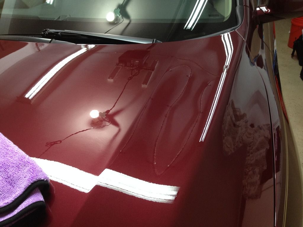

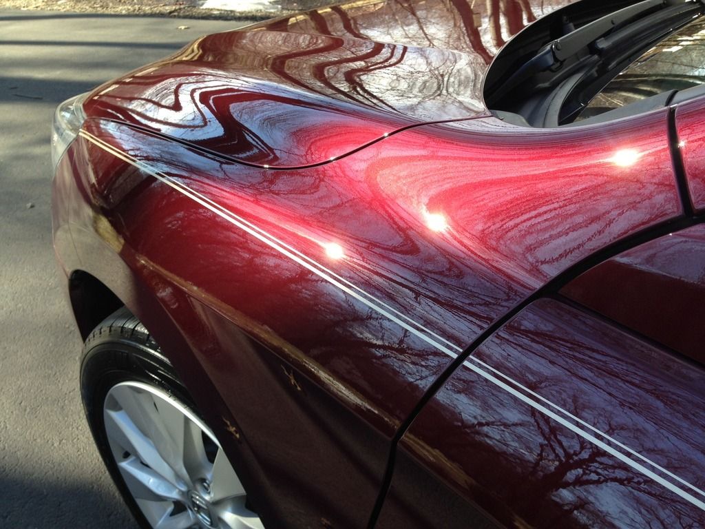

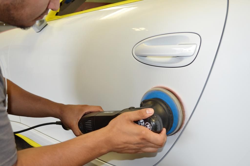

Polish
M105 for under door handles
M205
D300/105 hood to correct heavy damage
Carpro Essence
Rupes 15 II
Harbor freight DA with 3 in backing plate
PE8 1-3 in plates
Megs cutting/Finishing MF pads/Maroon buff and shine
Rupes white pad

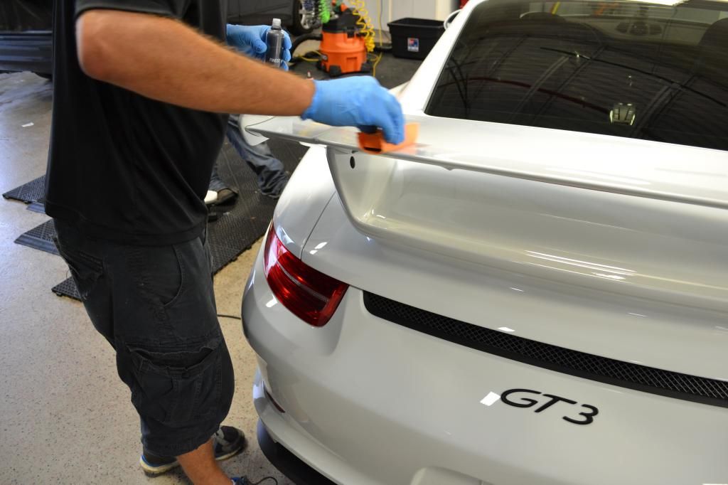

LSP
Carpro Reload 2 coats

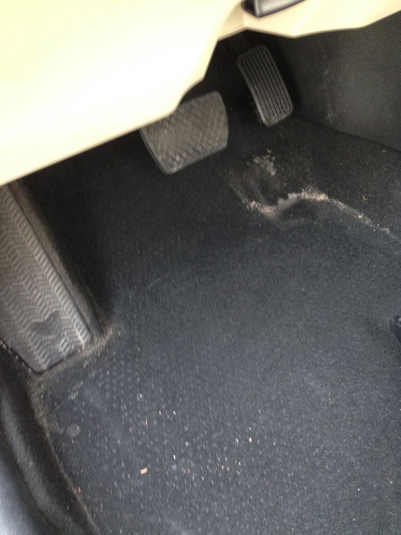

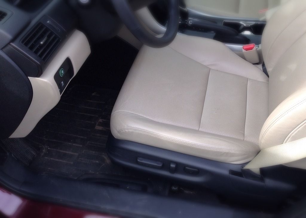

Interior
Steamed floor/plastics/leather with Mccollough 1375
Megs APC 4:1 and 10:1
water/vinegar 50/50 for crusted salt deposits
Leatherique treatment -rejuvenating oil left on over 24hrs
interior dressed with Megs QD

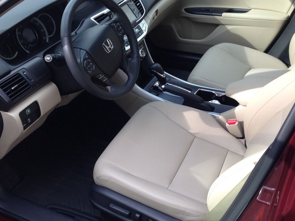

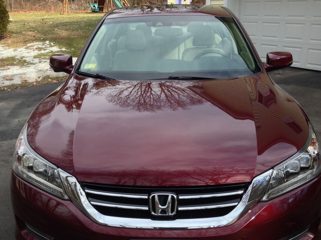

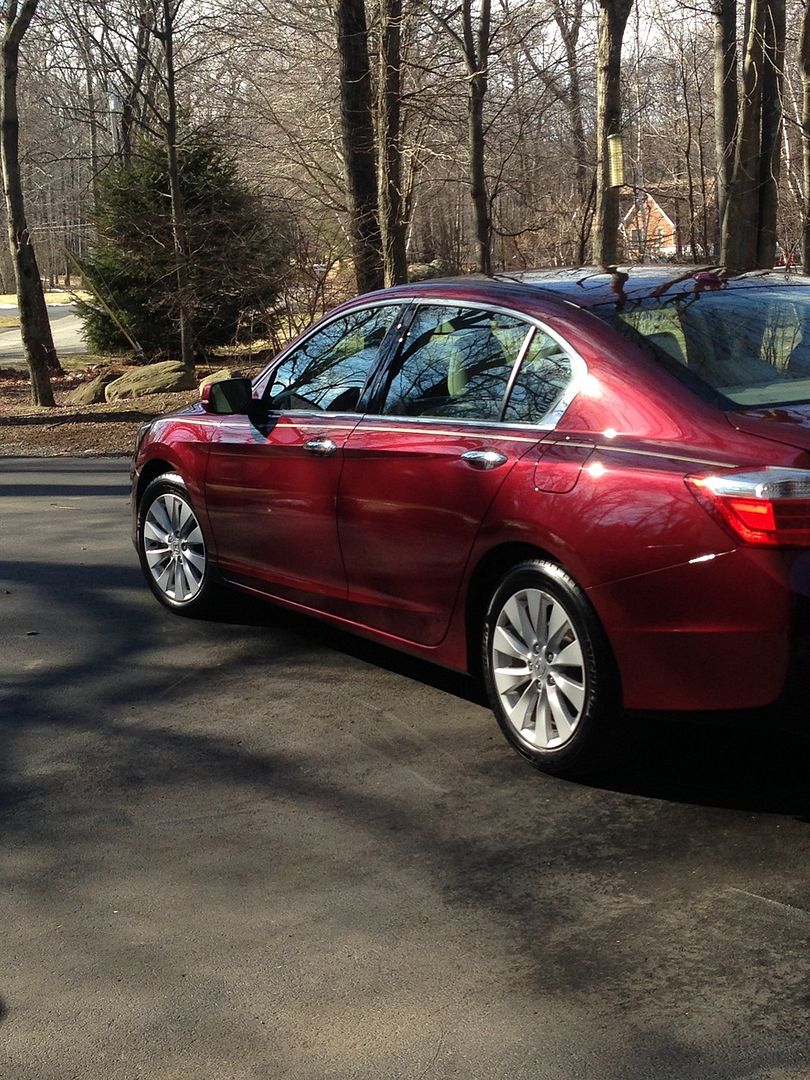

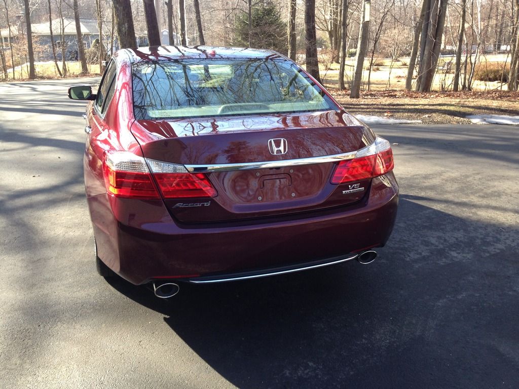

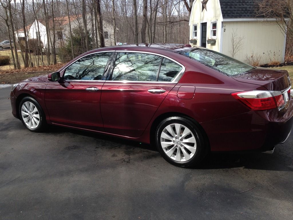

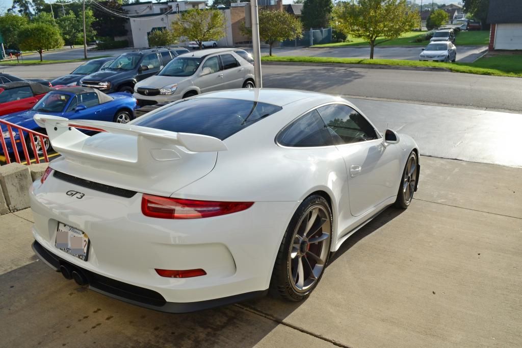

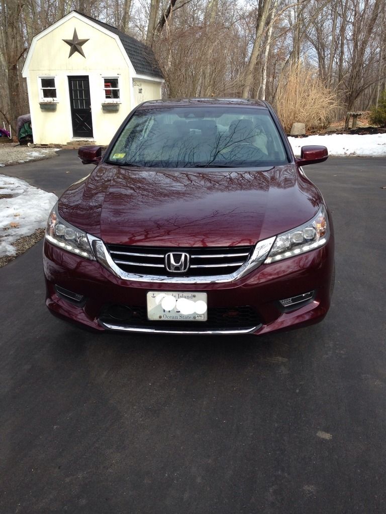

After
50/50 of steam cleaned leather before leatherique treatment
