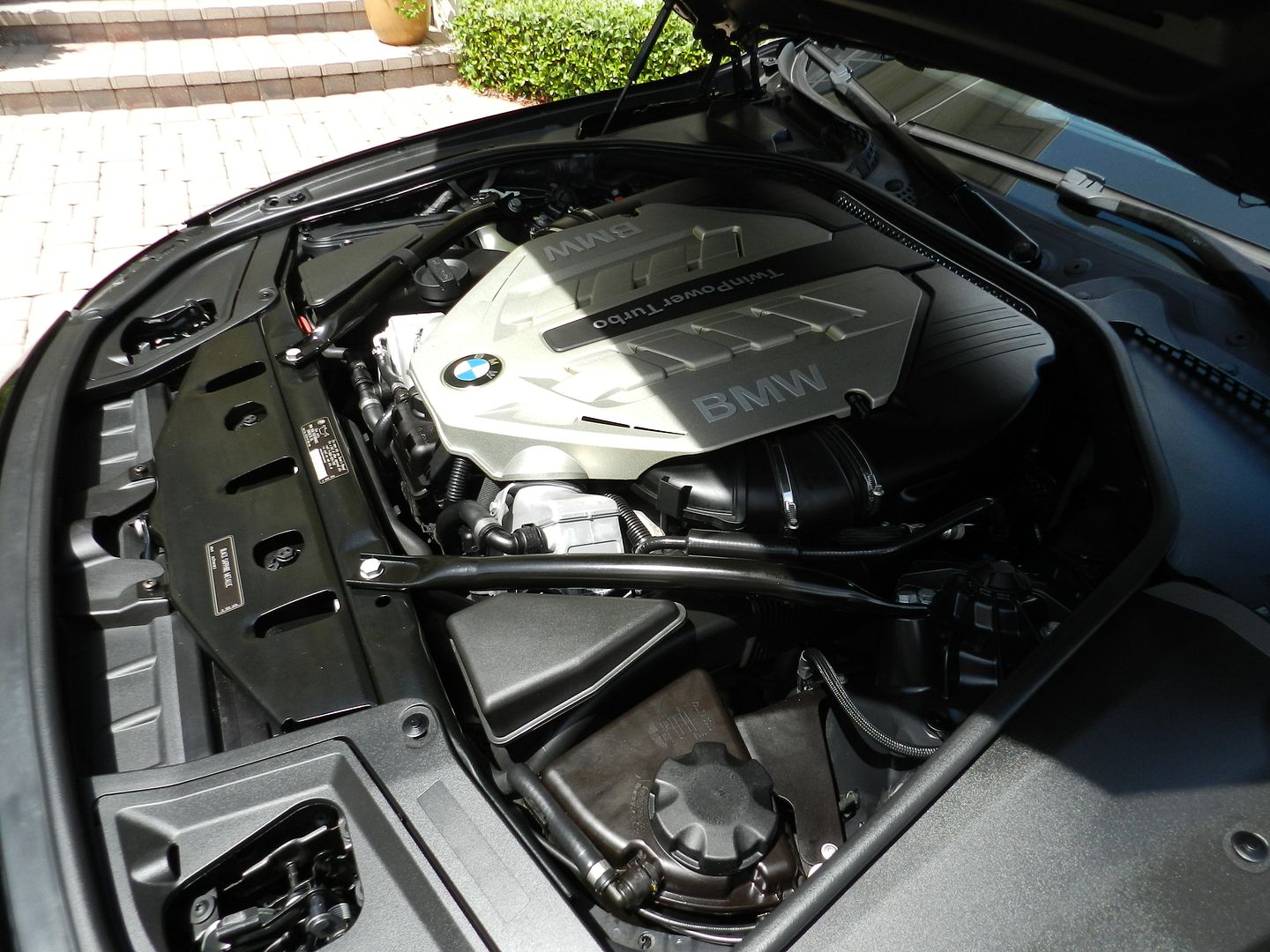

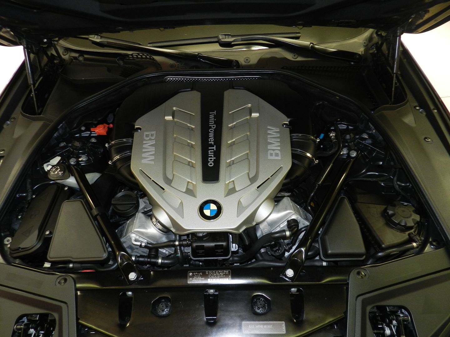

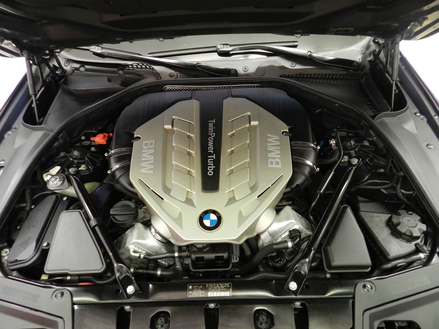

The wheels I pulled off the vehicle and cleaned with some APC. Tires were dressed with CarPro PERL @ 100%. Glass cleaned with Adam’s glass cleaner and coated with Pinnacle Black Diamond Glass Coating. The exhaust was cleaned, polished and protected with Pinnacle exhaust cleaner & brightener. The interior was first vacuumed and then cleaned with DP total interior cleaner and then coated and protected with Ultima Interior Guard Plus. The engine compartment was cleaned with some Adam’s APC and then coated and protected with Sonus Trim & MotorKote.
