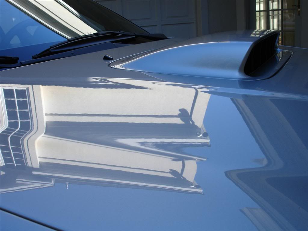

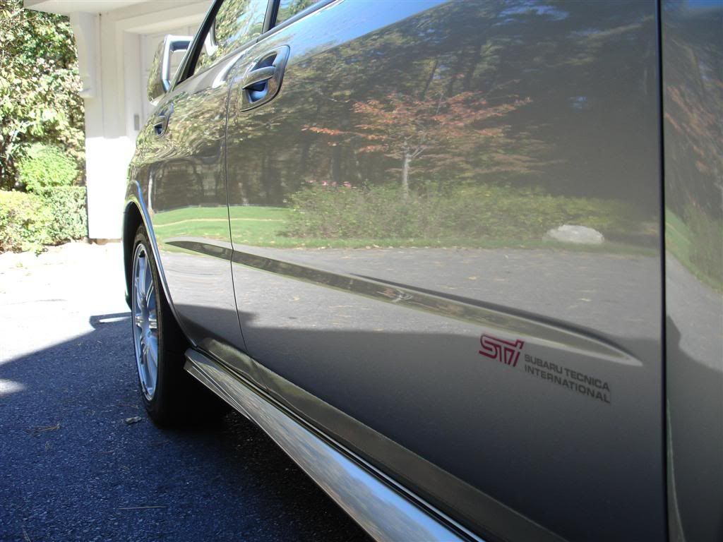

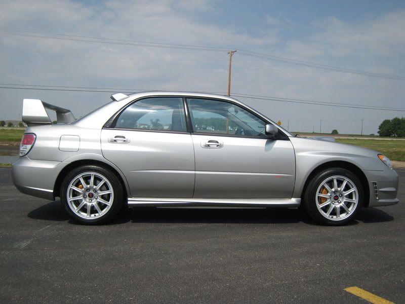

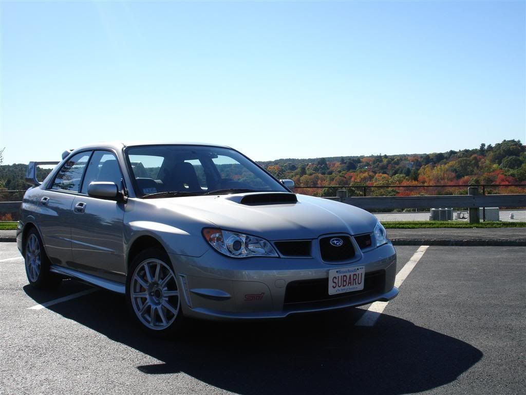

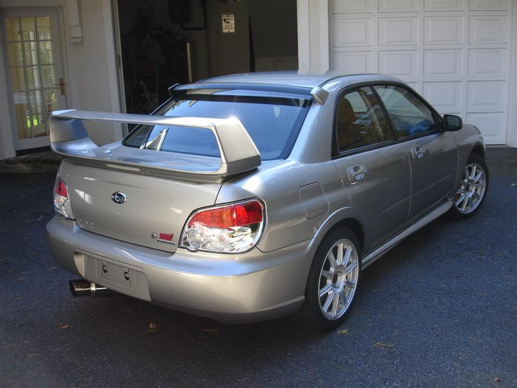

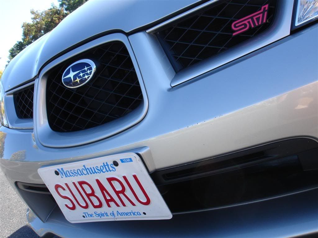

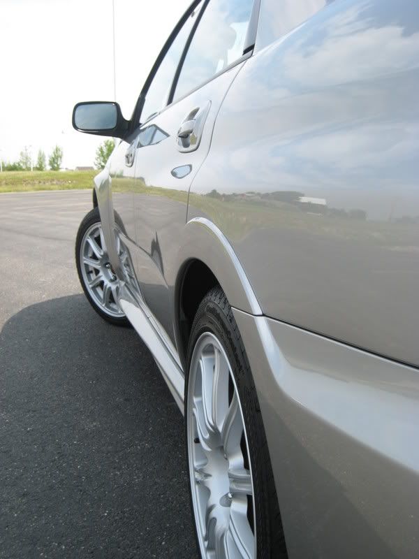

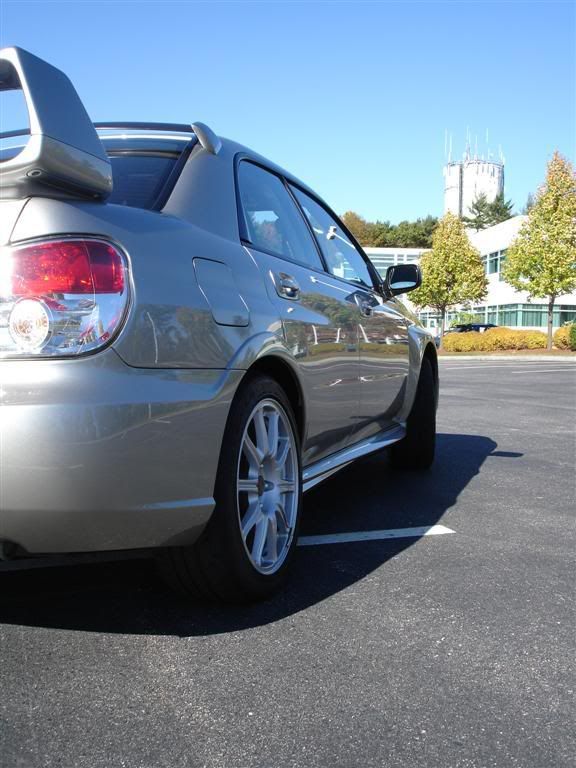

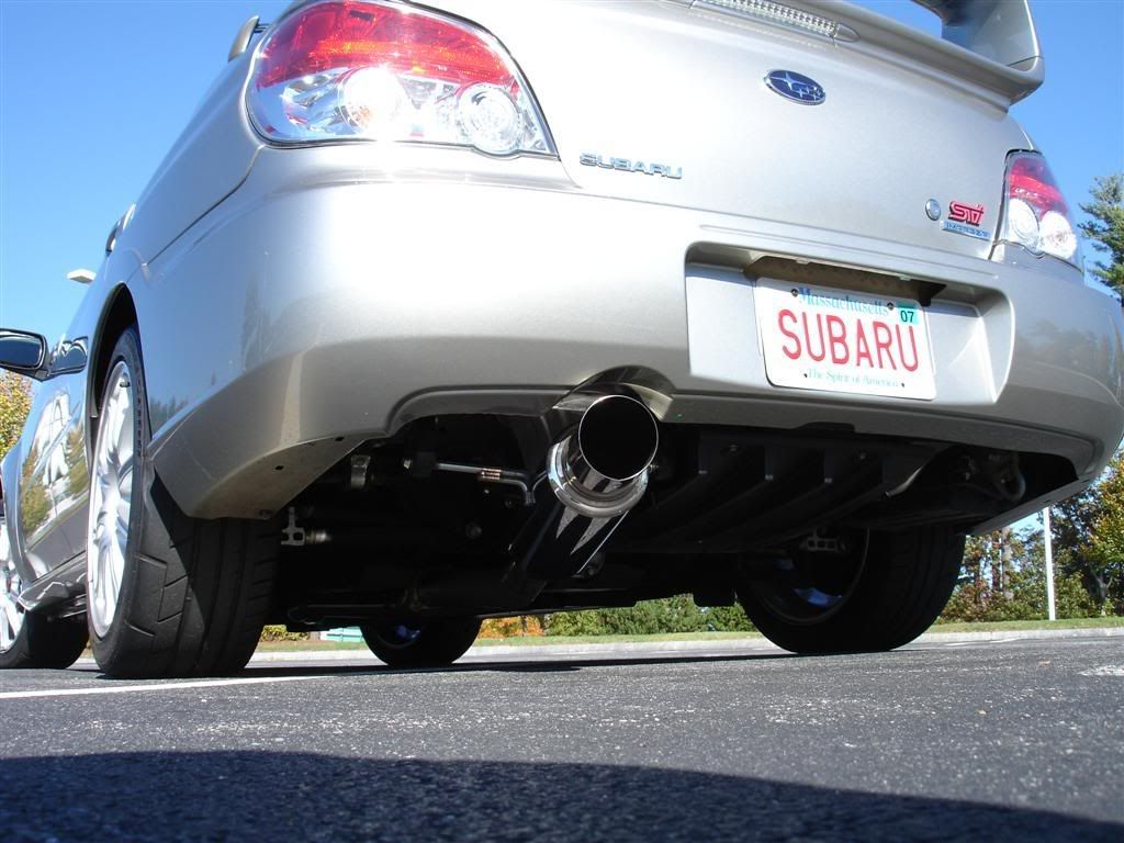

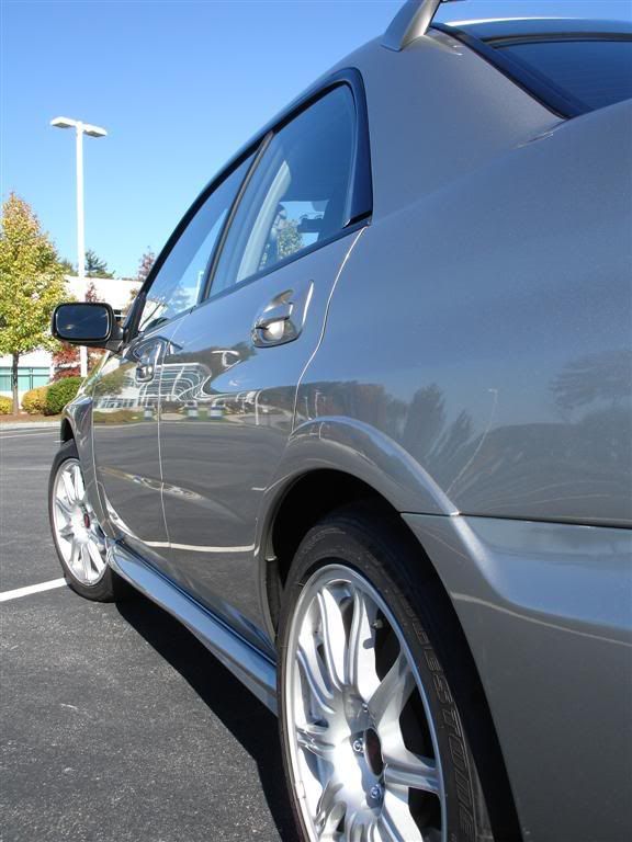

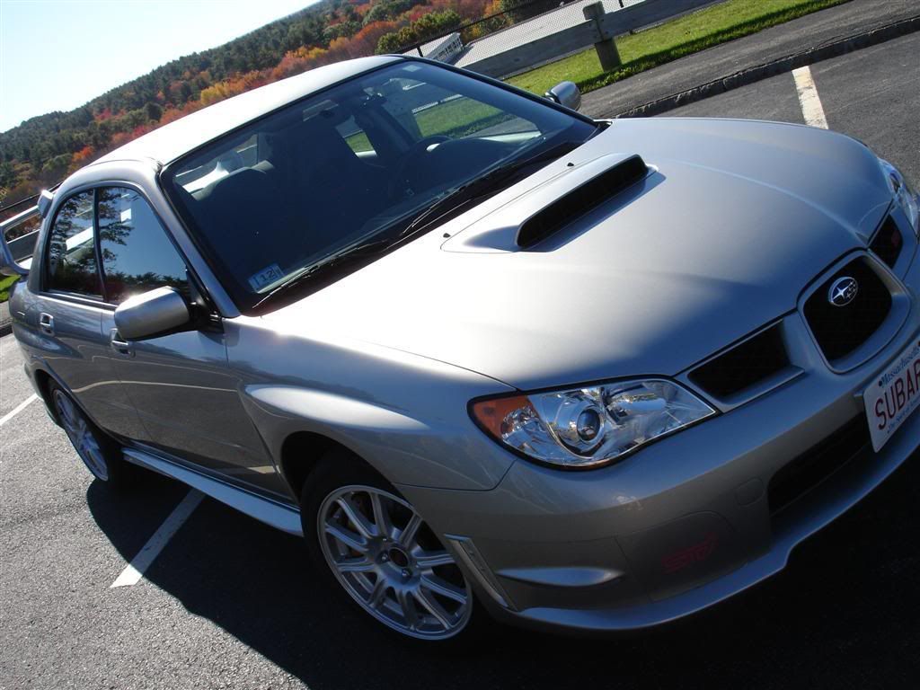

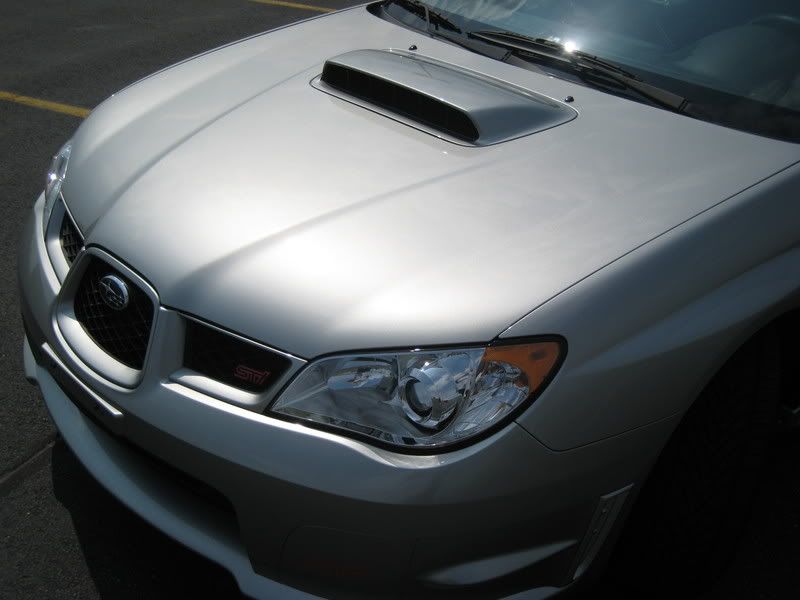

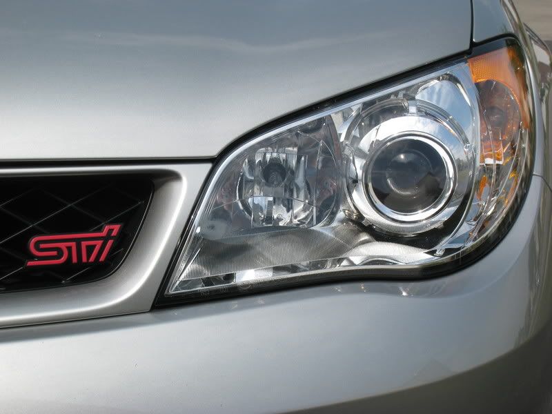

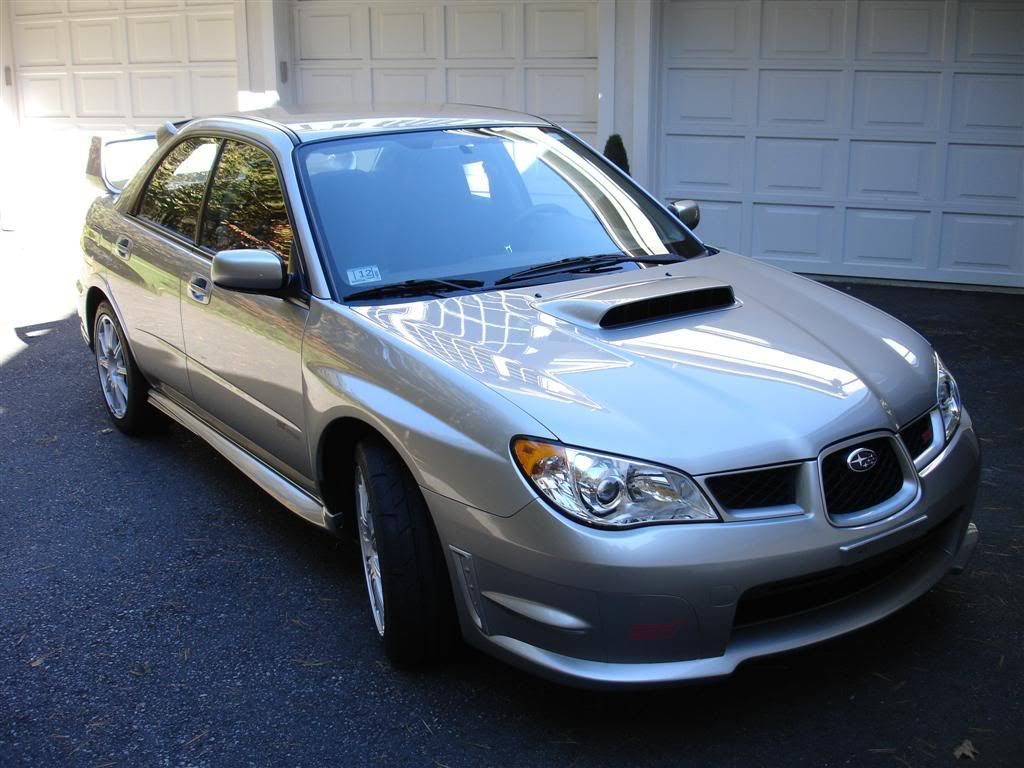

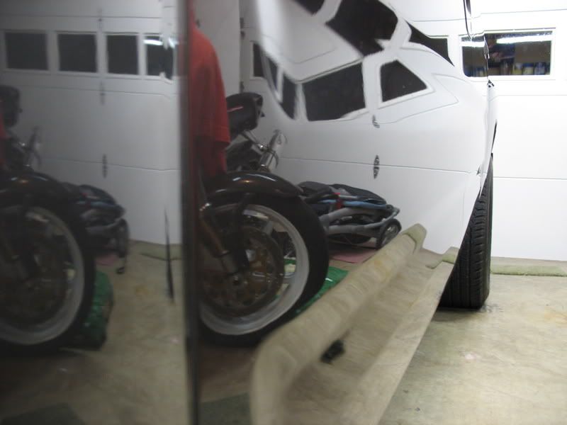

Before winter comes, and my outdoor water is shut off, I decided to do a big detail on the car, and prepare it for winter.
Steps I took:
ArmorAll Wheel Cleaner on Wheels (including inside of rims)
Washed w/ Ultima Paint Guard Wash
Claybar'd with Mothers Clay Bar Kit
Klasse All-In-One Polish/Sealent @ 4,000 RPM w/ Green Polishing Pad
P21S Carnauba Car Wax @ 3,000 RPM w/ Blue Finishing Pad
Windex'd Windows Inside/Out, and Head/Tailights
All polishing and waxing was done with my new Ultimate Detailing Machine. (UDM) The Klasse AIO was very easy to work with, and even after just polishing the car with this stuff, it felt like it had been waxed. It's also an acrylic sealant, and provides lots of protection. Add a couple layers of probably one of the best waxes on the market, and your good to go, for 5-6 months!
All in all, this took me about a good 7-8 hours. The longest part was probably claybaring the car, but it was well worth it. The entire car is incredibly smooth now.
I plan to order some RallyArmor mud flaps soon, and put those on before winter actually comes. I'm thinking the black ones, w/ Grey lettering? What do you think?
Below are some pics that I took earlier today.
I always enjoy looking at a clean suby! The rallyarmors would look nice in the color scheme you mentioned.
Nice job.

Nice winter tires :P

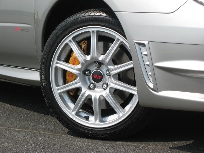

Haha, they are the stock Potenza RE070's. I use them for daily driving during the summer, and I have an autocross next weekend. Therefore, I'm leaving them on for this week. Then after I take off my competition wheels, I will put my winter setup on.
Summer:
17x8 Stock BBS Silvers
225/45/17 Bridgestone Potenza RE070's
Competiton: (track + autocross)
17x8 Hyper Black Rota G-Forces
245/40/17 Bridgestone Potenza RE01-R's
main.php
main.php
Winter:
18x8 SSR GT7-H's
225/40/18 Kumho ECSTA ASX's
main.php
main.php
looks good. If you ever get your windows tinted, i'd advise to not use windex.
and lol, nice plate, surprised no one had that plate already
What machine are you using to hit 4000
Looks nice in the pic's for sure, why use kaio@4k??? what machine????
Why p21s @3k WOW!!!!! I really don't get it, but if it worked as the pictures illustrate, great.
Ahhh you mean opm's I gottcha. I was gonna say with soft subie paint maybe all you need is a wax to correct that stuff :lol. when you say rpm's that refers to rotary buffing not dual action, it's cool though minor typo. Good job it looks very slick.

LOL I thought the same thing when I read 4000 RPM lol...
4000 OPM is a big difference from RPM, great job though, P21s always looks amazing on Silver!
