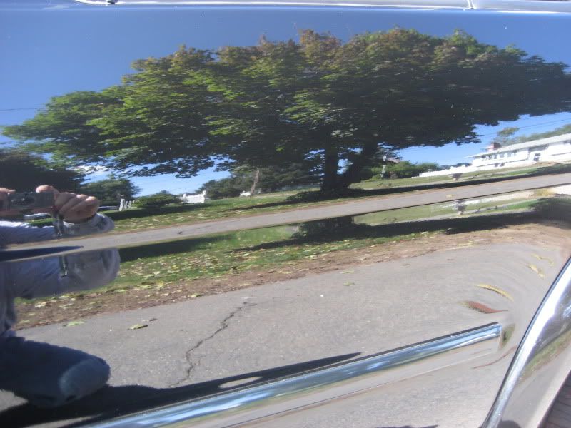

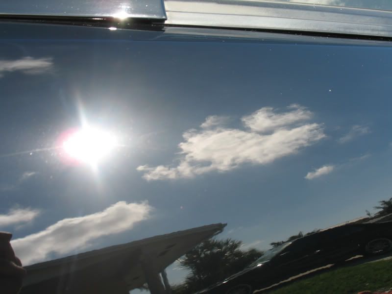

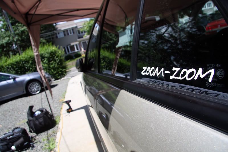

My girlfriends car. She was bugging me to do it for quite some time and with her on vaca with an aunt I had no excuse not to clean it up for her while she is gone.
Car had been in for service on friday so they kindly washed it. I didnt mind since I had planned on doing the car anyways.
I didnt take many before pictures because its tan, and hard to see the imperfections. But there were some spots of what looked like rusted car (dirty looking) that came right off and was very happy for them not being stubborn.
Poorboys SSR 2.5 on an orange pad Flex speed 6 the throttled down to 4-5 for a couple passes. PC with 4 inch pad for tight spots.
Collinite 845 as a sealant till I wash it with her this weekend and i'll top with a layer of JW AJT.
Pictures speak volumes.
Thanks for looking. It was a surprisingly easy car to do.
