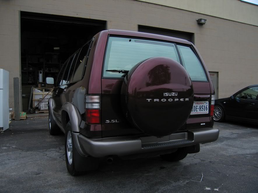

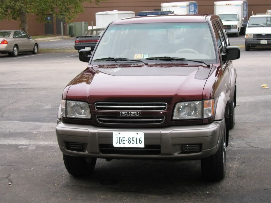

exterior
blue coral wash
Meg's agressive clay - good stuff!! (bought 10 on e bay)
OP on green/orange LC pad (rotary/pc)
*** green pad pc speed 6 got rid of everything on vertical panels.
FK1 #2180/pc/blue propel pad/speed 3
FK1's #216/pc/gray lc pad/speed 2
FK1's tire shine
PwC on roof/lower panels

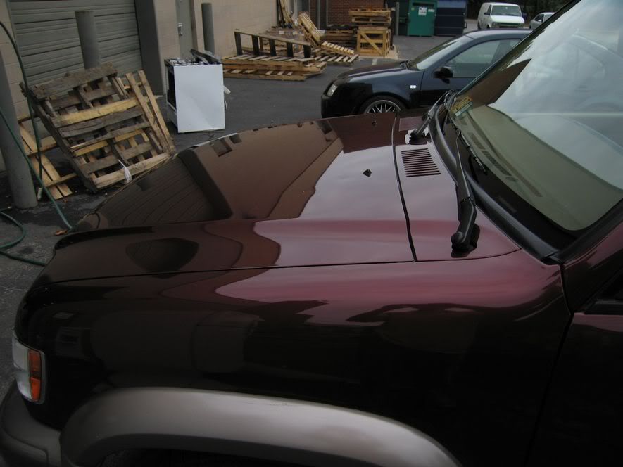

exterior
blue coral wash
FK1's tire shine
