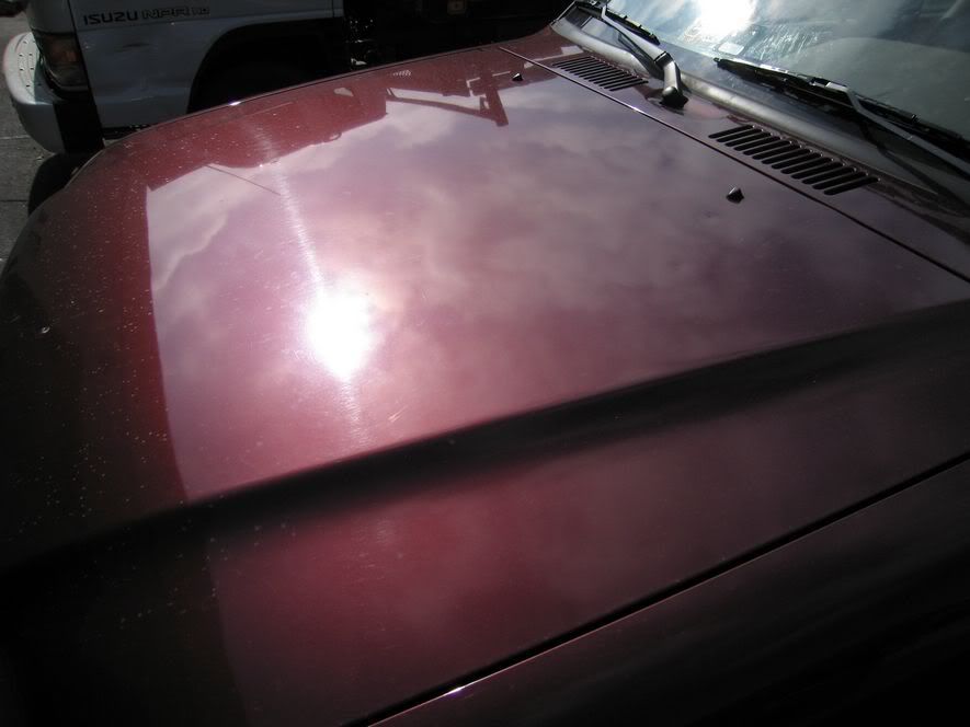

2002 Isuzu
Thomas Dekany
interior
vacuum
FK1's APC 10:1 (excellent stuff)
NL to protect
before picture doesn't show anything so here is an after.
exterior
blue coral wash
Meg's agressive clay - good stuff!! (bought 10 on e bay) :D
OP on green/orange LC pad (rotary/pc)
*** green pad pc speed 6 got rid of everything on vertical panels.
FK1 #2180/pc/blue propel pad/speed 3
FK1's #216/pc/gray lc pad/speed 2
FK1's tire shine
PwC on roof/lower panels
before
Nice! Interior looks factory new and the paint looks really deep and wet! :drool:

Truck looks great! The paint looks incredible!
