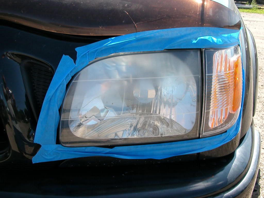

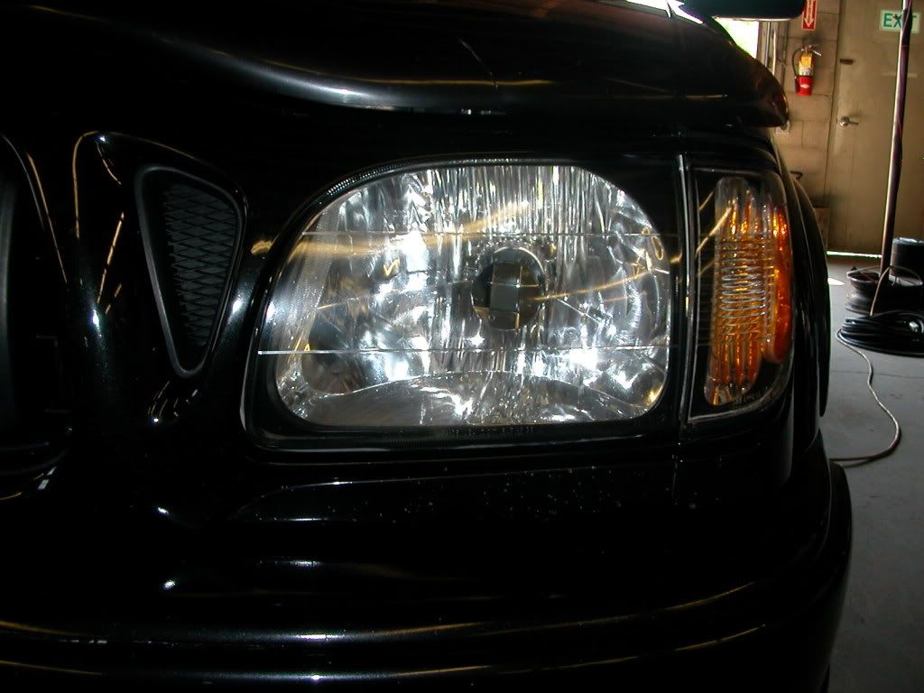

This customer wanted his oxidized headlights restored. (same customer who wanted engine detailed).
He said, "I want a quick job, I'm selling the car! I don't want to spend much money."
PROCESS:
Taped around headlights
Wetsanded with 800, then 1000
Polished with PC/M105/4" orange pad
Polished with PC/M205/4" orange pad
One coat of Blackfire Wet Diamond
Done
20 minutes - 50 dollars
BEFORE:
AFTER:
