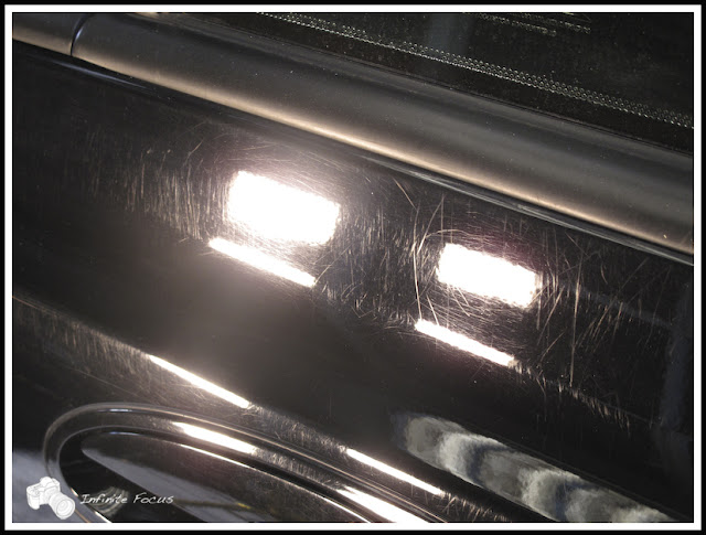

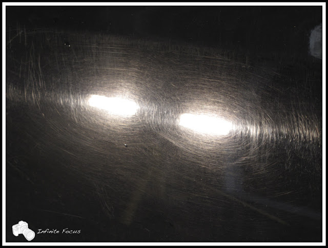

Before:
Now for the fun before shots! :o :

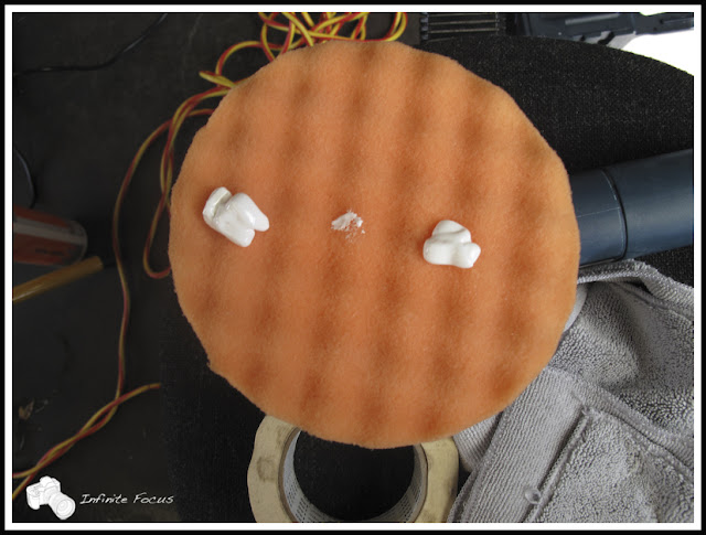

FI Orange (light cutting pad) and Menz 203s ready for a 50/50 test:

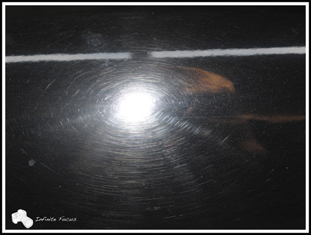

After two passes:
One pass:
Quick wipedown with FI GPC (General Purpose Cleaner, similar to APC) and a Jamb MF:
I was not able to achieve a perfect finish with the materials I had, in the time I had. Which I am very unhappy about, as it seems like a waste of time to me to spend ~12-14 hours on the paintwork alone, only to finish with an imperfect surface, but I've learnt from my mistake and will be better prepared from now on.

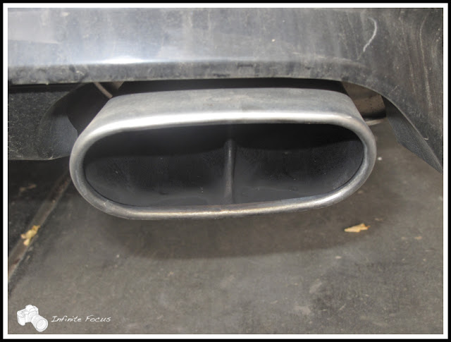

Exhausts Before:
After cleaning with PWC (Power Wheel Cleaner, non acidic) and polishing with Autosol, the inside of the exhaust are painted matt black:

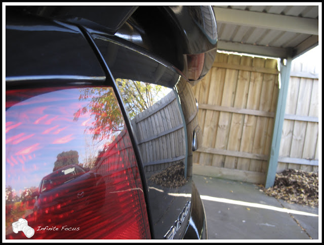

Boot Before, you can see evidence of a car wash broom here:
After:

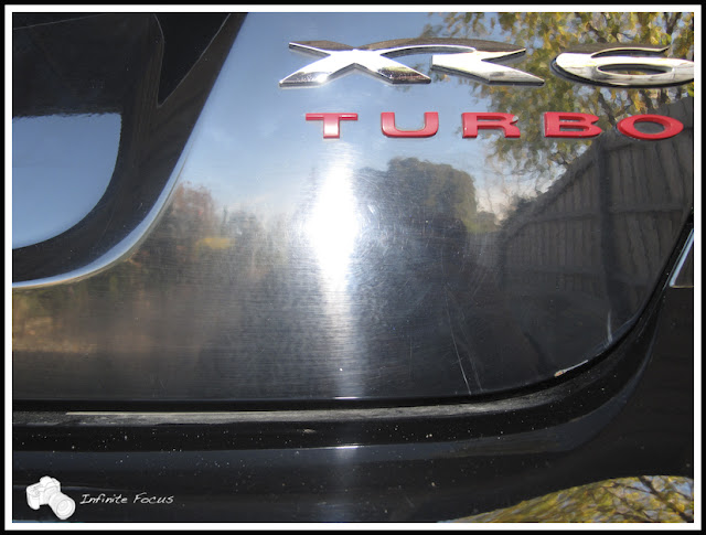

Various Befores:
Starting to look black again:

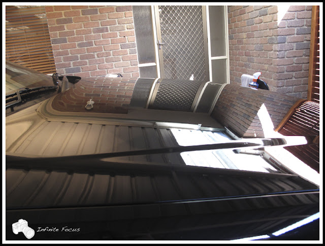

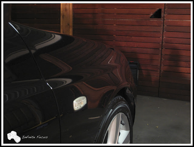

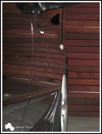

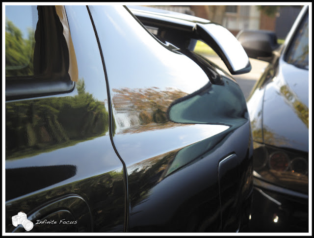

Completed, 3 passes of Menz 203s on FI Orange, single pass of Menz 106ff on FI Black (Final Finishing), LSP is FI SEAL:
What was left in the worst areas:
The worst panel on the car, before/after:

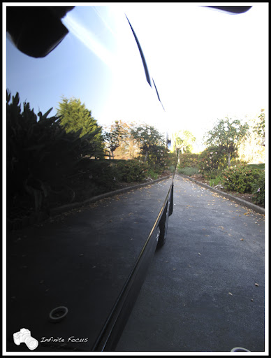

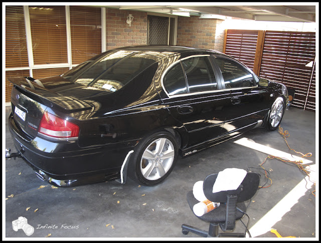

Here are the daylight final shots, I don't have any direct sunlight photos, as there was no direct sunlight :p
