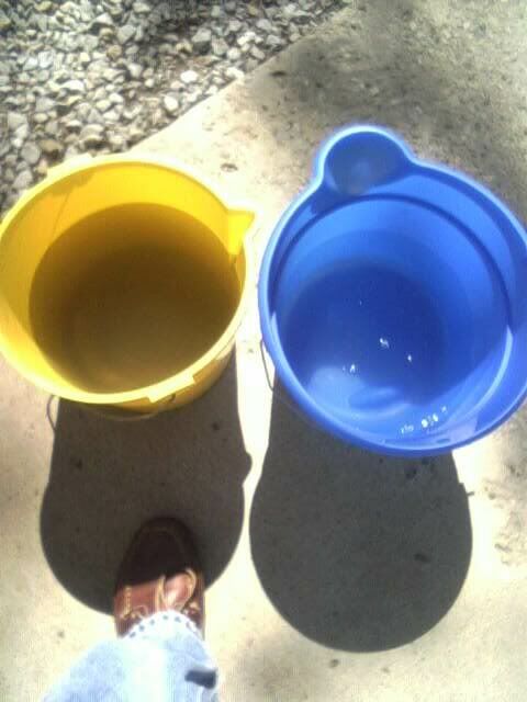

On one of the boards last summer I posted a thread about this subject... here is a pic of the 2 buckets after the suds died down...
The wash bucket remained clean. Without the rinse bucket you'd be recycling the dirty water back onto the car.

David - Don't know how much marring/swirling will be saved by using the 2 bucket method, however, I think you'd agree the cleaner the wash water the better, eh? Especially considering it adds less than a minute to the whole auto wash cycle.
A better preventive measure, IMO, is to rinse the wash mitts exceptionally thoroughly before and after using. Getting small bits of sand, dirt, etc, lodged in the mitt will do damage right now.
