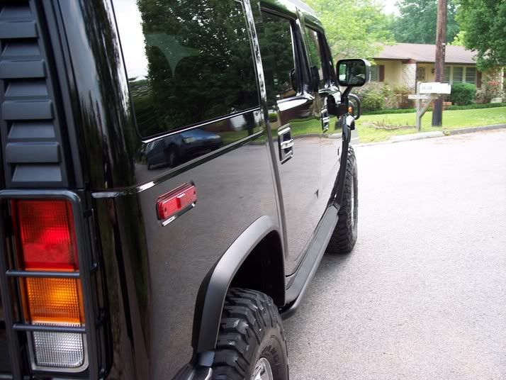

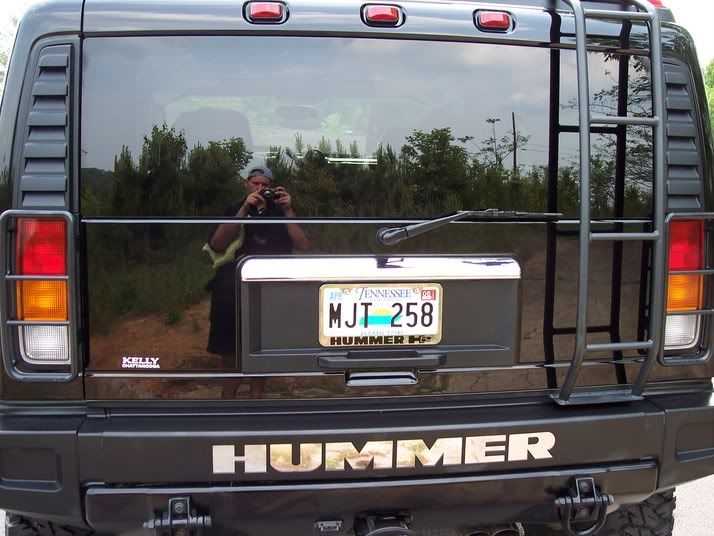

Well it wasn't as bad I as I thought it would be today. I was lucky that the car was in pretty decent shape except for the engine. The interior was in good condition so I didn't have to spend a lot of time there. The outside had some pretty bad scratches from being off road. It did take all day pretty much to do the car and I thought the engine by far was the hardest part to clean as well as the roof due the big tire rack.
Most of the exterior was done with SSR 2.5 and a rotary w/ 6" pad, I did use a wool pad on one of the major scratches on the side. I followed up with #21 w/ PC and finishing pad and AIO on the roof. Tires and wells with Hyper Dressing. Windows with NXT. Trim with Trim Detailer (really like this stuff). Also much of the chrome and lights with Magic Wand (great product) works wonders on bumpers and bugs.
:xyxthumbs Looks great . How long did it take ? Who makes that Trim Detailer ? Does it leave any greasy residue behind . It has a nice look to it .
I have 2 ladders that are about 4 ft in length and about 3 ft high that I got a Home Depot, they are like mini platforms and work great on these types of cars.
It took me about 7 hours.
The Trim Detailer is Meguiar's, no greasy residue nice shine to it.
