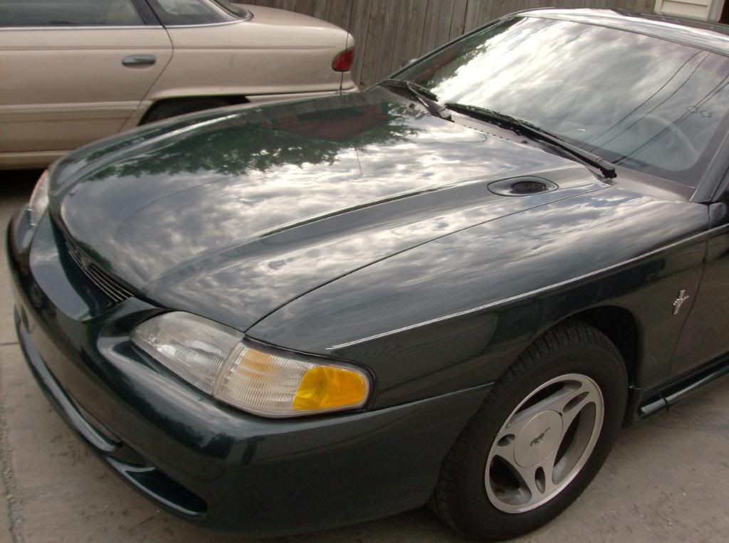

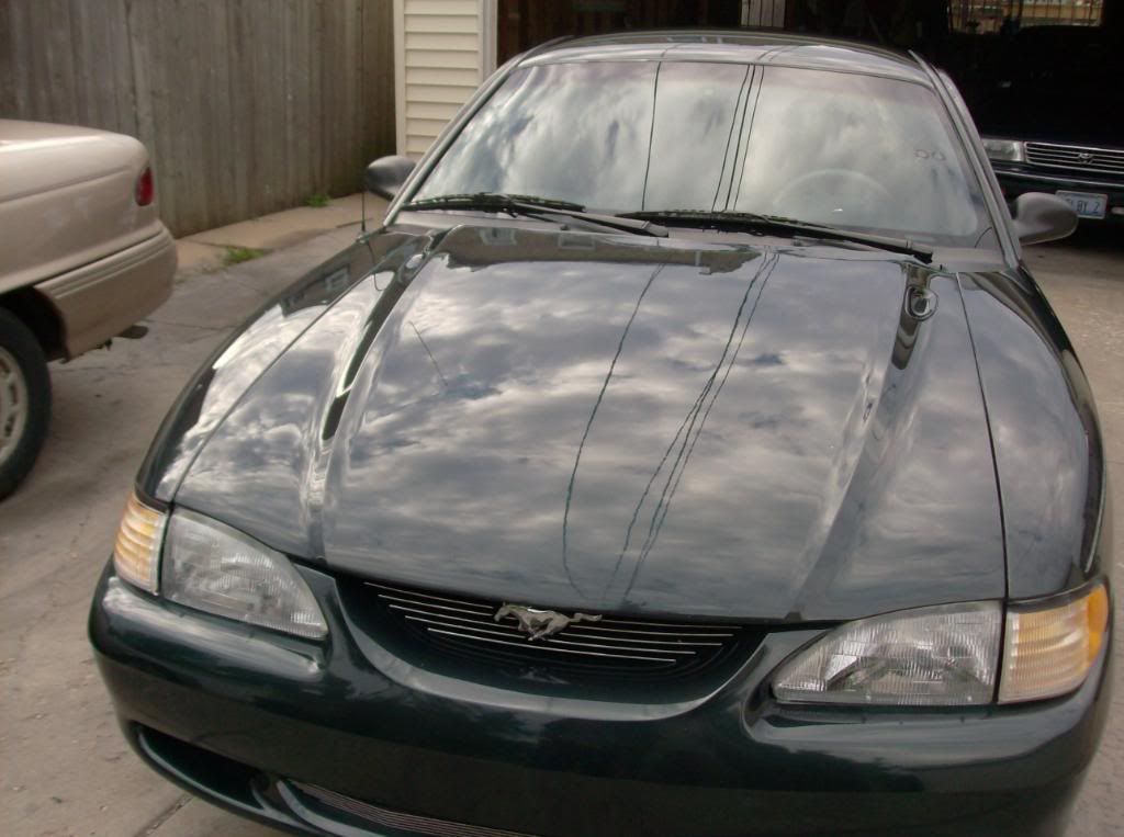

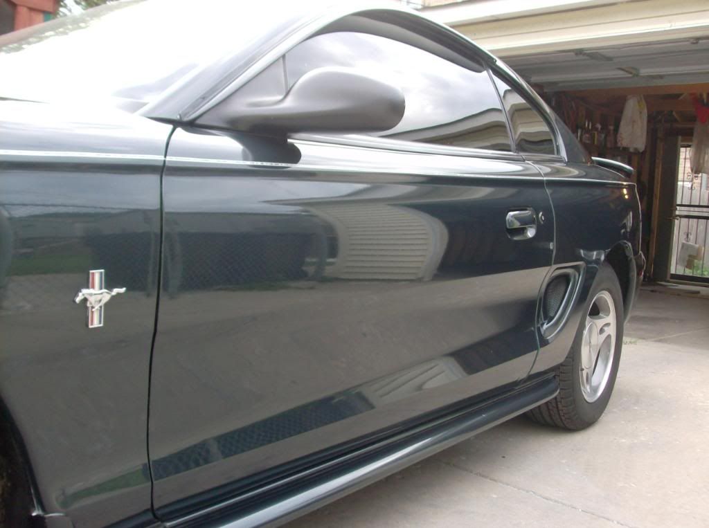

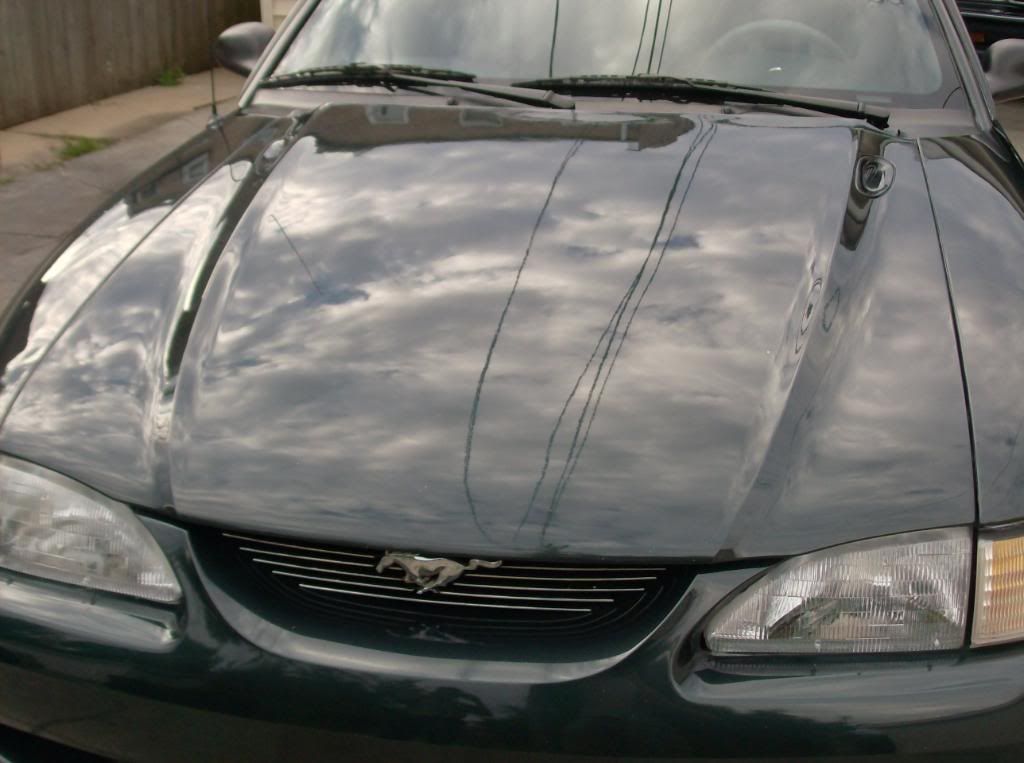

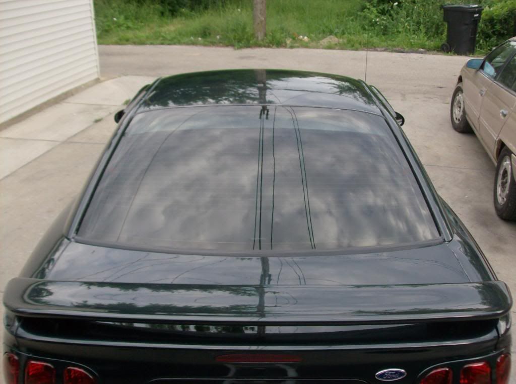

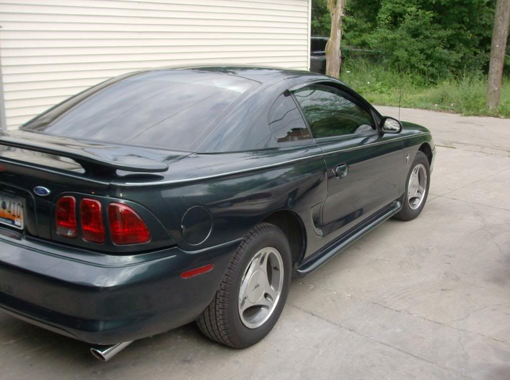

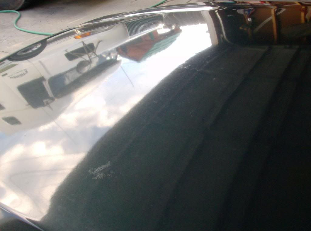

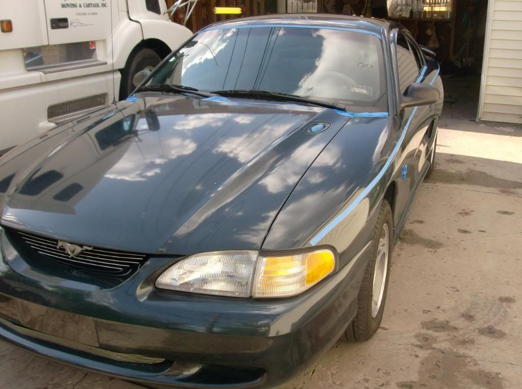

Hey guys I must start off by saying that I didn't know just who bad this car was. It has alot of orange peel and it looked like the clear was sprayed over dust so there was alot of little specklies in the paint that looked like bugs that were not cleaned off good.
http://i667.photobucket.com/albums/vv34/7082596724/mustang1988039.jpg
[IMG]http://i667.photobucket.com/albums/vv34/7082596724/mustang1988044.jpg

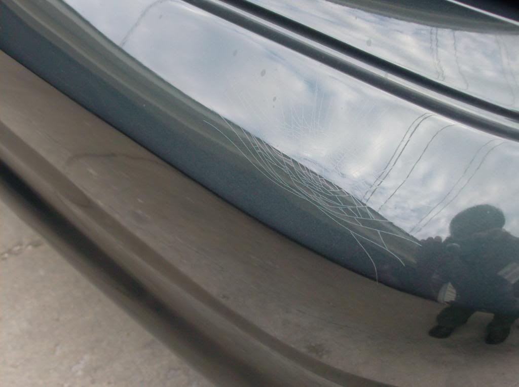

This is a corner spot on the back bumper that was spirder webbed that could not remove

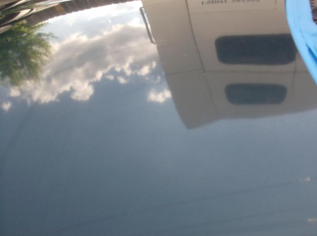

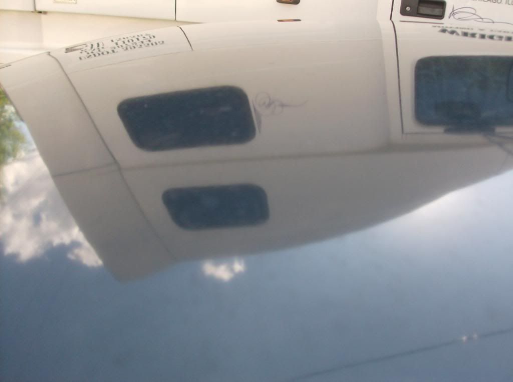

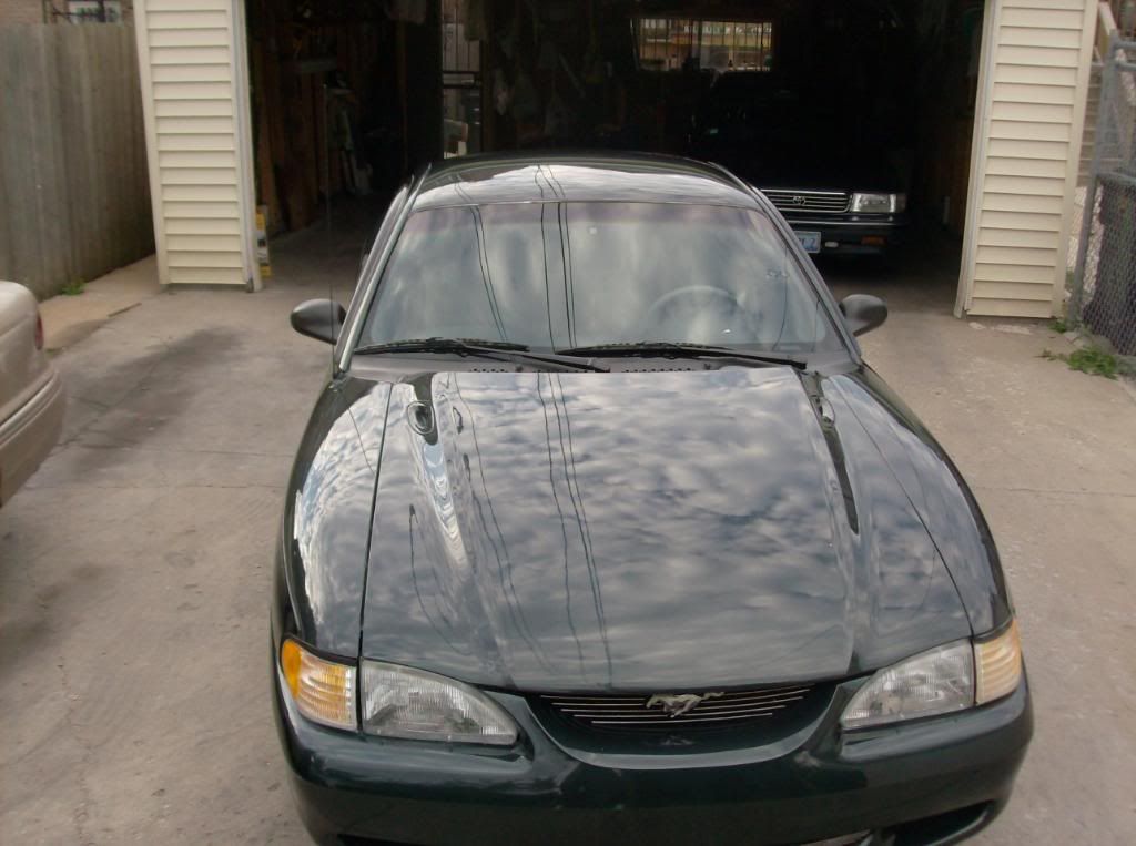

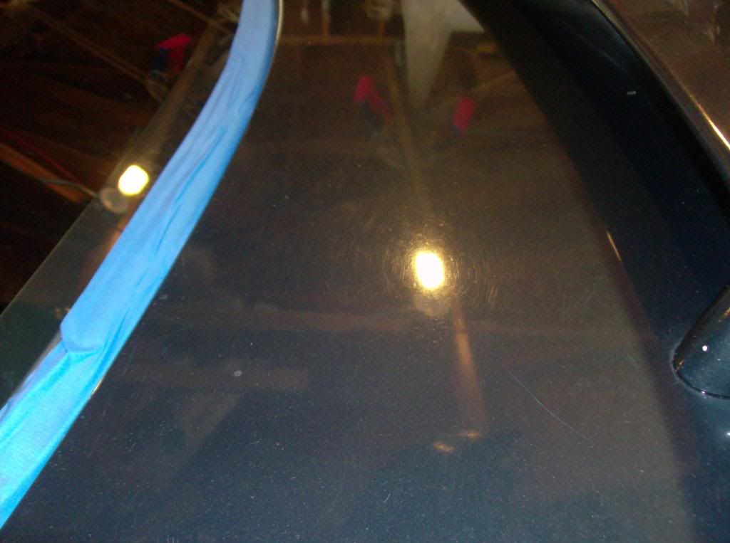

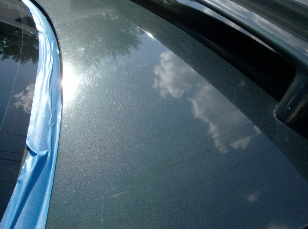

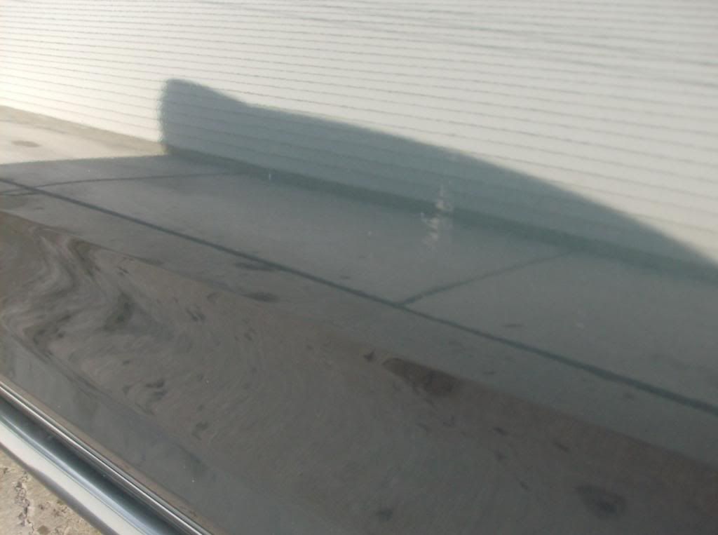

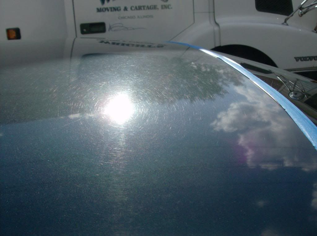

First I tried m105 on wool, it didn't work, Then I wet sanded the hood,top, and the trunk. Next I did m105 again on wool, then m105 on orange, then m105 again on white. some of my wet sanding marks were alittle deeper than I
thought they would be (my 1st time wet sanding by the way). Next I followed up with 106ff on white which cleaned up nice, lastly I use m83rd. I could not get all of those speckles out the paint becuse they were in the clearcoat.
