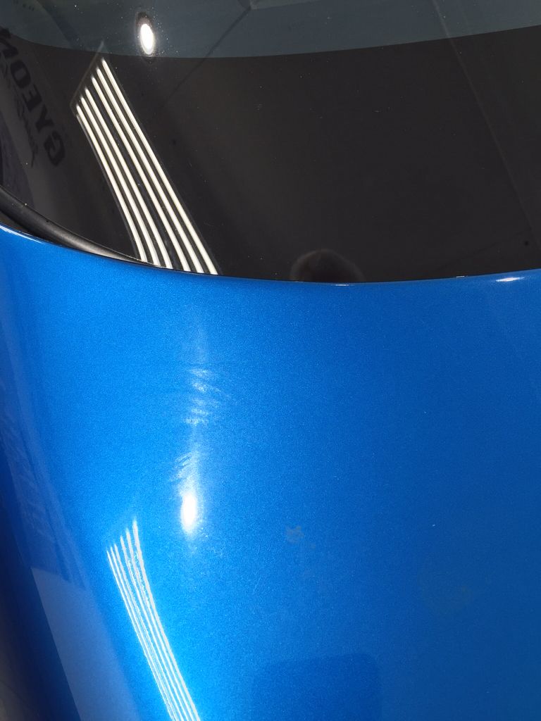

This is a one owner that had been taken to someone else. They managed to burn thru in 3 spots and I think all they used was a rotary and wool pad! Car had no shine!
now I normally would not coat a car that had so many defects that could not be corrected,but with the minimal amount of clear left the client agreed we should give the car the best chance of surviving.
m100 and Sonax 4/6 with Rupes, coated with Gyeon MOHs.
thanks for looking!
I usually find that paint hard as a rock, but this was very sticky? Micro pad just gummed up, went with cutting disc from meguiars
