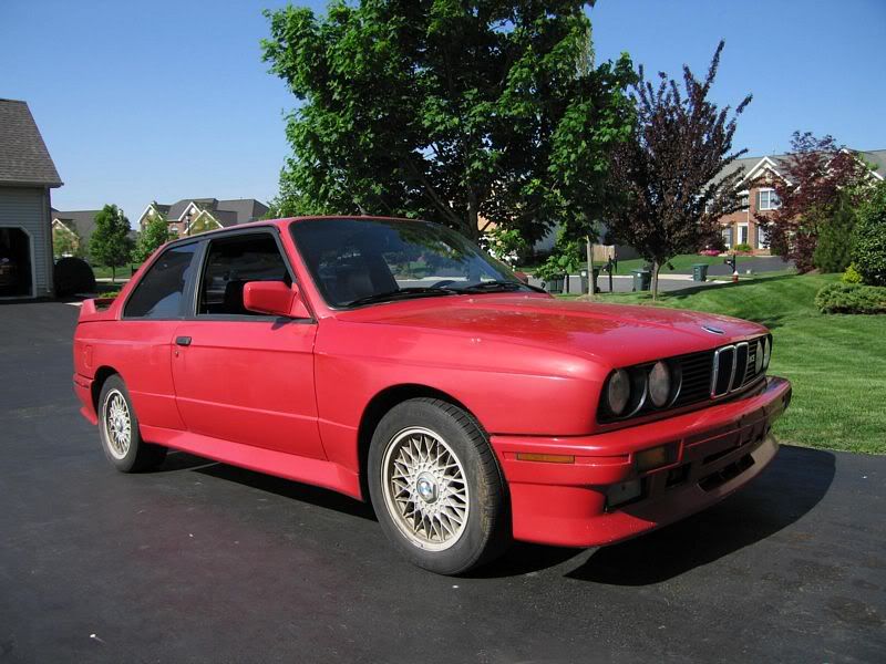

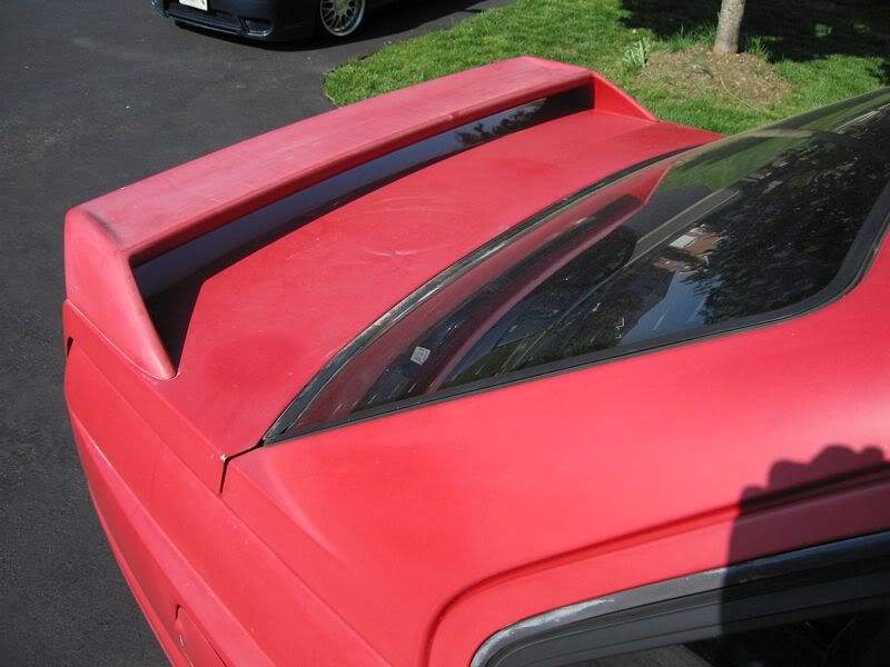

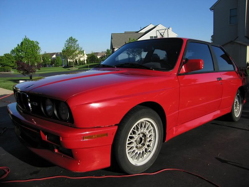

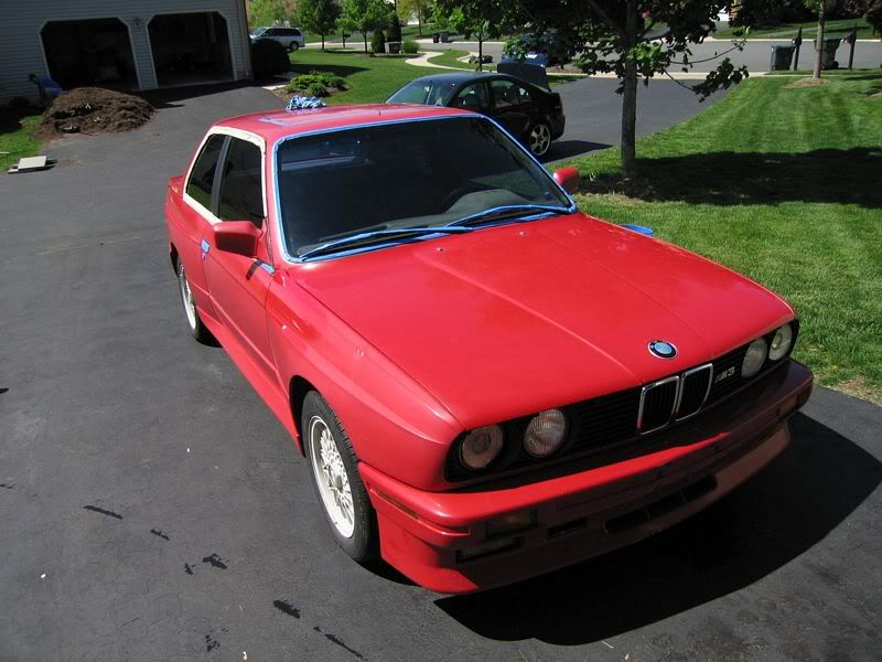

I did many steps to make sure that the oxidation was gone. The hood was CC (repaint) but looked almost worse then the rest of the car. :nixweiss
Terrible after picture. Sorry.
before

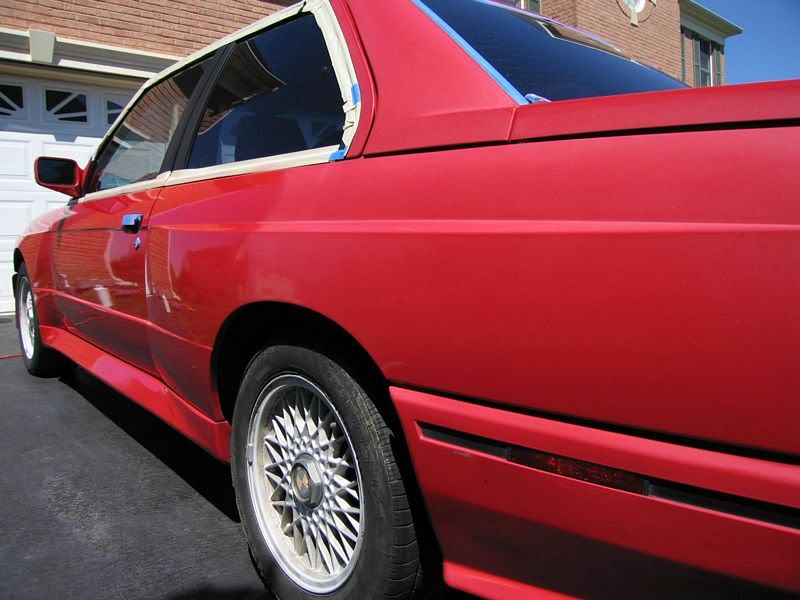

all taped up
during
after

Horror show before, show car after. :)
Thanks guys - sorry no more after pix, but I have to do some touch up work for the guy soon. Claims I missed some spots. :confused:
the wing/trunk came out excellent. Not sure how long it will last on the wing though.
wash
ssr2.5
aio
dp Mild swirl remover
dp final polish
op
ohc
some ssr1
these were the polishes I used throughout.
rotary/pc
Sealed with FK1 #2180
