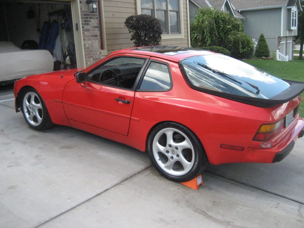

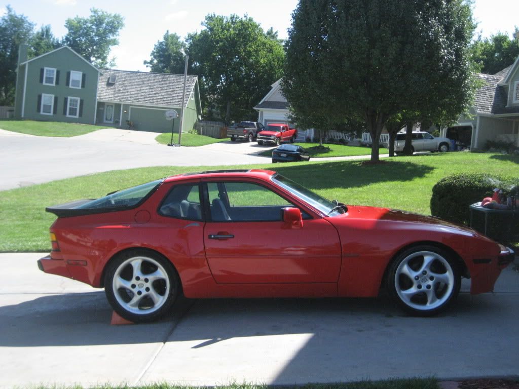

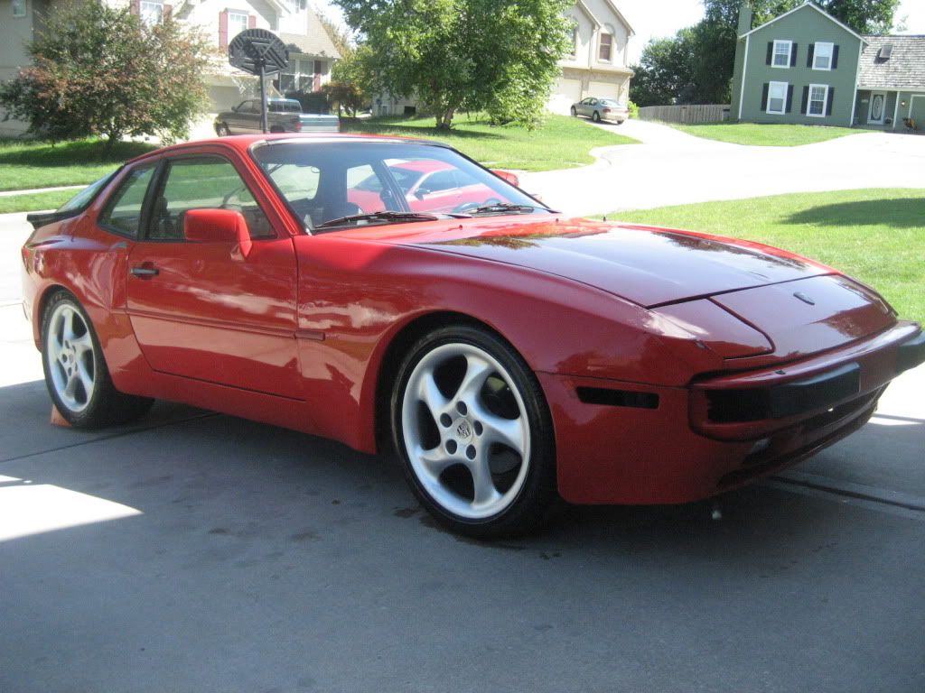

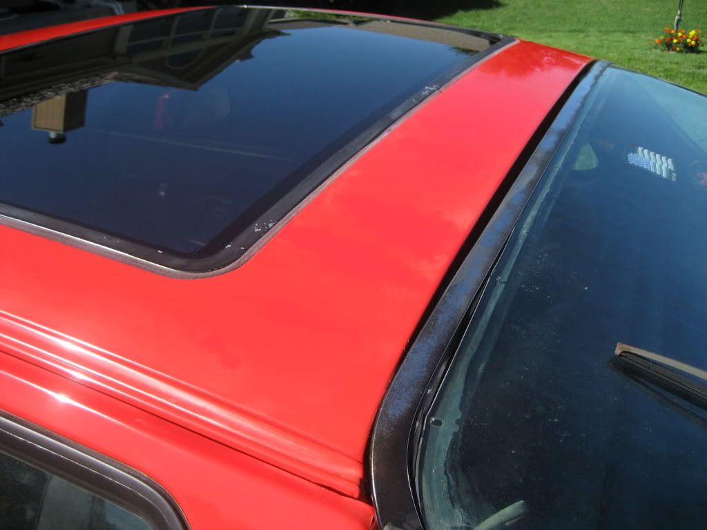

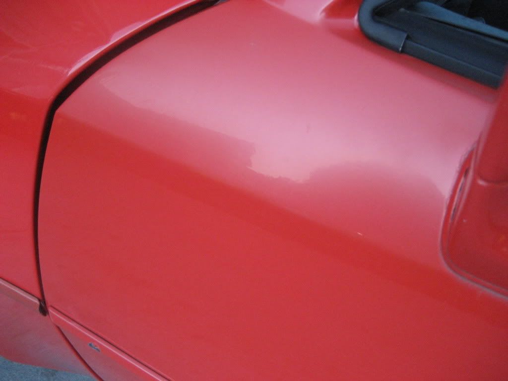

gave this an exterior only detail on sunday..

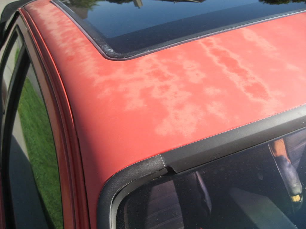

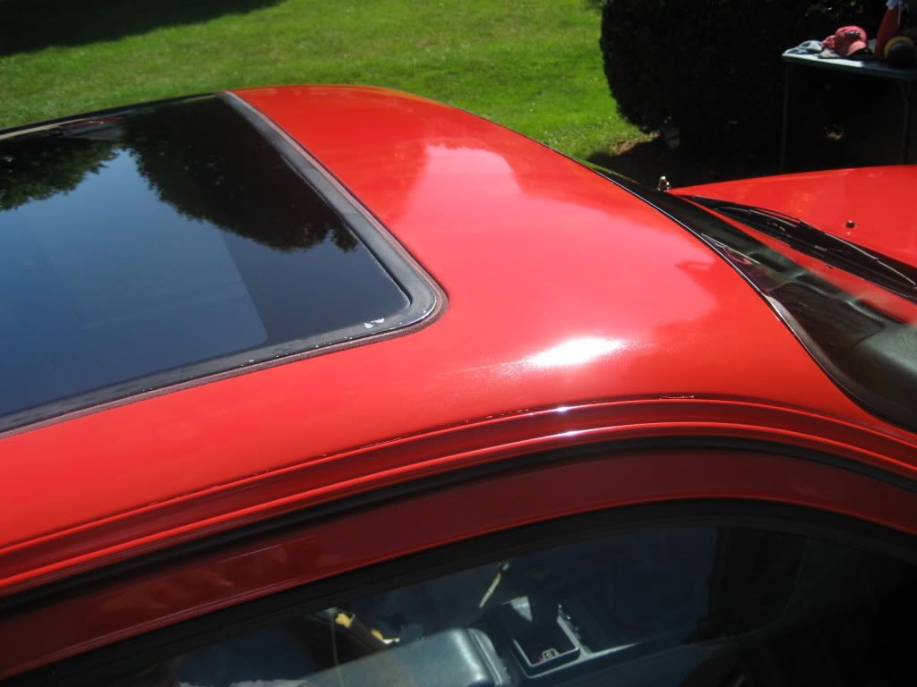

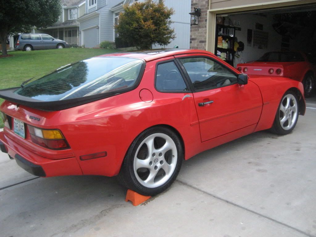

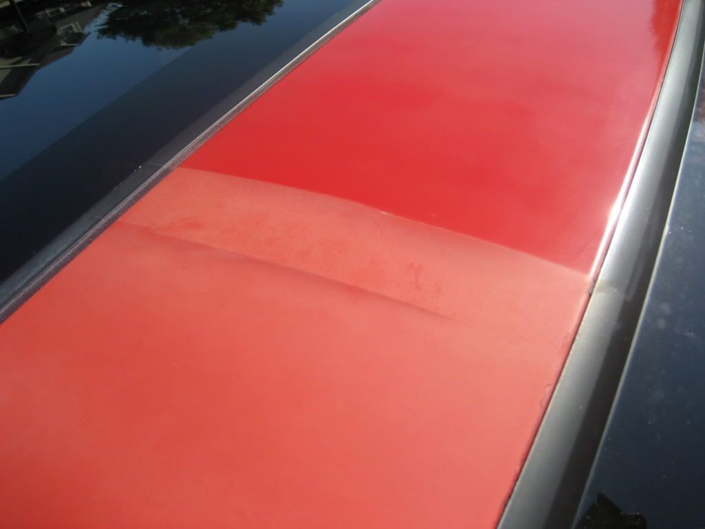

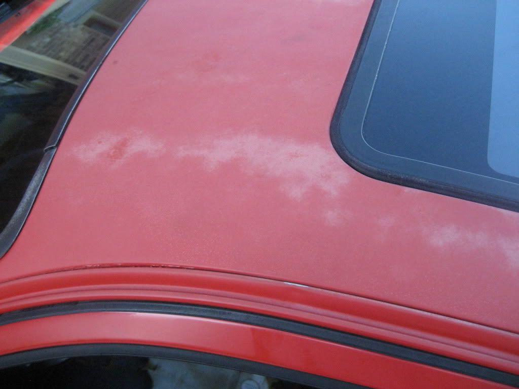

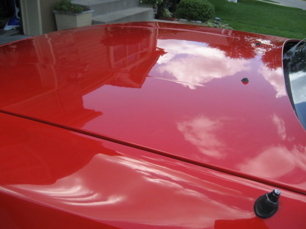

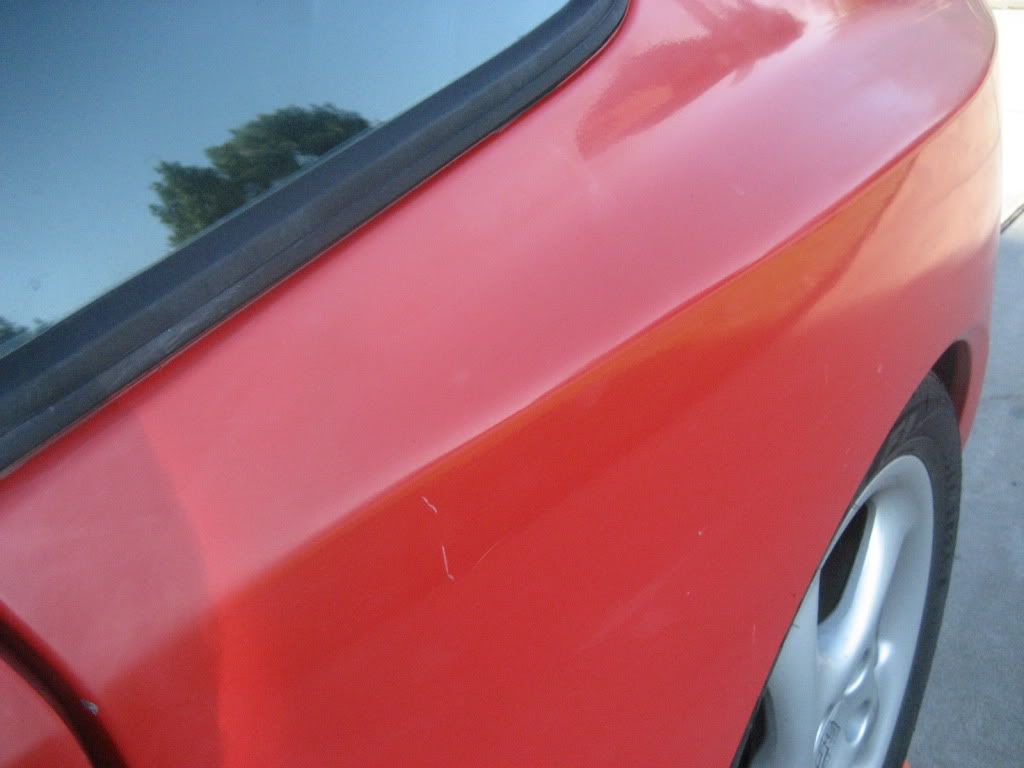

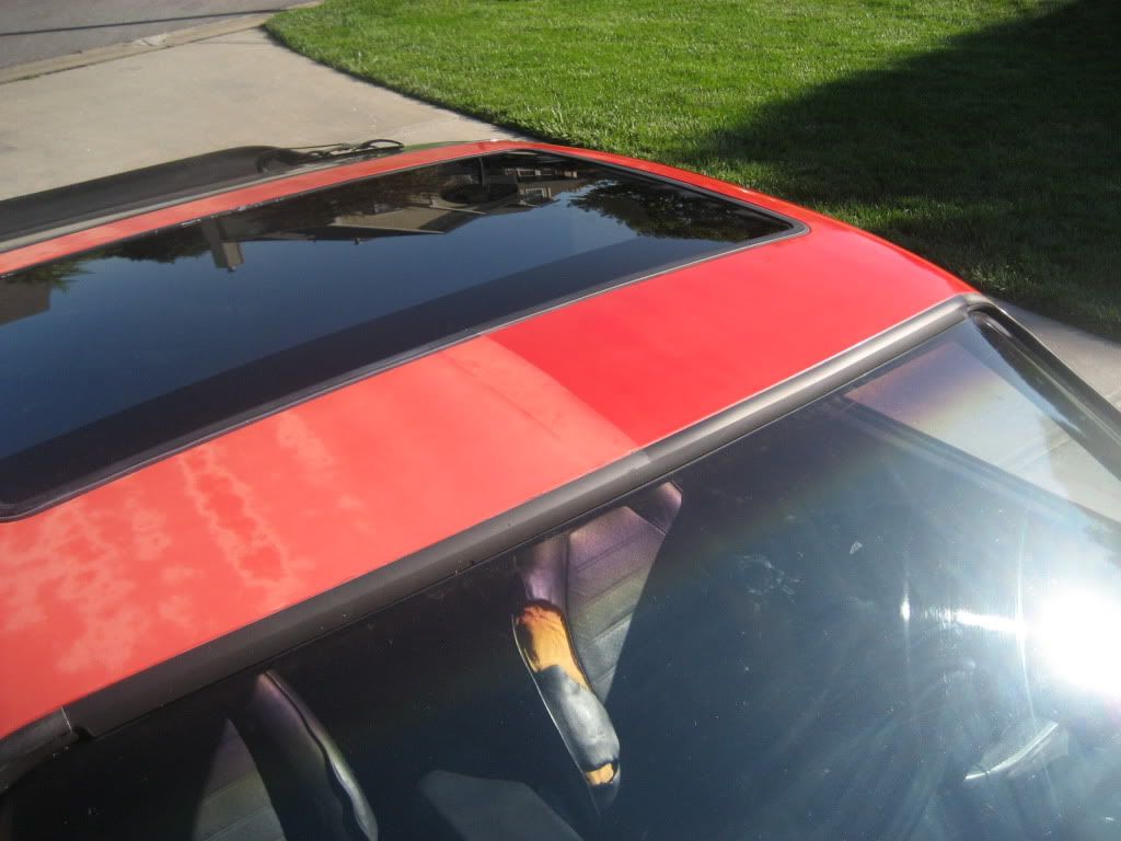

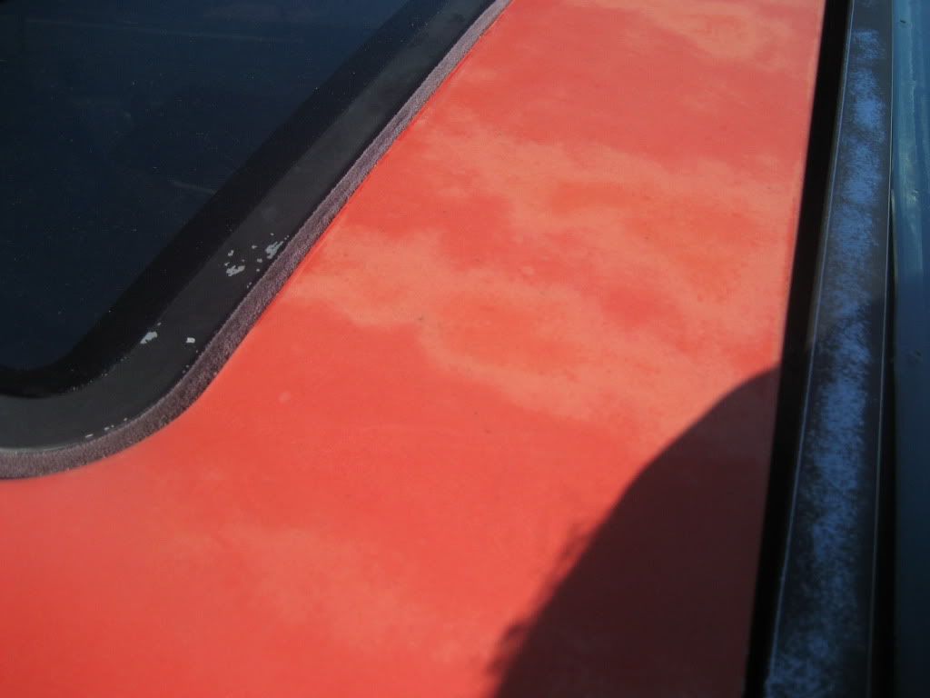

was lightly swirled, and is the super of our apt complexes car, he sees me cleaning, my car every weekend and i wax his car for him from time to time, but he finally asked me to polish it out for him ..

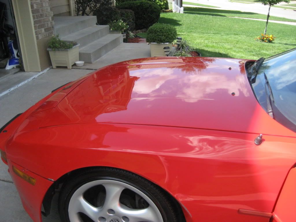

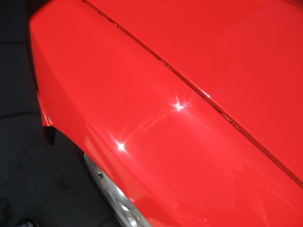

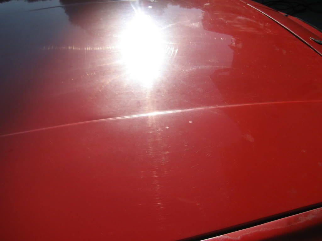

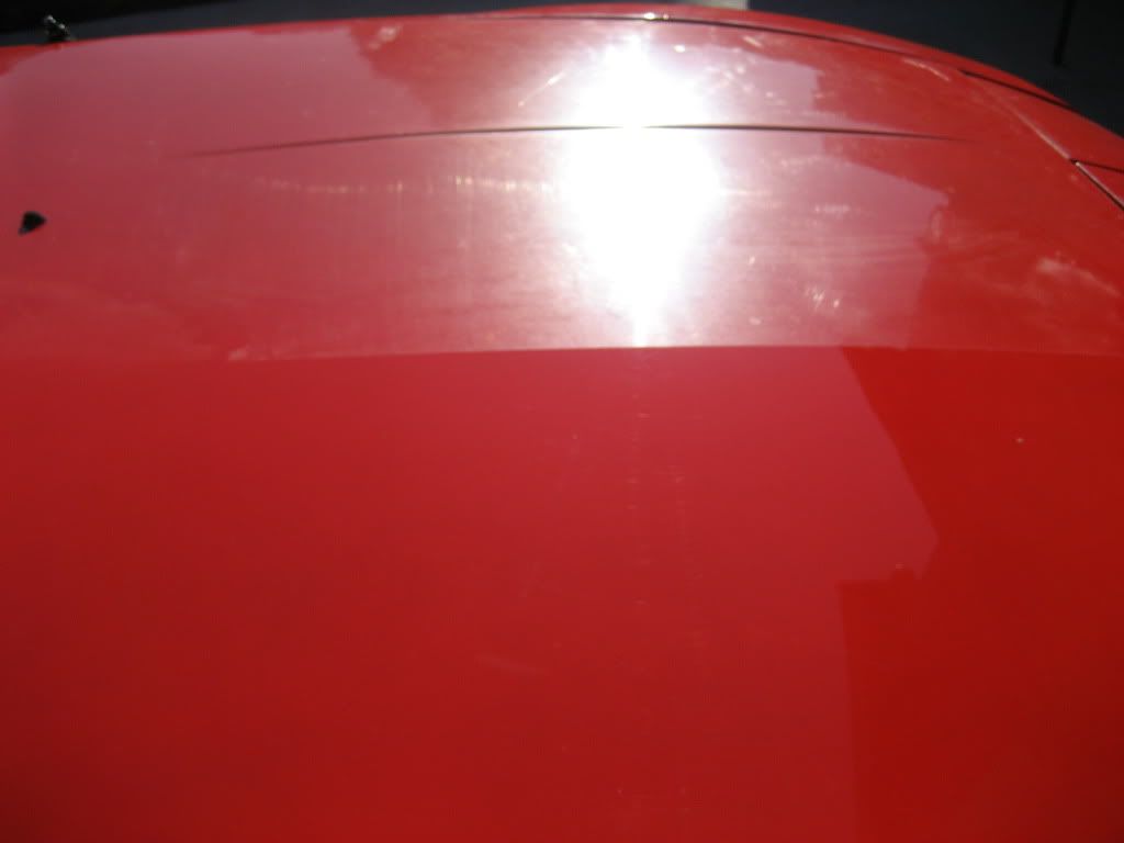

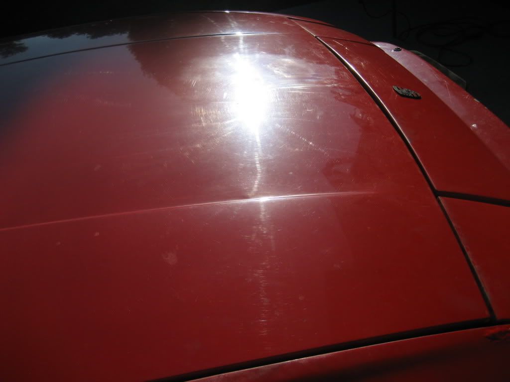

so being that it was lightly swirled, and it is oem single stage paint, i figured it would be a easy recovery..as it was..

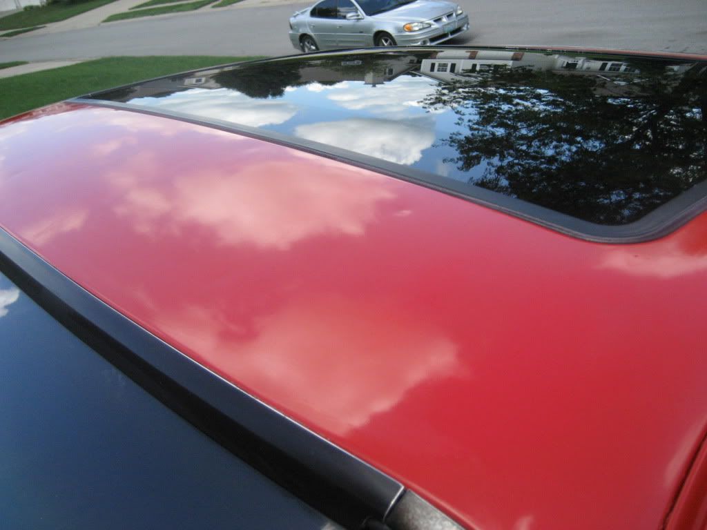

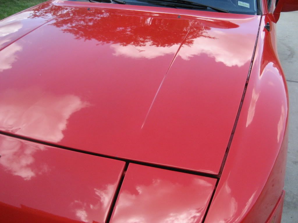

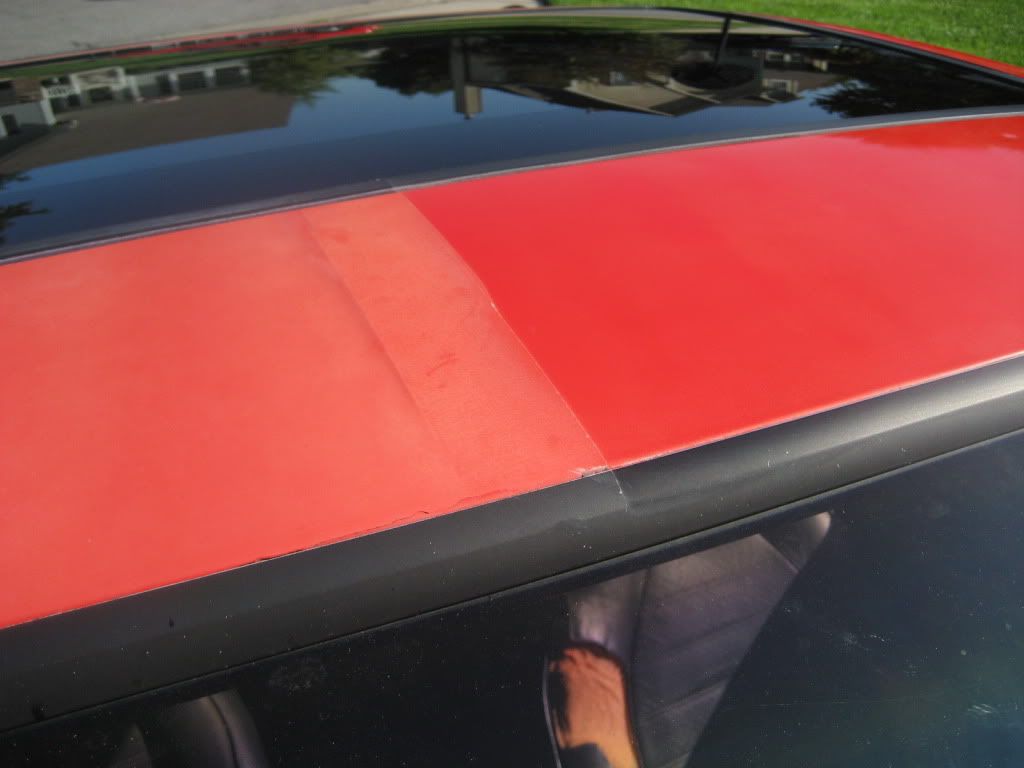

m80 on polishing pad via udm speed 6
m80 on a finishing pad via udm speed 4-5
gold class paste by hand

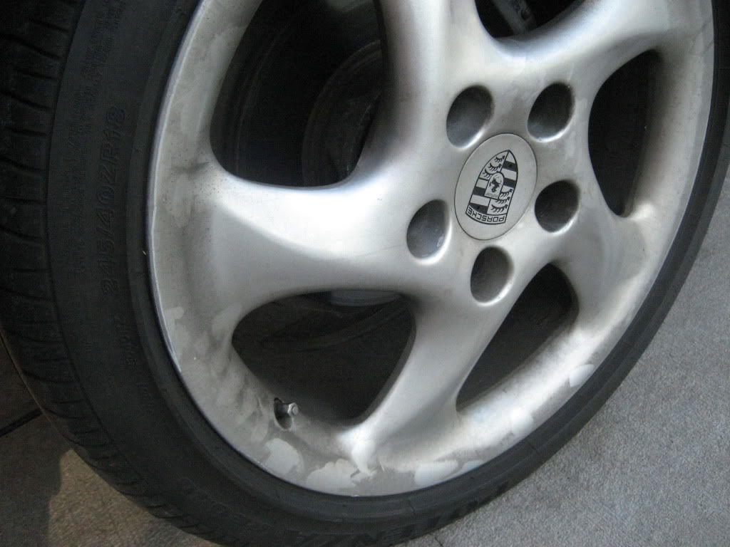

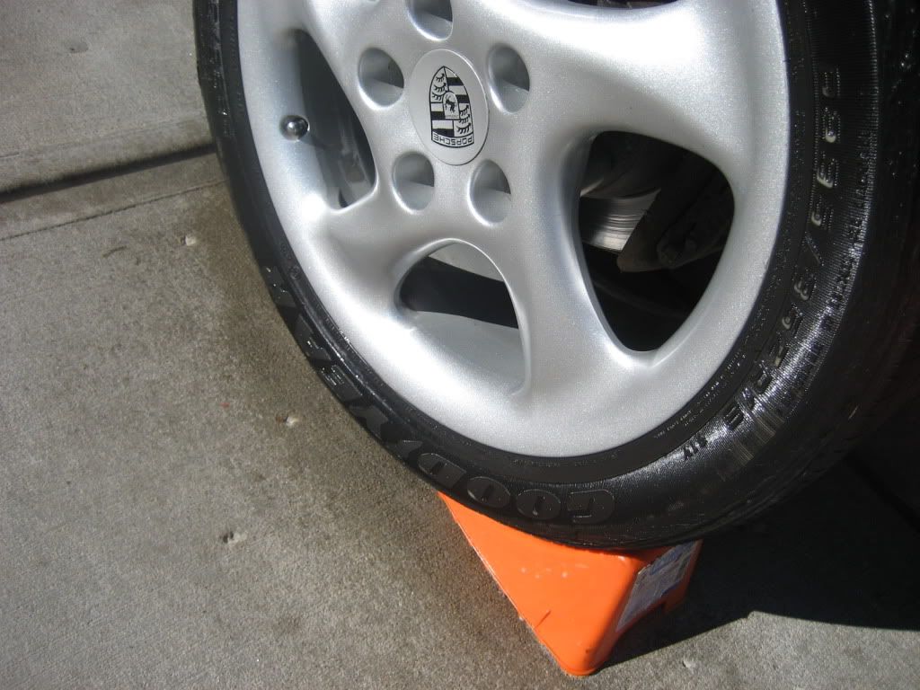

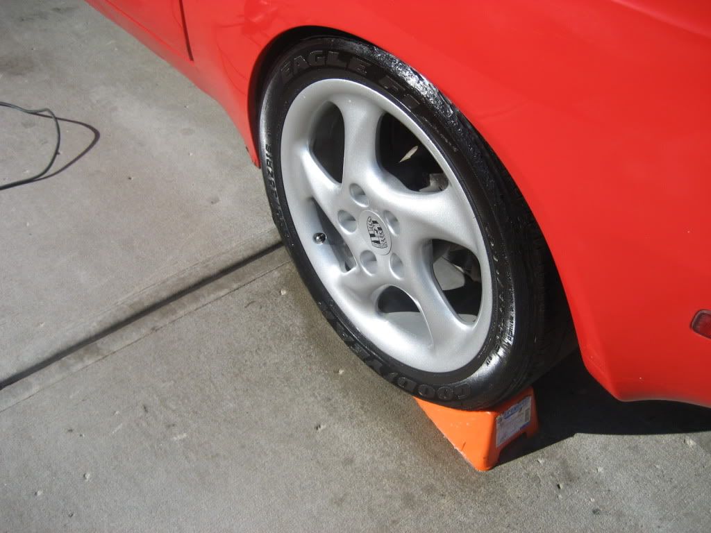

rims were cleaned with quik wheel detailer and my finger in a mf towel..
tires dressed with endurance gel
windows cleaned with stoners IG

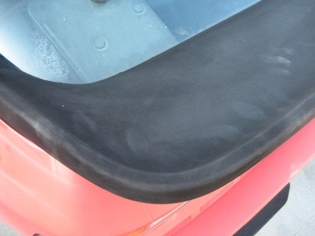

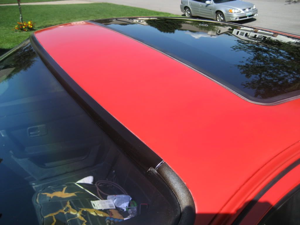

all exterior black trim dressed with megs vinyl and rubber protectant
thanks for looking..
