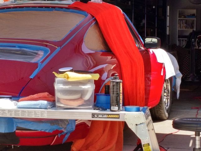

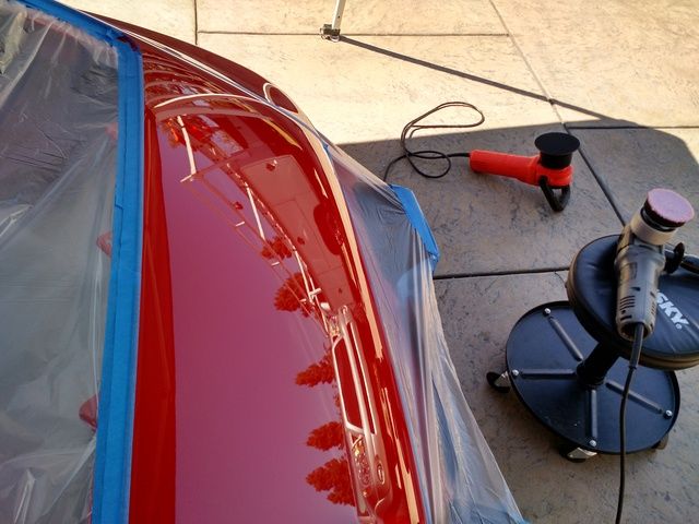

Process:
Washed with Megs Gold Class
Polished with a WG Orange Light Cut pad and Megs DACP #83
Followed with SSR2.5 to tackle more swirls on a WG Orange
Touched up in spots with SSR1 on a WG White Polishing pad
Waxed with PC and a WG grey finishing pad and Megs NXT Tech Wax

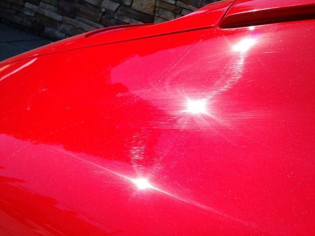

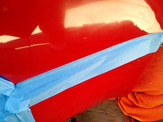

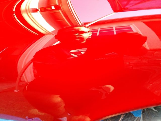

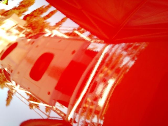

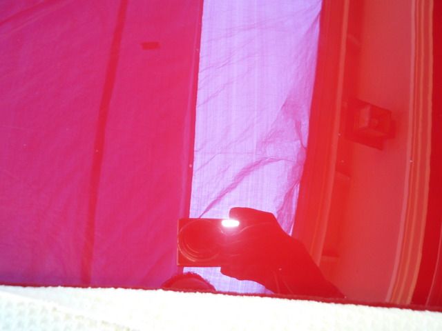

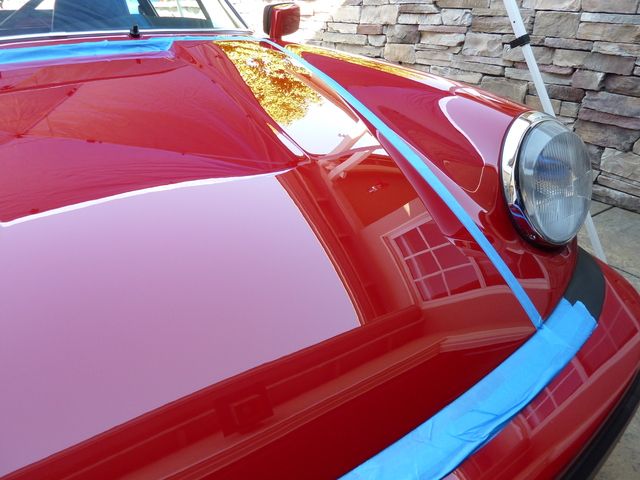

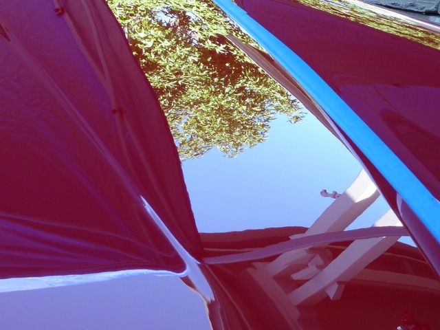

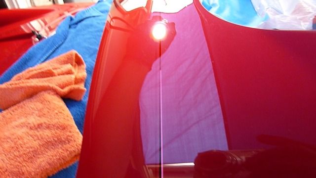

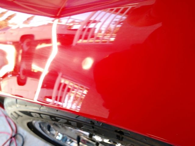

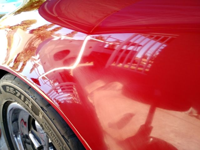

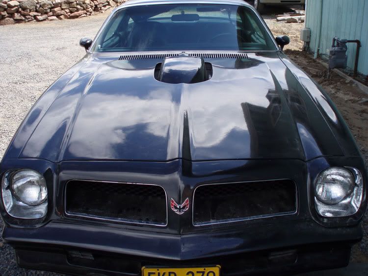

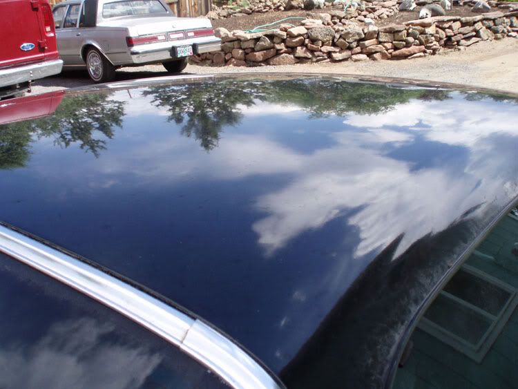

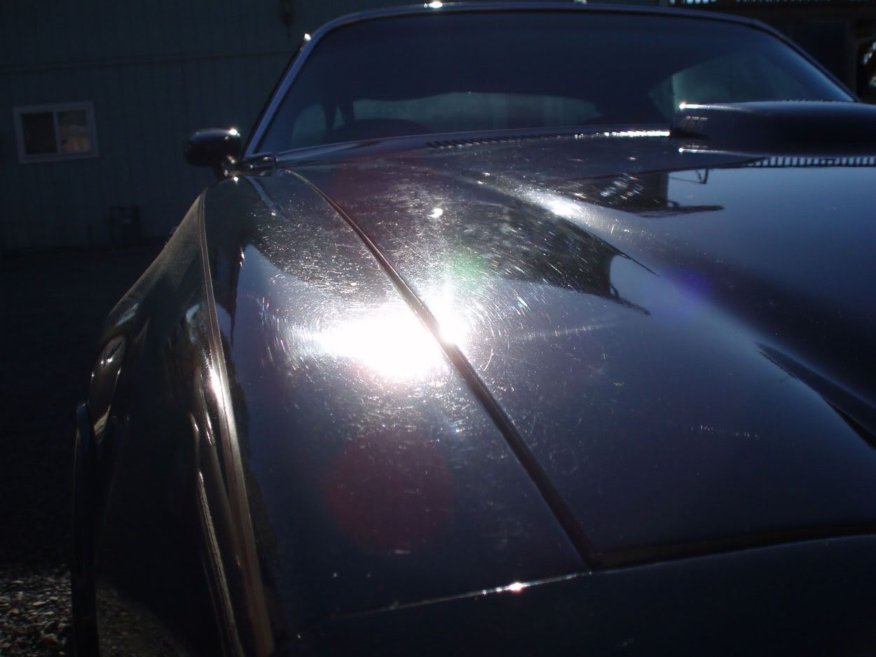

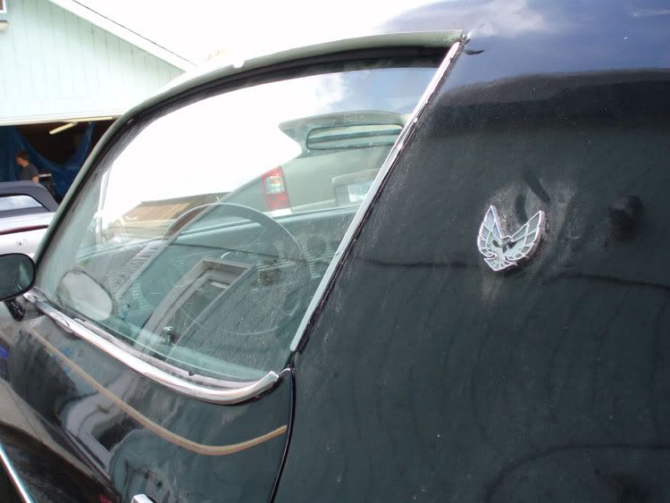

Before shots (Some you need to look real close to see the etching)

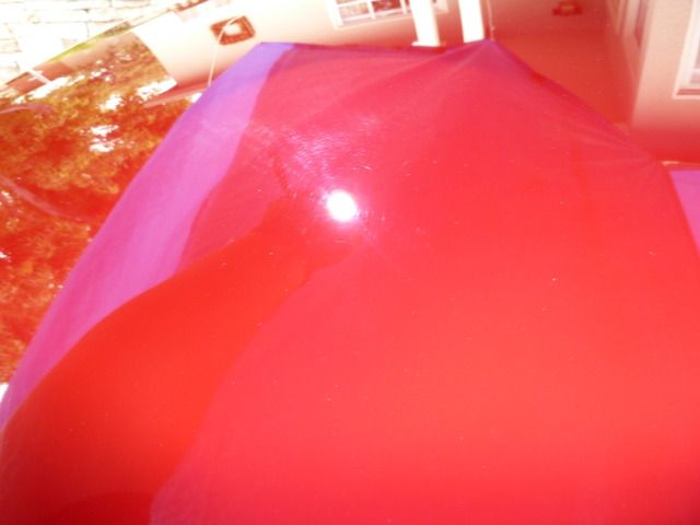

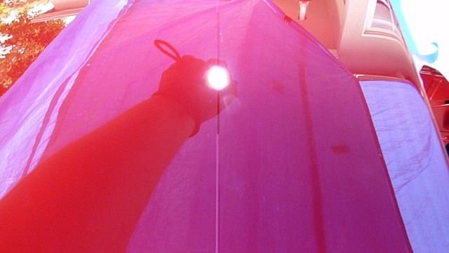

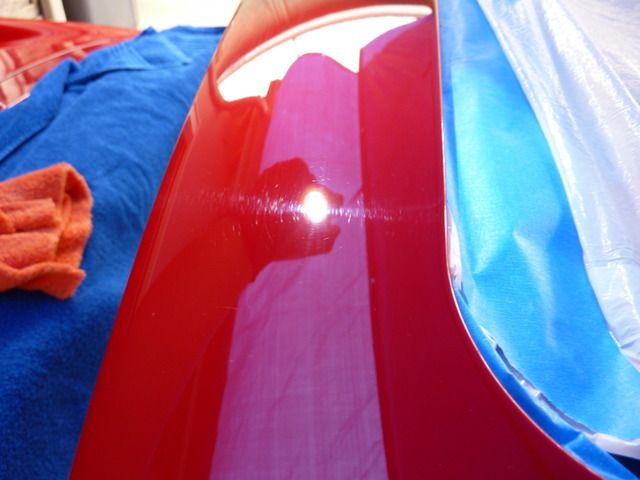

This next shot made me cringe

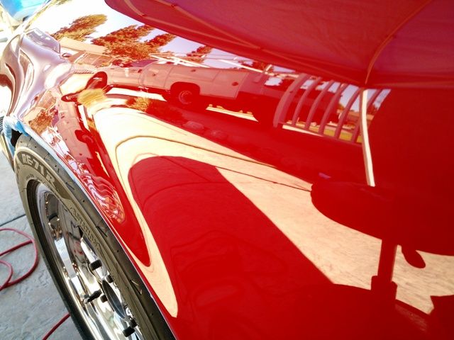

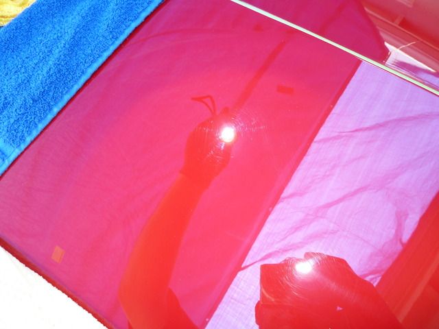

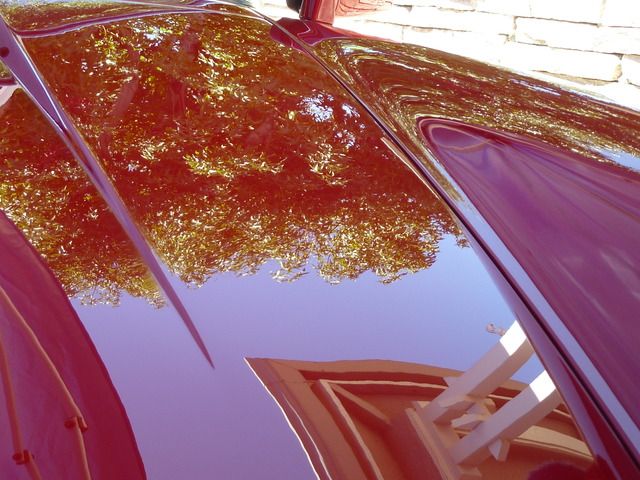

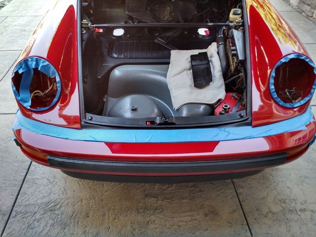

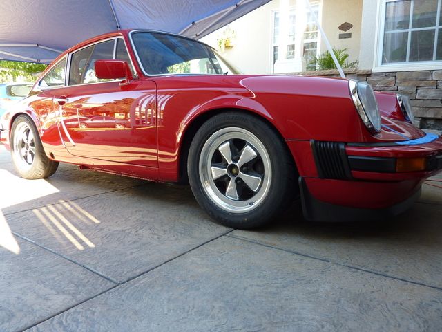

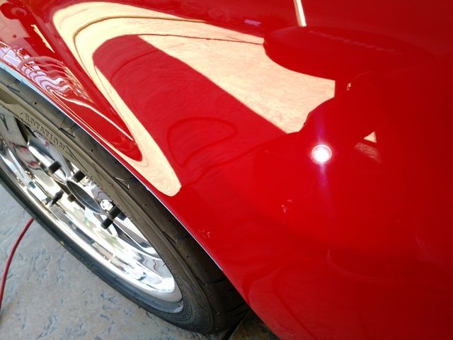

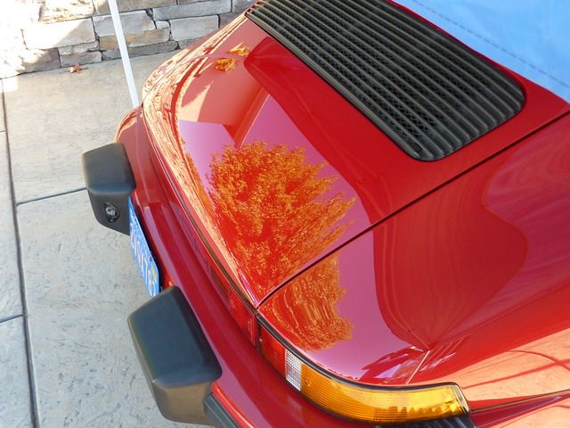

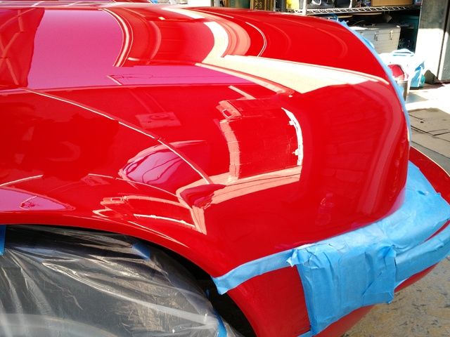

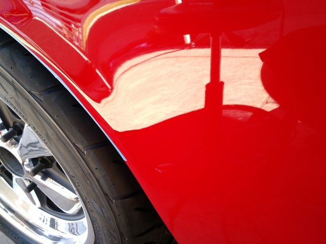

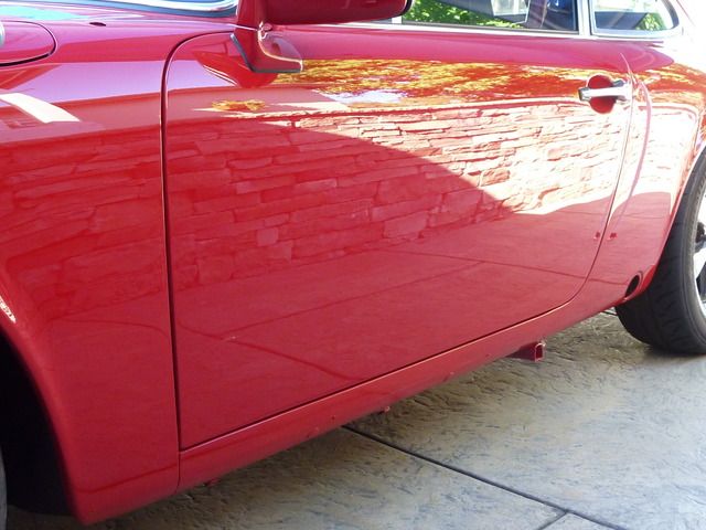

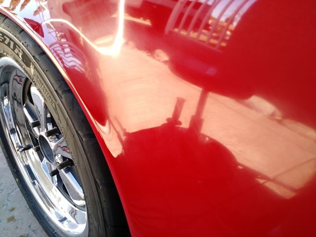

After shots:
