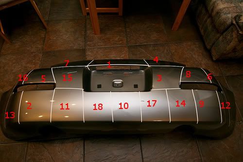

In my never ending quest to find my favorite LSP, my buddy and I decided to do some comparison between all the LSP's I had available. I had a spare 350Z Silverstone bumper which I was planning on using to practice wetsanding and painting, but I figured this would be perfect for some LSP comparison. We prepped the bumper with Megs 105/205 applied with a flex and did an IPA wipedown before applying any products. Here is a list of products applied:

We split the bumper into 18 different sections, 17 for product and 1 for the control.
We then applied the products in various spots while noting them on a diagram I made. After applying the products, we did some comparison. I was very surprised with how some of these products looked when put side by side with various other products. I asked my roommate who is a complete n00b when it comes to car care for his opinions as well as an experienced auto care enthusiast. Here were the results, keep in mind both reviewers did not know where each product was applied. Both observers were also able to easily identify the control.

First, I think the seven panels along the top of the bumper (bottom of the picture) have an unfair advantage since they are the largest, flattest, and most uniformly shaped panels.

As far as this test goes, I didnt intend for it to be a scientific test, I just wanted to compare the different LSP's I had available to me. I do agree that the curved panels do somewhat skew the test but the bumper was the only painted panel I had available, I obviously would have prefered to use a hood or the side of an RV:lol but I didnt have that available to me.

Here is the list and placement of each LSP.
1. Ultima PGP
2. Poorboys Natty's Blue
3. P21S 100%
4. S100
5. Dodo Juice Supernatural
6. Wolfgang Sealant 3.0
7. Optimum Optiseal
8. Pinnacle Souveran
9. Collinite 845
10. Megs NXT2.0
11. Klasse SG
12. Pinnacle XMT 360
13. Megs #26
14. Menzerna APO 60
15. Klasse AIO
16. Poorboys EX-P
17. Pinnacle Liquid Souveran
18. Control
I'm the buddy that helped, in case you're wondering. :) I'm also the "experienced" opinion, as well as the one that removed the LSPs from the bumper.
