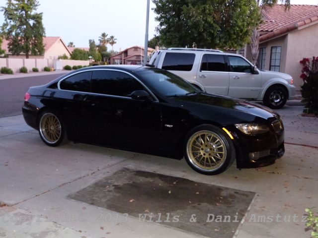

There she is. It was dirty, swirled, covered in bugs and had NO protection on it (the water ran totally flat!)

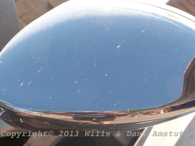

Few bugs for good measure were on the mirrors and front bumper:

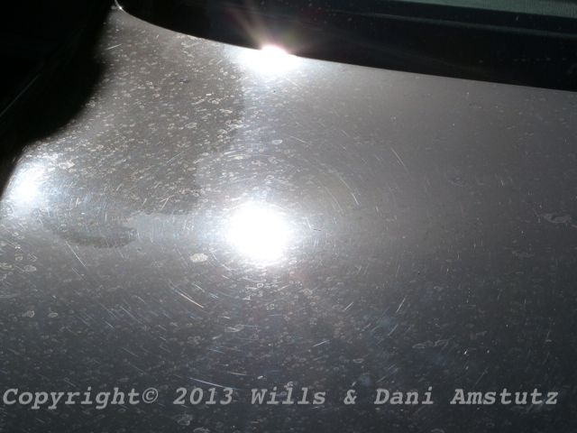

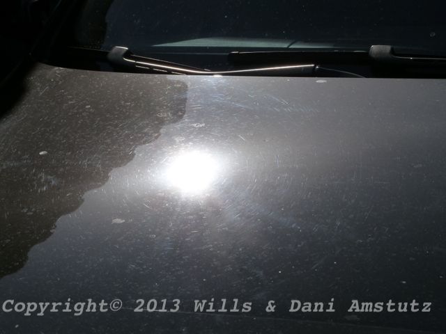

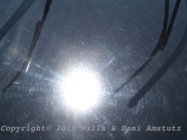

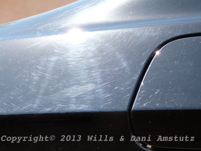

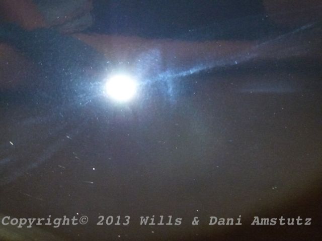

The swirls were very bad, but we couldn't get a true feel for how bad due to all the dirt that was on it:

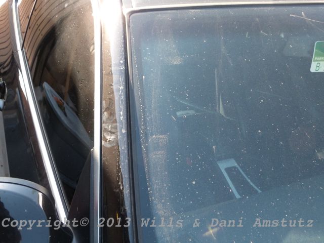

Did I mention it had dirt? Cause if i didn't tell..yeah it had lots of Arizona dirt all over it. And this time of year we hit 80 degrees at the crack of dawn...during the washing process we passed 90 for sure.
Black paint and Az sun = 3rd degree burns! It also equals a very difficult wash...have to make sure the water doesn't dry during the rinsing, washing and re-rinsing...lots of fun.

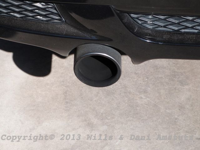

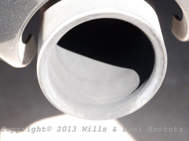

The tips...well I dont even wanna talk about the tips lol:

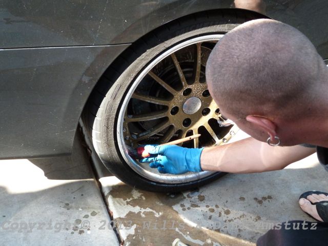

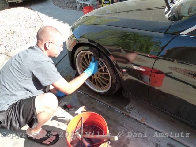

We'll go back to the wheels for now...tires needed a good cleaning, Power Clean ate up the road grime that covered them:
Each wheel looked about like this:
P21S...first time using it...liked it quite a bit...actually did 'cling' to the wheels much better than our other wheel cleaners...did a nice job too:

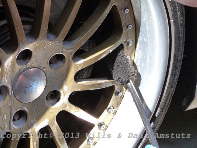

Atlast Soft Tip Brush...most durable brush, ever?

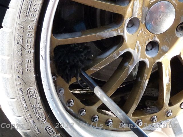

And of course the wheel woolies. The barrels of the wheels came out much better, but the REALLY needed to just be pulled and given a full restoration...we did what we could with what we had to work with though:

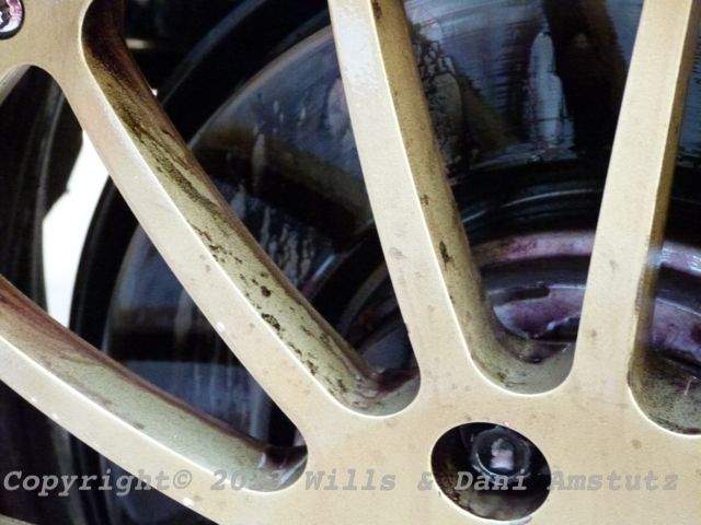

Now even after thoroughly washing, spraying, and cleaning the rims..they were still not up to par with what we wanted...so..we broke out the good stuff:

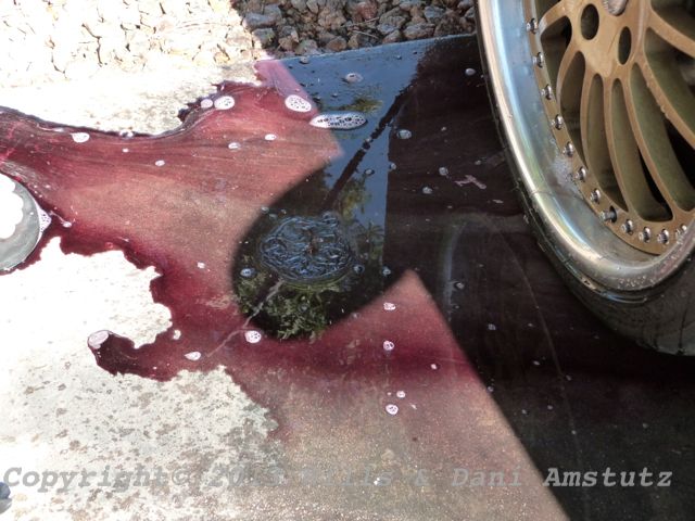

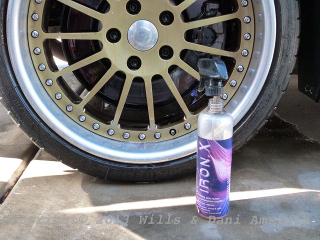

We soaked each wheel with Iron-X to help break down the grime that even P21S wouldn't touch...and it did:
The rear wheels were bad...but the FRONT...oh my lord...Dani said it looked like it was oozing grape juice:
Personally i thought it looked like we had just run over Barney:
We had a RIVER coming out!
Ive never been a heavy iron-x user but on the rims it really made a HUGE difference. The wheels were much better after the initial clean but after the IX it truly did make a night and day difference.

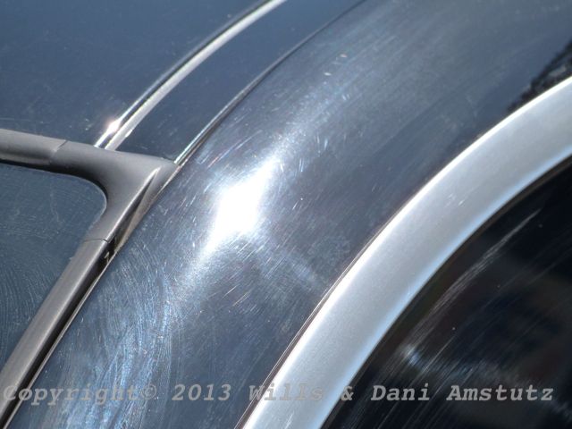

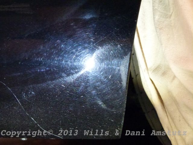

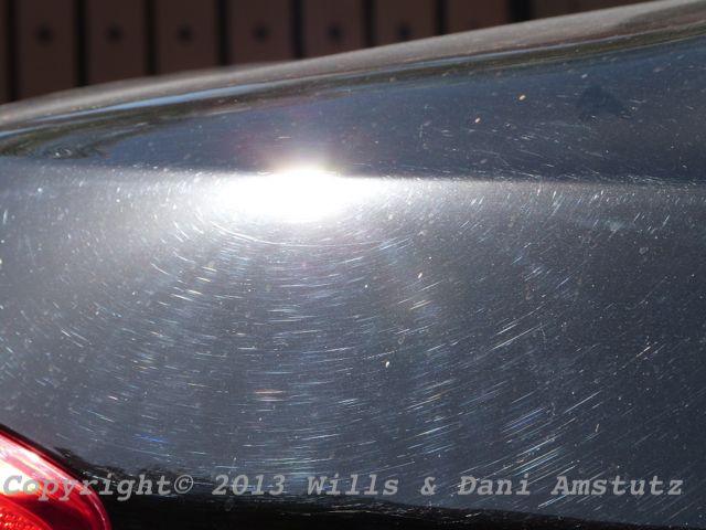

As the sun...and temperature...came up further...the damage this car had because more and more apparent...even dirty:
Ouch...

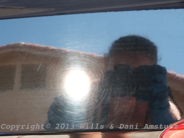

The passenger rear quarter was the one area the owner said REALLY looked horrible to him...we could see why.
Remember earlier how i said the water ran FLAT...well i wasn't lying. I don't think this paint had seen wax in a long...long time:

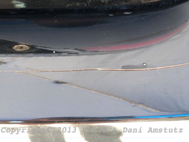

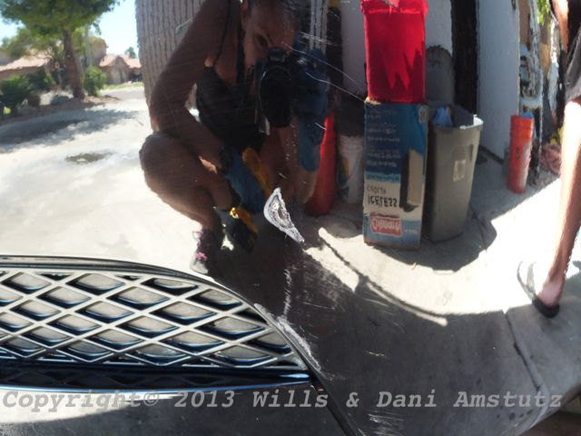

She also took note of things we COULDN'T fix...like the split bumper:
And gouges up front:

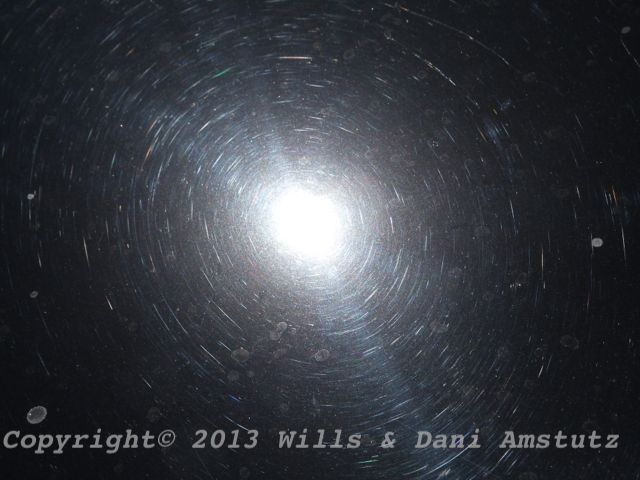

The paint wasn't just swirled, it was faded too :

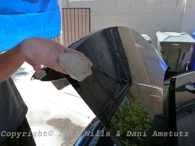

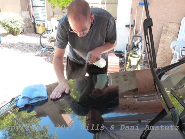

ANDDDD i was still claying....

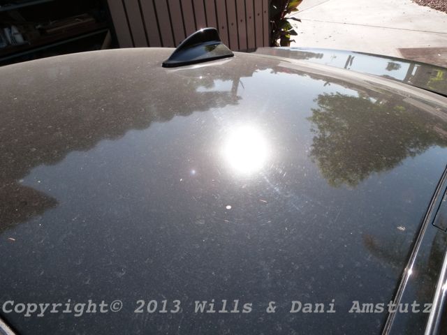

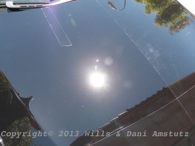

Roof was REALLY swirled and REALLY grey looking:

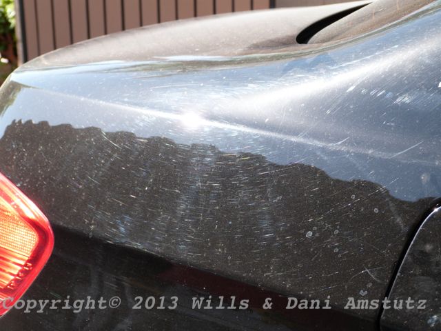

Trunk was a MESS:

ANNNNND...i was still claying:
Got that off just the hood!
Glass needed claying badly as well:
YES damn it im still claying! Leave me alone!

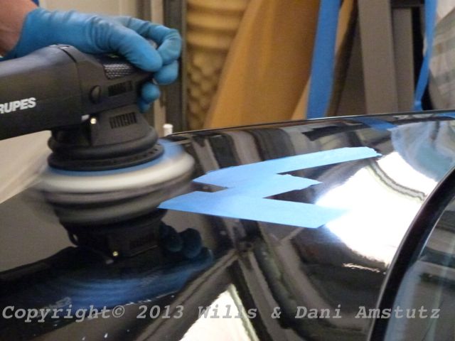

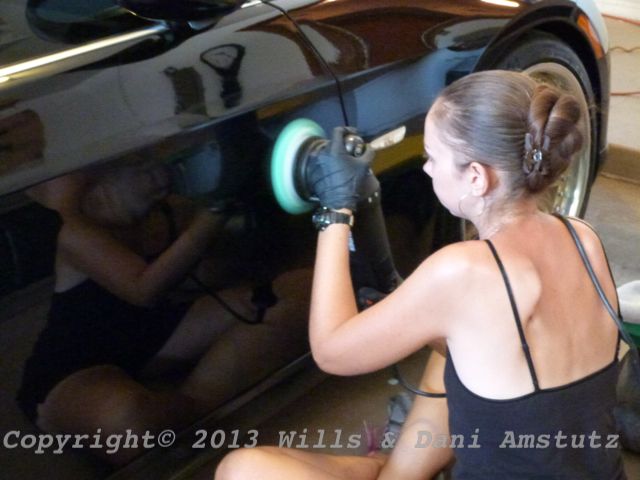

With lots of pads, polishes and machines to choose from...we decided to not go super aggressive to start out with. Being that this paint was notoriously soft, a hard core combo wasn't what was on the menu for our first attempt.

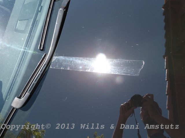

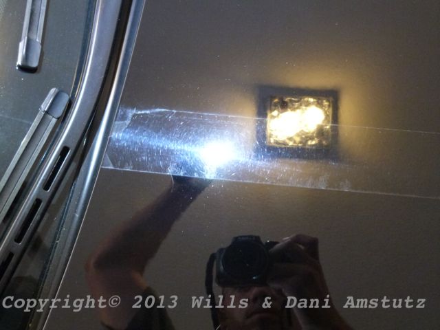

As always, we taped off a test spot...a couple actually. I figured 205 and megs MF finishing pad to cut with (sounds hypocritical right?) would be a good start...and Dani suggested a Buff n Shine Green to polish with...so...we took a shot to see how it worked out.

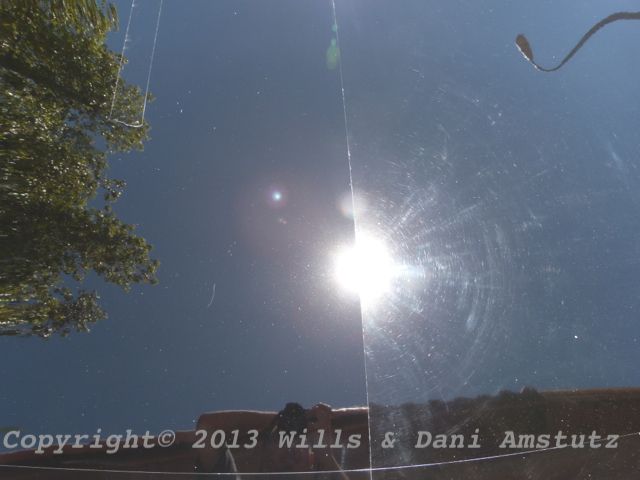

We went ahead and did our test spot outside under the tent. I did that while Dani got the garage all set up with every thing we'd need. The 205, Rupes 21 and Finishing pad cut the hell out of the defects. It had a few deeper scratches left over (as in you could count them on one hand) but a MASSIVE improvement. Of course...using a pad like that and on soft paint..it marred/scoured it up pretty good. Thus the reason for the 205 and foam pad to follow up.
I thought the green pad might be a bit too aggressive to finish with but, Dani knows her stuff and really likes those green B&S pads...so thats what i went with. She made a damn good call:

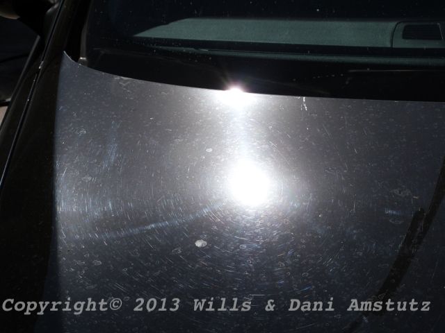

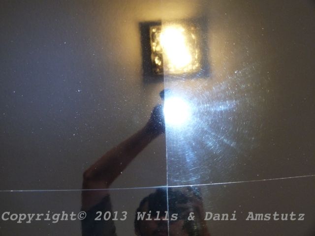

Under sun gun and LED light....the finish looked on point. The road rash (pitting, whatever you'd like to call it) was a serious eye sore but...welcome to black paint in Az where sandblasting your car is free!
This was outside though...and even though we were under the tent...there was still lots of indirect light coming in...so once we were all set up in the garage, we pulled it in...shut the doors and worked under just our own lighting (as much as humanly possible).

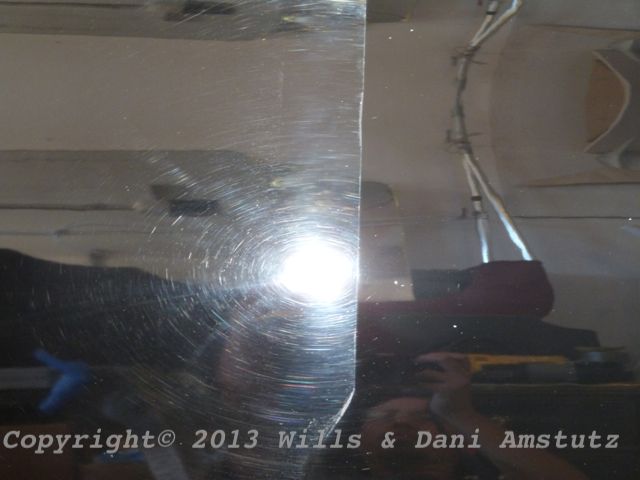

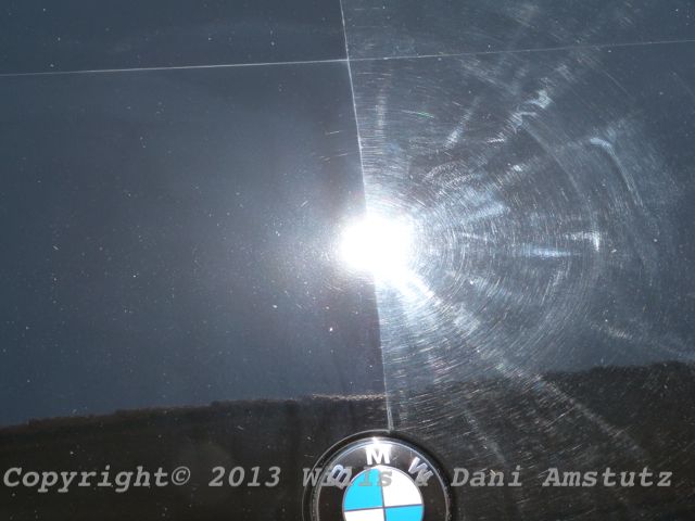

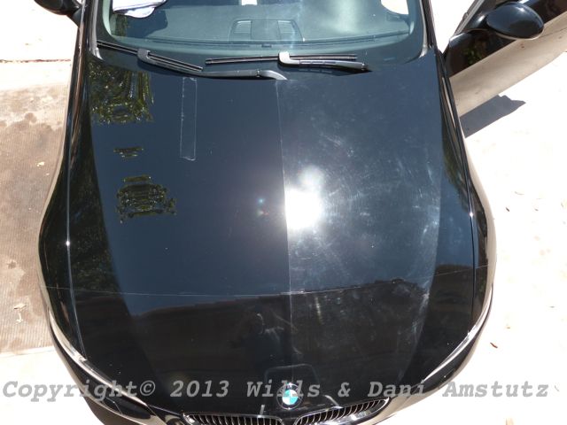

We taped off another spot on the hood just to see if we could repeat the results of the first test spot. Well...even with the not so wonderful over head lighting...the improvement was obvious:
And under LED lighting...even more obvious:
The tape line now stood out like a horrible hood stripe gone wrong lol:
The surrounding paint looked beautiful though:

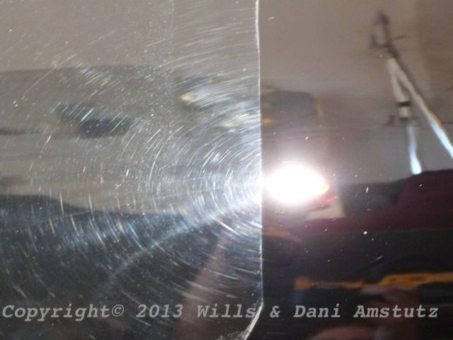

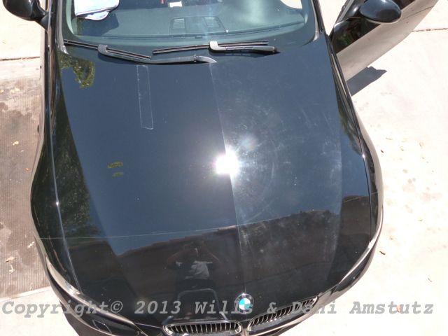

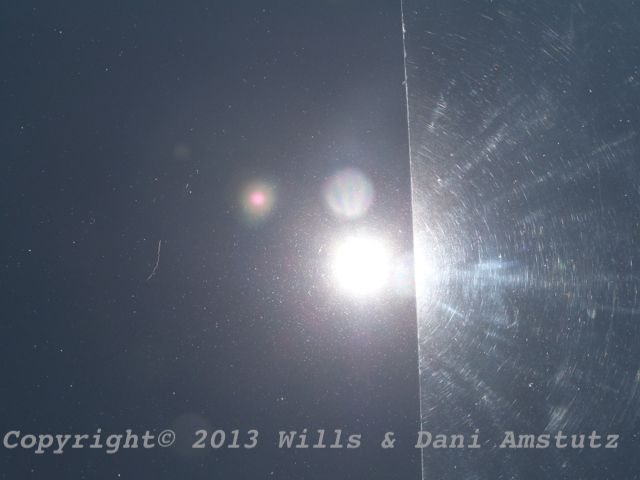

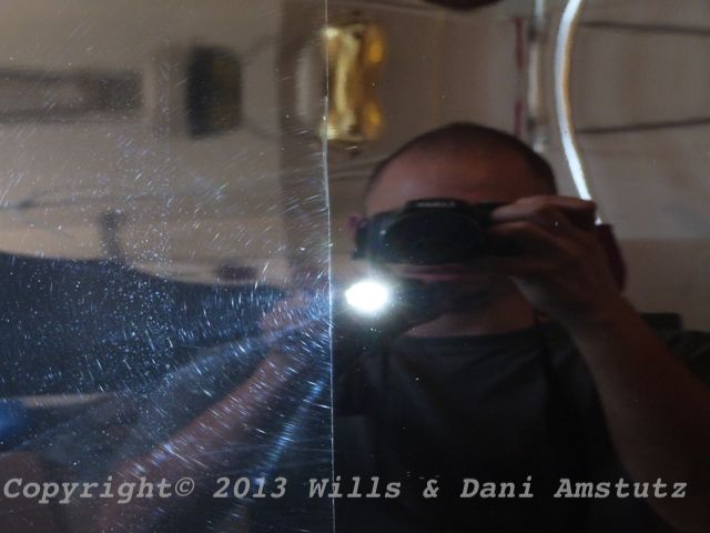

Next we taped down the center of the hood ....then cut and polished half...again...results speak for themselves. Left side done, right side not:
And remember that nasty clear bra....well it took some extra doing (damn polish kept wanting to stick to it!), but it had a drastic improvement as well:
Now of course while it looked great inside under multiple light sources...we had to pull it out to REALLY check our work. Also note...the polished areas had been wiped down and stripped of any polish residue so that we could see the TRUE outcome of what we were getting....no fillers or false results.
Survey says?
Haaa, tape line was still there...man it looked funny but really showed what a huge difference we were getting.
And to think the WHOLE HOOD looked like that little strip just a short time ago.
Clear bra was looking on point too (with the exception of all the pits and nicks it had in it.)

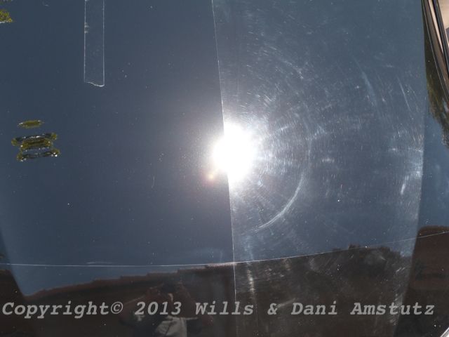

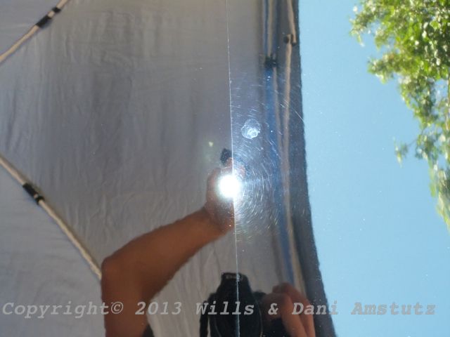

THIS, was the money shot. I went and got my butt up on a step ladder just so i could share this with you all
Not sure whats more attention drawing, how good the left side looks or how BAD the right side still was.

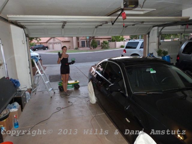

Back into our cave we went lol. We had crossed over 100 degrees by this time and with all the door shut well...we were in our own personal Easy Bake Oven!

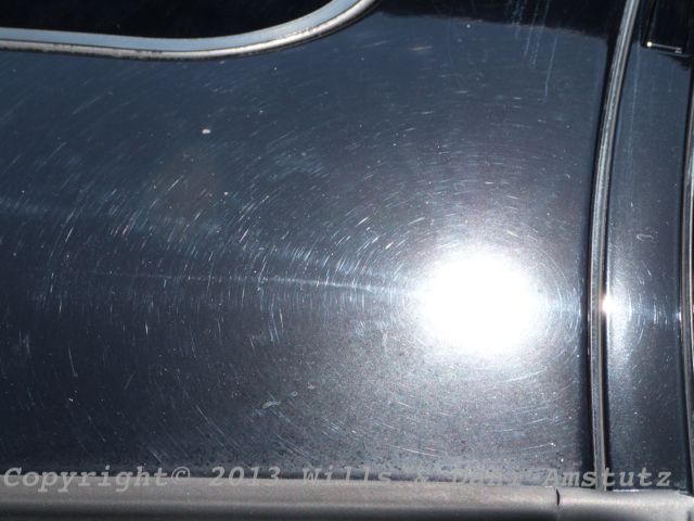

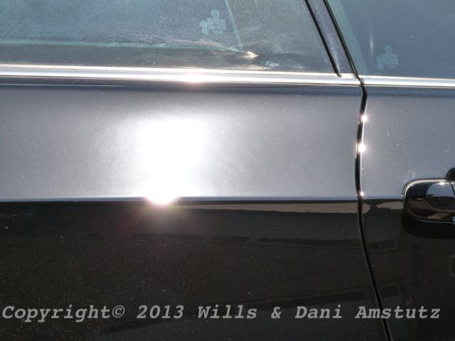

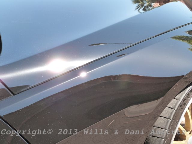

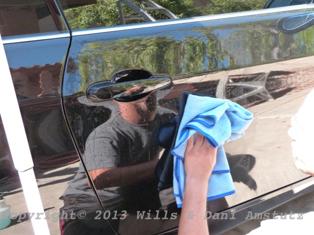

I got over to the passenger door and again was able to get some great 50/50 shots:
Haaa, this is just wow

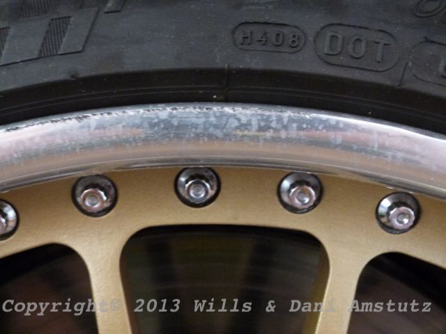

Dani still had this crap to deal with...nice staining and dullness:
By hand she went around and 1 by one polished each wheel (even though wheel polishing was not suppose to be a part of this detail...it would have made the rest of the work look bad if it hadn't been done). She also dressed tires and wheel wells. Rims came out lookin' nice:
Again, nothing we could do about the curbed spots...but the stained/dull look was gone and the wheels had some 'pop' again.

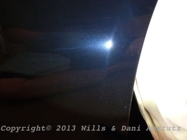

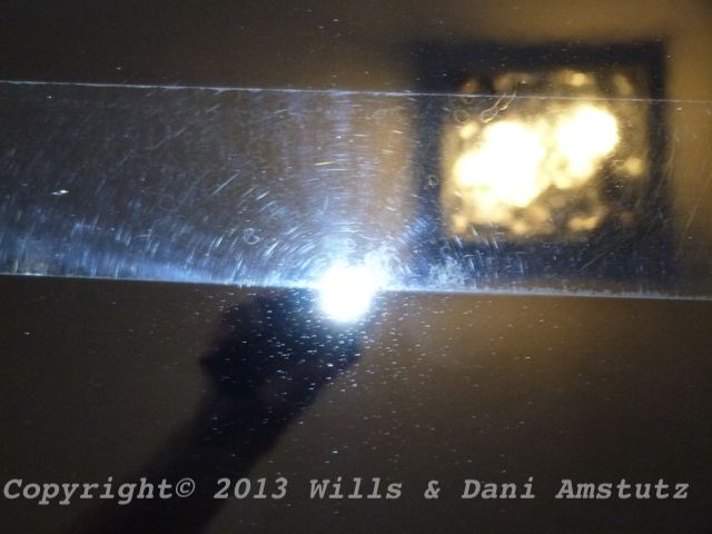

After i did my compounding pass, the paint was cleared up...but under careful LED light inspection you could see the marring left over from the microfiber pad:
This is what Dani had to chase after. I knocked the swirls down but she had to finish it off...and on paint thats jet black and difficult to finish down..thats no small feat to say the least.
Can you sayyyyy, concentration?

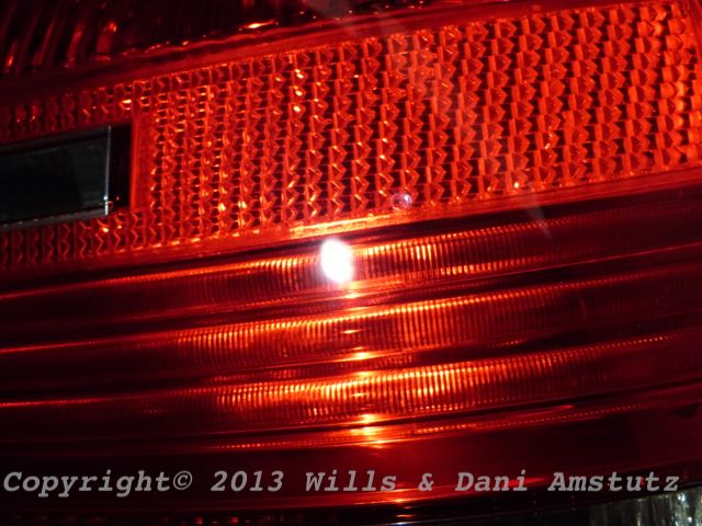

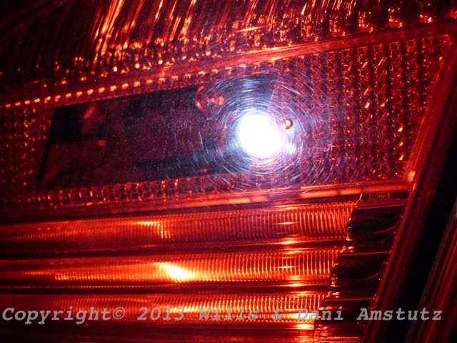

The lights go love too:

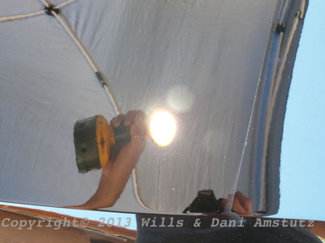

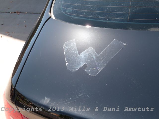

Finally got to the back of the car! I was feeling pretty good at this point and decided to have a little fun...so i taped off a "W" on the trunk (for Windows & Wheels) and polished all around it.
Rupes = awesomeness:

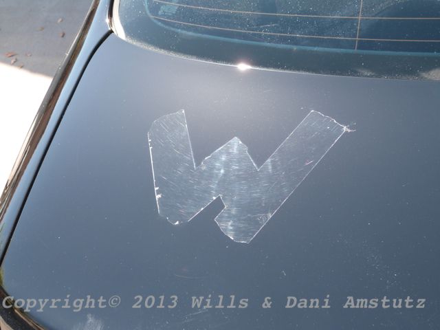

We branded it...haaaa!
HAD to pull it out in the sun for this one:

I forgot to get after shots of the tips but...you can kinda see them here...they DID have metal under all that grime!

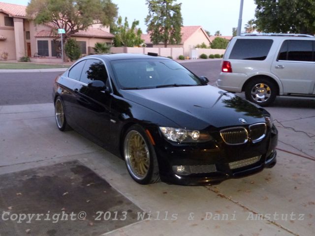

Before the sun totally set, Dani managed to grab a couple of photos before i started sealing it up and she started doing the final touches (door jamb, windows etc)
It was a bit dark and not the best 'finished' photos ever, but the owner said he'd snap some pictures of his own and send them over to us once he does..so i'll get them up as soon as i get them.
