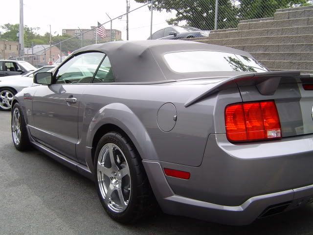

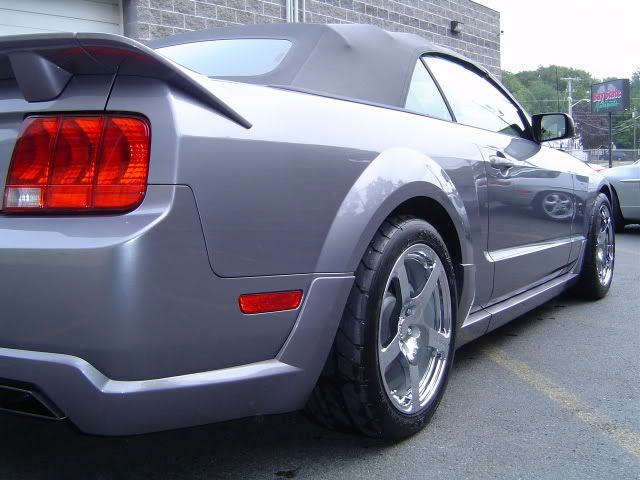

A friend of mine works for a local Ford dealership that is certified to sell Roush vehicles and asked me to perform a complete detail on this Mustang before the new owner took ownership.
The car is brand new, but it had a significant amout of decontamination on the paint from sitting out in the lot without any protection for months. There were some water spots on the silver stripes, which are vinyl and had some very minor acid rain damage on the top surfaces. The soon to be owner requested that the car to be sent to a professional detailer to be properly detailed before he took it home.
My process was:
Wash, clean wheels and tires
Cleaned engine compartment
Clayed with Kar Kraft clay bar
Compounded top surfaces with Optimum Hyper Compound using a yellow foam cutting pad
Buffed complete exterior with 106ff using a black foam finishing pad
Alcohol wipedown
Werkstatt's Prime by hand
ZFX'd Z2 Pro X 2
Z8 Wipedown
Werkstatt's Prime on wheels, followed by Opti-Seal
Opti-Seal on all exterior glass
Super Blue dressing on tires and wheel wells
Scotchguarded all interior carpets and floor mats
Meguiars Quick Interior Detail on all vinyl and leather

Joe- I did use a protectant on the convertible top, but I forget what the products is called. I bought it from my local Kar Kraft distributor. I switched to Raggtopp protectant because they discontinued the product. Sorry, I don't have any engine pictures. I just found one of my memory sticks with a few older details on it. I think that some of the pictures were deleted.

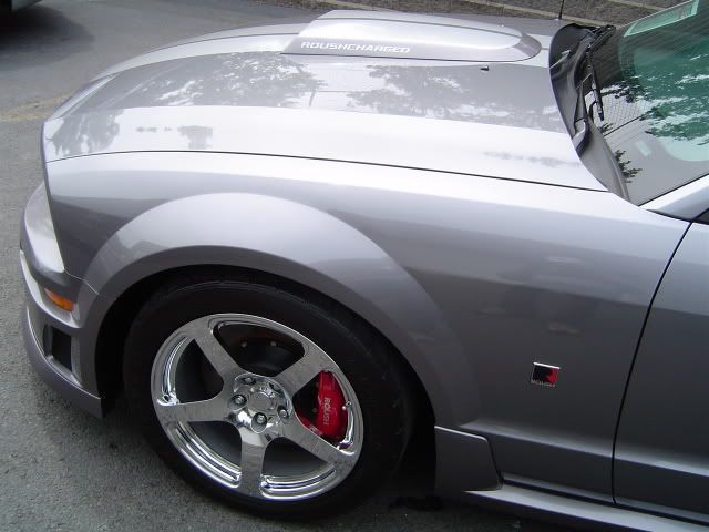

Nice car and work. I use to do warranty paint work for 5-6 Ford dealerships back in Michigan and I'd have to say that Mustangs are the worst for acid rain. I don't think I've ever seen a dark colored one that didn't have it! Very rarely was I able to remove the etching with just compounding (even with a wool pad). I'm glad your process worked for you. You need to have the Service Department put an acid rain claim into to Ford to get your services re-imbursed.

David- I worked at a Ford dealership for a short while and noticed there was a significant amount of vehicles with acid rain damage. What do you normally charge Ford for this? Luckily this particular car was not too bad. it had been sitting in the showroom for a little while, which helped a bit.
ZoomZoom- Thanks! I think if I was going to buy one, I would buy white. One of my friends has a 97' white Cobra Saleen with white wheels. It's a really sharp looking car.
Back then (4 years ago) they would pay $200-$300 without any questions. Think about inflation? Plus, it's alot cheaper than a repaint. You'd have to paint 2/3 rds of the car in alot of cases. Good luck.
Thanks for the info David. I'm sure you saved Ford a lot of money!
This detail was performed a few months back, so it's too late to put in any kind of claim for it. I will definitely keep it in mind for the next car I get with acid rain damage from a dealer.
