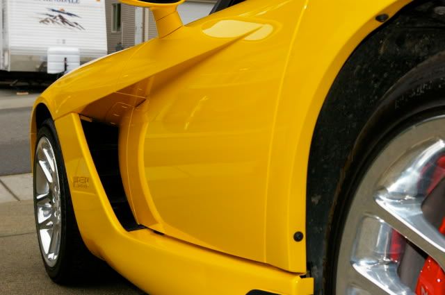

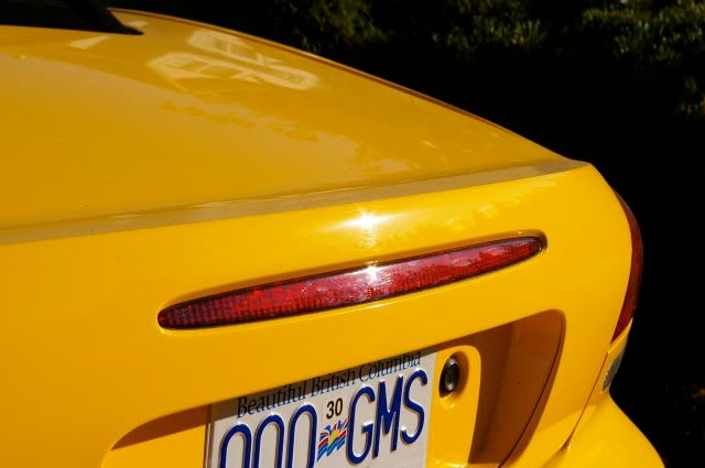

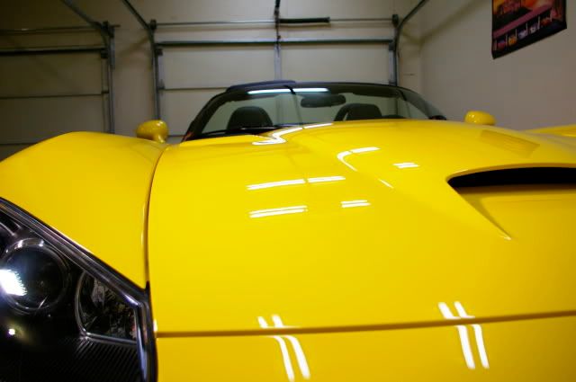

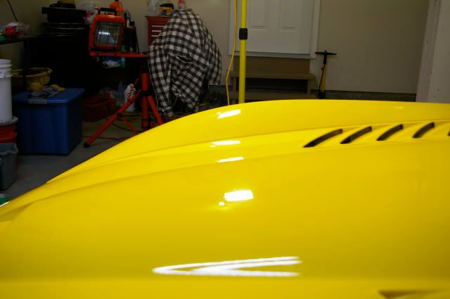

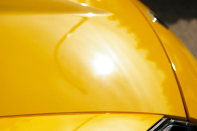

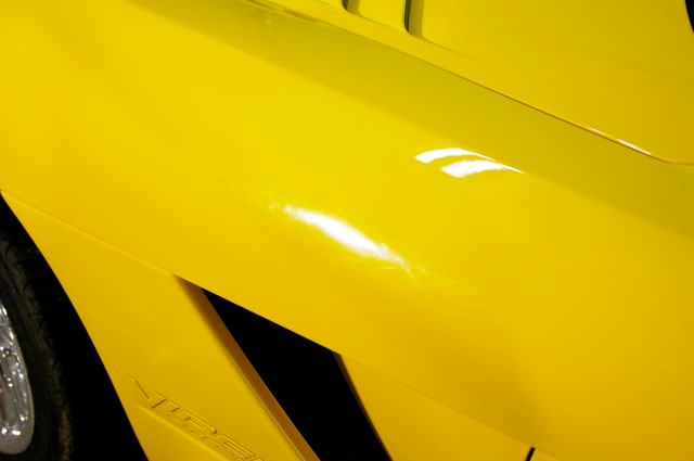

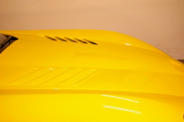

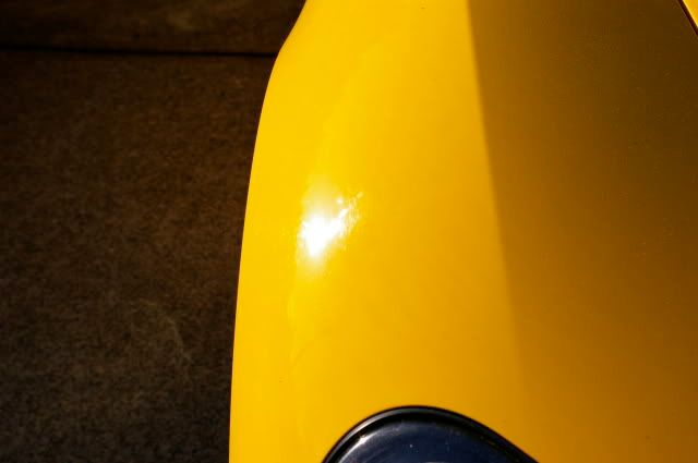

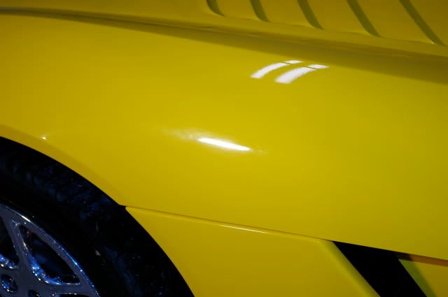

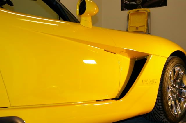

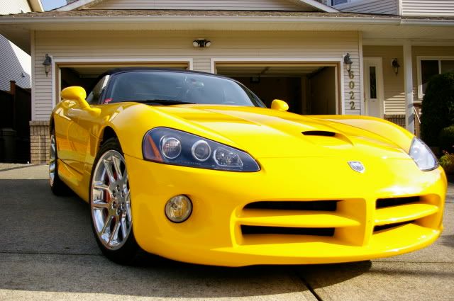

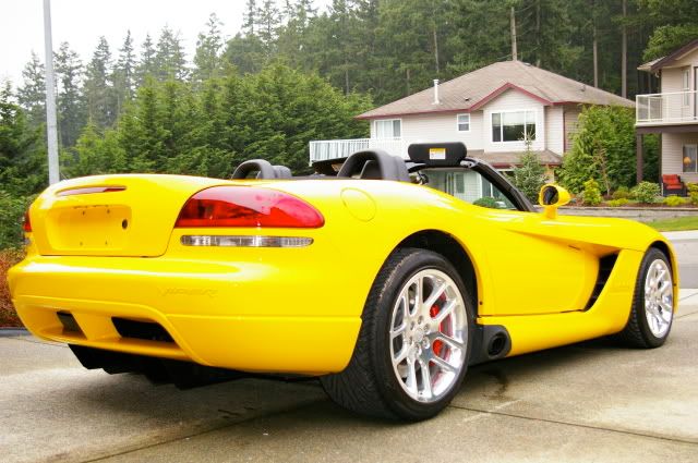

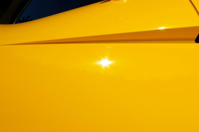

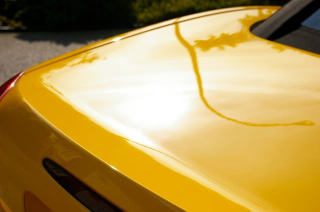

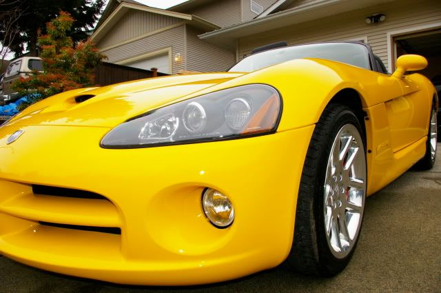

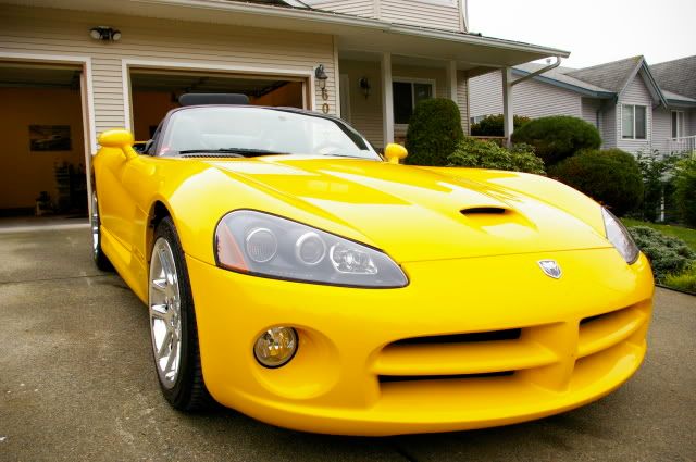

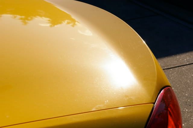

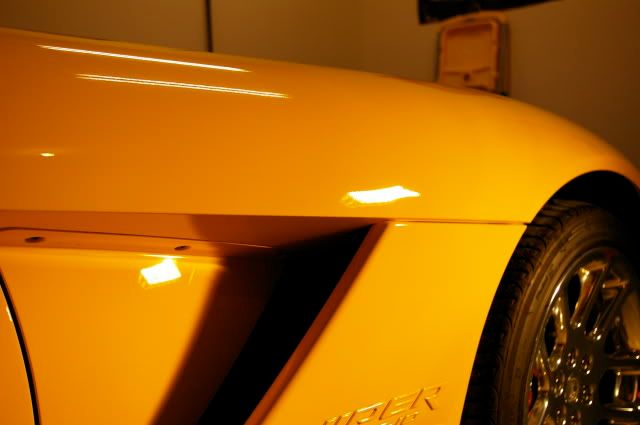

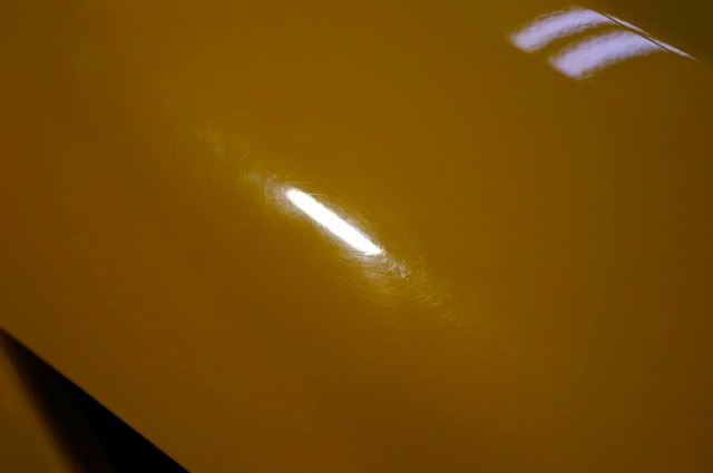

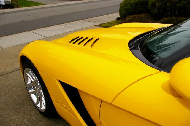

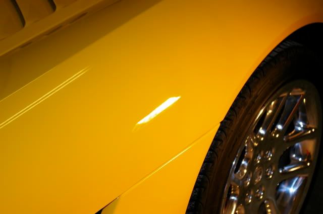

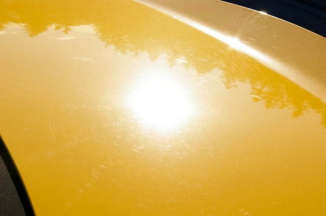

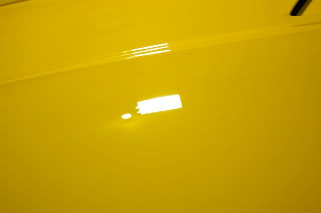

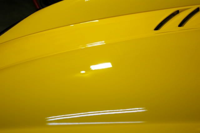

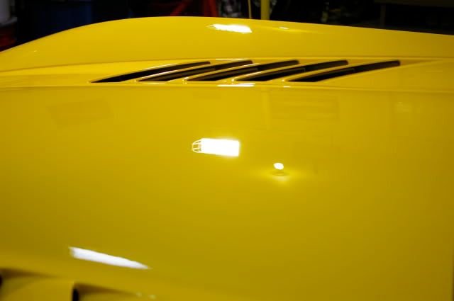

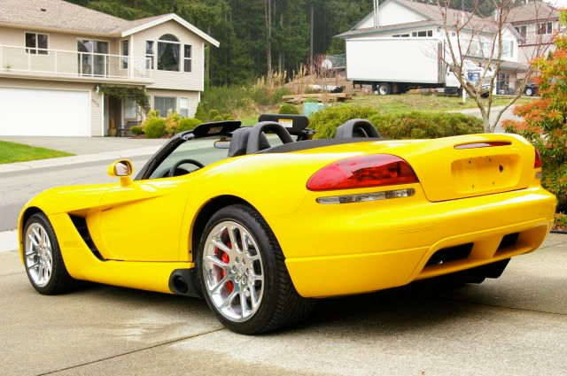

This is an 05 Viper with moderate swirls and almost no rids. Total time for exterior is about 10 hours. This was the first time using M105, WOW. This is one incredible compound. Cuts really quick and finishes like a polish. With the PFW it finished almost LSP ready, just a little hologaming but thats it. After 106FA it only got slightly glossier and a little wetter looking. I don't know if it will perform like this on other paints as well, but I am very impressed so far. Hopefully it stops raining so I can take it outside for some full shot's over the next day or so while I still have the car. I will post those if and when I get them. Any way this was the process.
Wash
Clay
M105 PFW pad @ 600-1800-1000 rmp's
106FA black LC pad PC speed 6
OCW

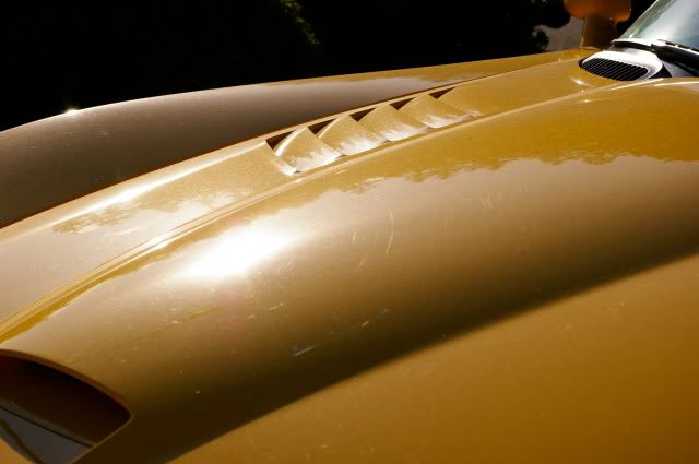

Before. It was sunny the day it arrived.
Wash
Clay
OCW
