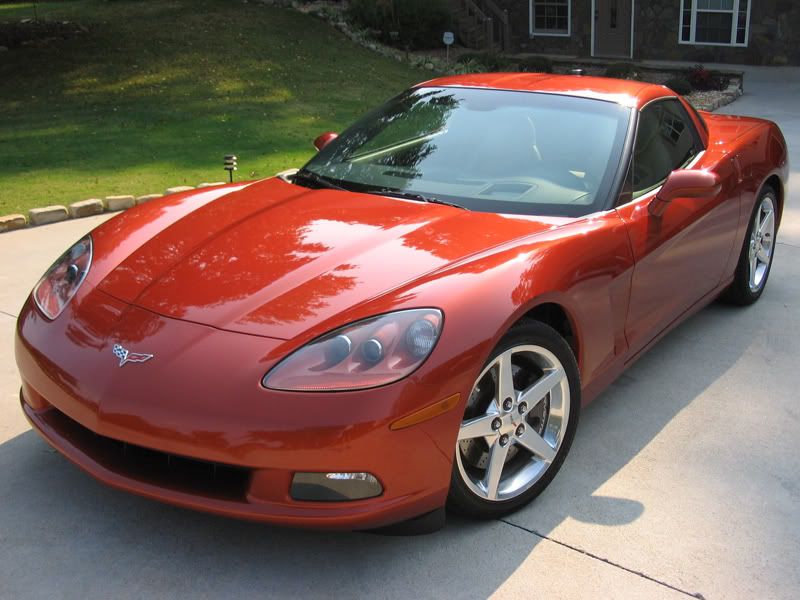

The vette had some light dust on it. So I went with a DP 4-in-1 wash. After that it was clayed, and brought back the shine.
Wheels & Tires
I used the DP 4-in-1 wash with the '16 deep reach wheel brush and a reg wheel brush. Toweled dry, applied Surf City's Black Tire Pro to the tires. And Optimum Opti-Seal to the rims.
Interior
It had tan interior, DP Carpet & Upholstery Cleaner on the carpets. This stuff works real well. Woolite/water mix on all other interior. Leather conditioned with Danase Leather Rx. Dash/ door/console received DP Interior Surface Protectant.
The Gameplan The reason I was called for this detail
She had a big bird bomb etching on the hood. And also it was covered in deep water etching too. So I went with 3M extra cut/ and OP. The OP keeps it from hazing. With the DeWalt and wool pad. After that was all done, went with the UDM and a white CCS pad. OP/106ff on same pad, two dabs of each. Wiped off with a Cobra Deluxe Jr. Finished with Z5pro, and Z-CS after.
The bird etching went bye bye. And the water etching was knocked out by 85-90%. Only from certain angle's could you see the water etching that remained.
I didn't want to remove too much c.c. The owner was happy with that, and plans on keeping the vette for a very long time.
