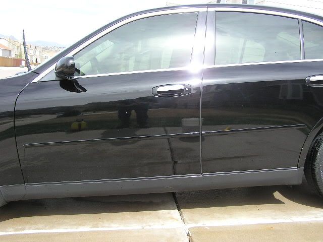

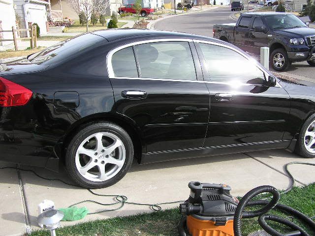

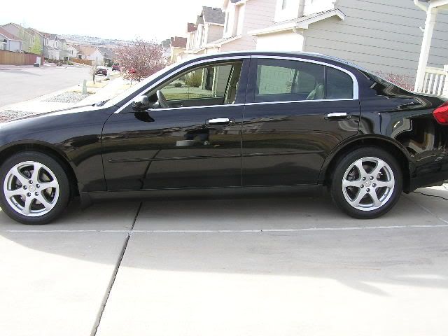

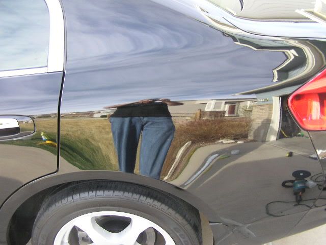

Car was pretty swirled up..The pictures don't show the severity. Had been through the swirlomatic car washes several times...
Washed
Clayed
DACP w/LC yellow pad
OP w/LC white pad
RMG w/LC black pad
EX-P by hand
NB w/red finishing pad
Had a hard time getting the swirls to come out....Thought they were out until the sun set and put the halogens on them...still some present....no where near as bad as they were but I was still disappointed. Customer was happy but I was not...I don't know what else I needed to do. I thought infinity paint was soft.

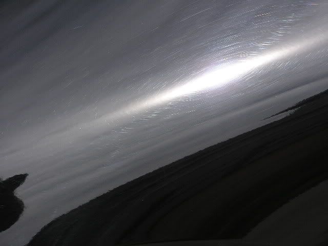

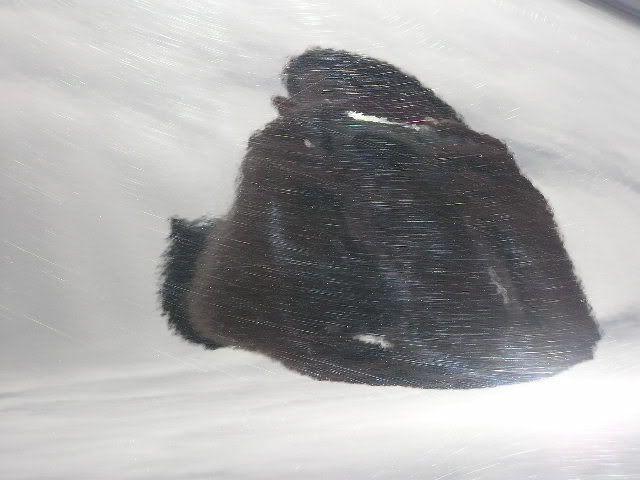

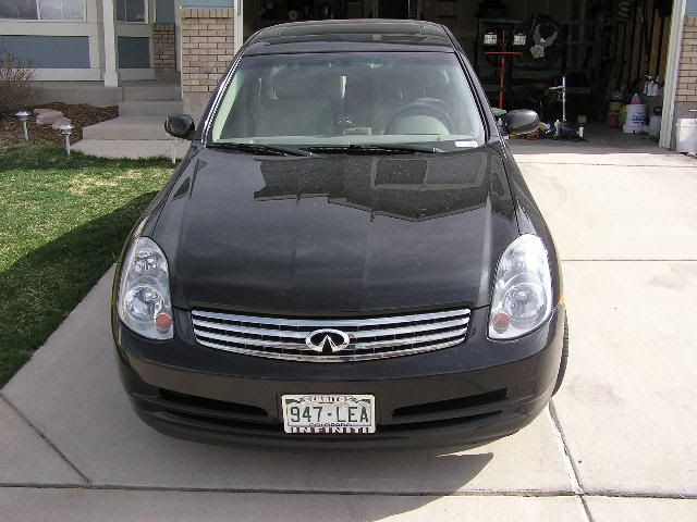

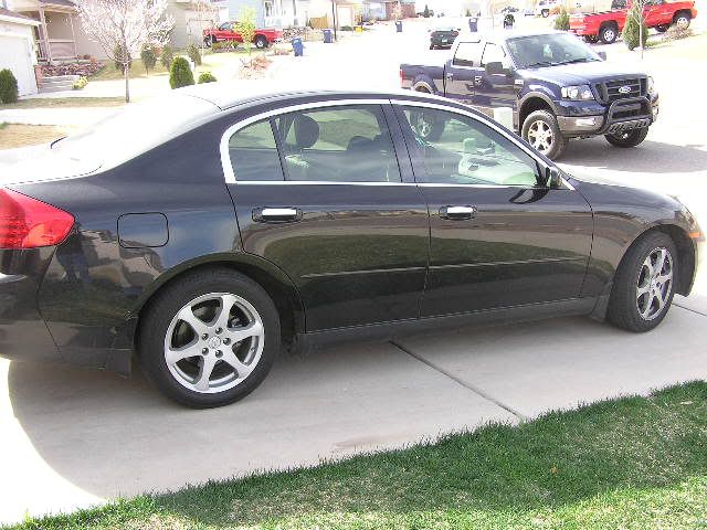

Here are the befores
[IMG]http://i78.photobucket.com/albums/j105/runnerbl/P4140239.jpg

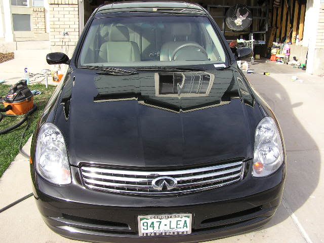

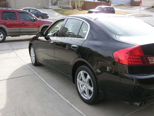

I agree...The car looks great. In the very last picture I noticed the exhaust, just wondering was it chrome? If so..some AIO would really make it pop...All around great job tackling those swirls! How do you like the cut of the Yellow LC pad? Do you feel it leaves a lot of micromarring?
Thanks...To tell you the truth I was so darn worn out I didn't pay any attention to the exhaust. I was happy with the yellow pad...That was the only pad I could get results with
You did a stand up job on those swirls. Was the owner happy? I think it looks great.
He seemed happy but again...I wasn't satisfied...I really need someone to get me some training on rotary use.
Looks really good! Infiniti paint does seem to be soft in that it mars more easily than other paint but swirls can still be tough to remove since you have to finese them out. I go through the same thing with them.
The paint looks very deep and wet! :up
However....I'd suggest using the free image optimizer on www.xat.com to resize your pictures. Whatever program you are using now is causing a lot of distortion and doesn't show off your hard work as well as a better program would. :)

Looks great from here.
What % of the swirls did you get out?
Any pics of what was left?
I would say 85% were taken care of. I didn't get any pics of what as left. Sorry
Any suggestions on how to finese them out easier. It wore me out trying to get them out. Maybe I am looking for unrealistic results...How are the images appearing distorted? Dont see it on my end. I am using photobucket as my image host. Thanks..
For left over micromarring you cant get out without instilling more try the 3M Perfect It III 05937..I picked some up a couple days ago and love it!! As for the pictures, when you resize your photos quality is lost sometimes, or the image becomes sweked. As it may be hard to see on your end, some people pick it up right away. I would second what Scottwax said..If you throw them into Xat, you can quickly resize all photos to 600 as your width, it will automatically set the correct height and you will be set to go in seconds. Also, if your photos are already resized you will get faster upload times at photobucket. xat makes it a breeze
