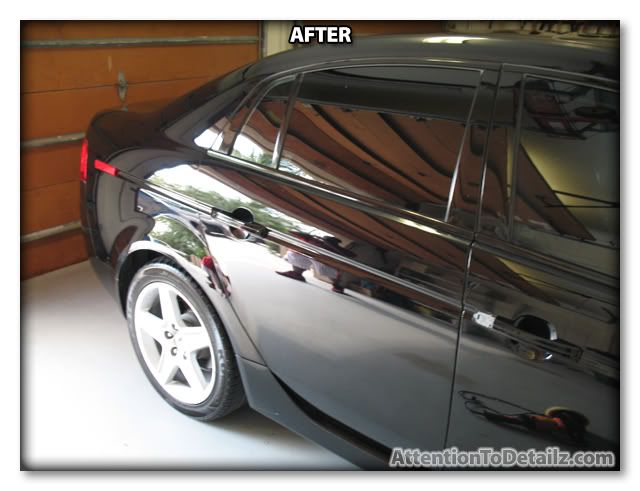

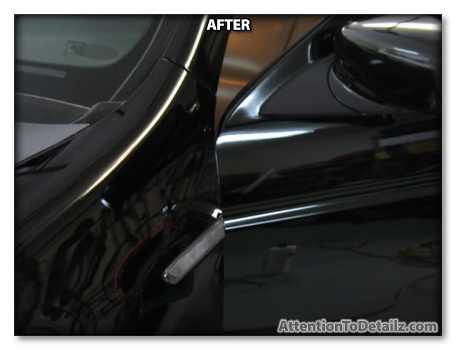

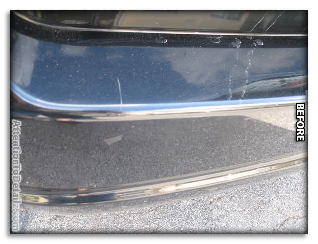

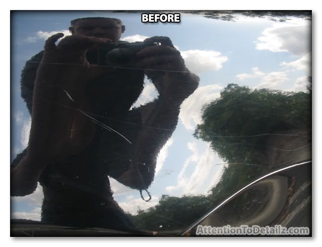

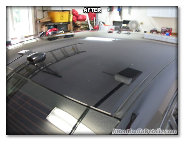

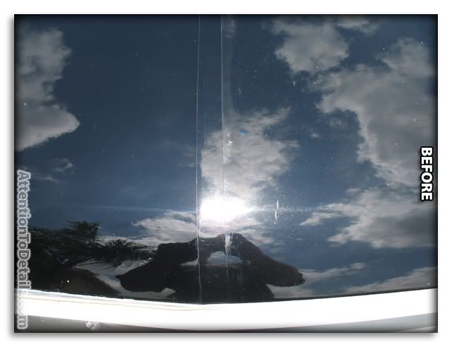

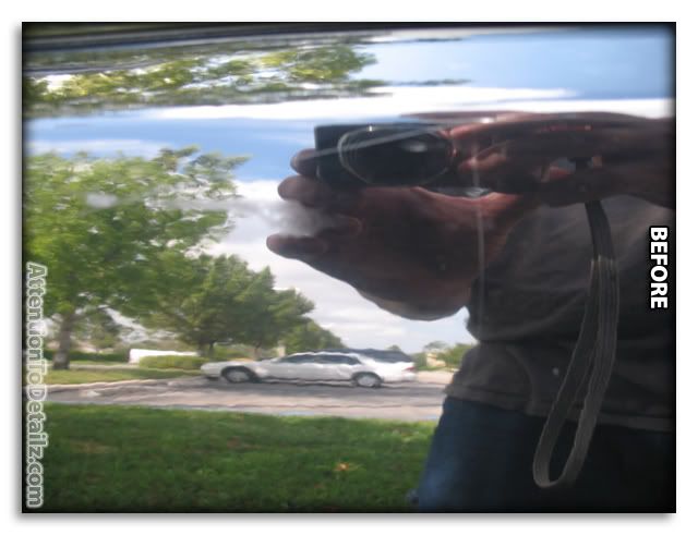

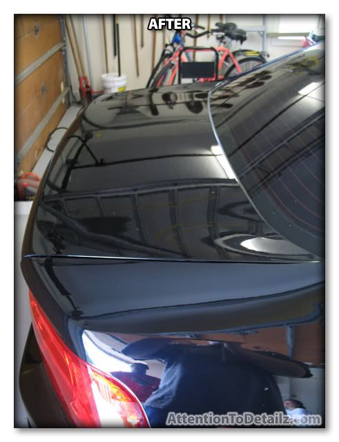

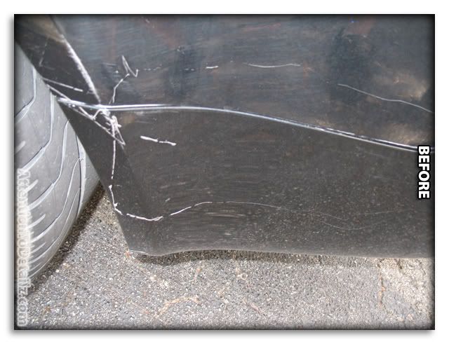

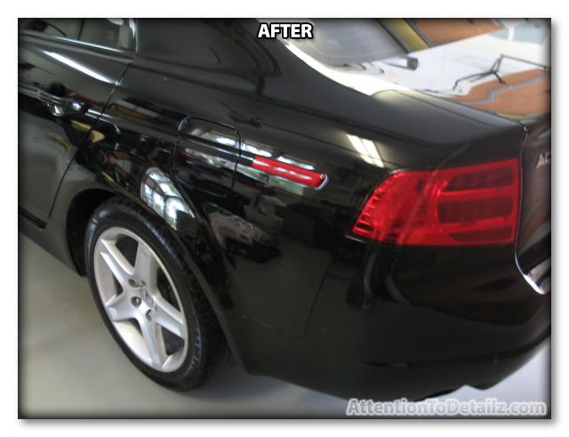

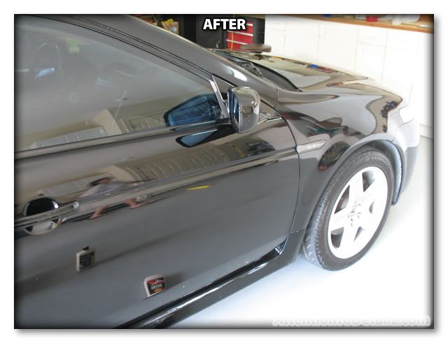

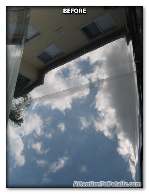

Did this one for FourG63 97GST (agim)'s gf. she's selling her car and needed it de-swirled/de-scratched. Went at it for a solid 5 hours roughly. Started at 10:30 am and finished up around 5ish.
He only wanted the paint worked on. Washed it himself and just had me do the paint correction.
I started with M105 Compound on a yellow megs diamond cut pad, followed by #82 swirl removal, then by a menzerna finishing glaze, then topped with NXT 2.0 wax.
Here's some pics:
I really like it. took me a bit to find out which pad it works best on (white), but I love it. gave it a really nice gloss before the wax, which gave it a deep shine :)
