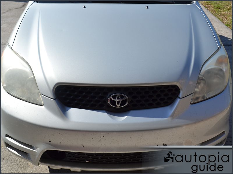

Start your headlight restoration by thoroughly washing the headlights and removing all dirt, grime, and debris. If you are working on your personal car then you can do this when you are washing your vehicle. If you are a mobile detailer, a bottle of waterless wash, such as BLACKFIRE Wet Diamond Waterless Wash, and a couple all purpose microfiber towels will come in handy.
The headlights on this 2003 Toyota Matrix have seen better days.
http://i184.photobucket.com/albums/x...toration/1.jpg
The headlights remain cloudy after a thorough washing.
http://i184.photobucket.com/albums/x...toration/2.jpg

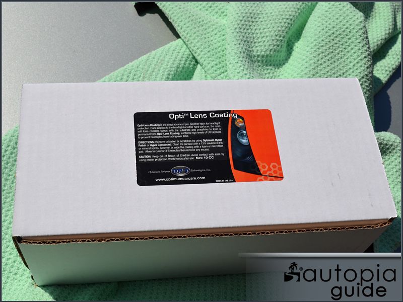

For a more hand`s-off and permanant solution to your headlight yellowing woes, consider a coating system designed specifically for plastic surfaces. Optimum Opti-Lens Permanent Headlight Coating is an advanced acrylic and co-polymer resin that provides extreme protection for restored (and new) headlights.
http://i184.photobucket.com/albums/x...oration/53.jpg
Inside the folded cardboard box is a syringe with 10cc`s of Opti-Lens, an applicator tip, a soft poly-foam applicator and a Gold-Plush Microfiber Towel.
http://i184.photobucket.com/albums/x...oration/54.jpg

End Results
The end results are nothing short of outstanding. The headlight housing looks almost brand new.
Compared to the un-restored side...

The atheistic difference is huge, with the restored headlight looking like-new. Like deep wrinkles across a forehead, faded and clouded headlight housings can make a vehicle look old beyond its years. More importantly, the restored headlight provides much better nighttime vision, for both the driver and for the driver of other cars.

Very nice write up Todd. Looking forward to trying the Opti-Lens coating.
