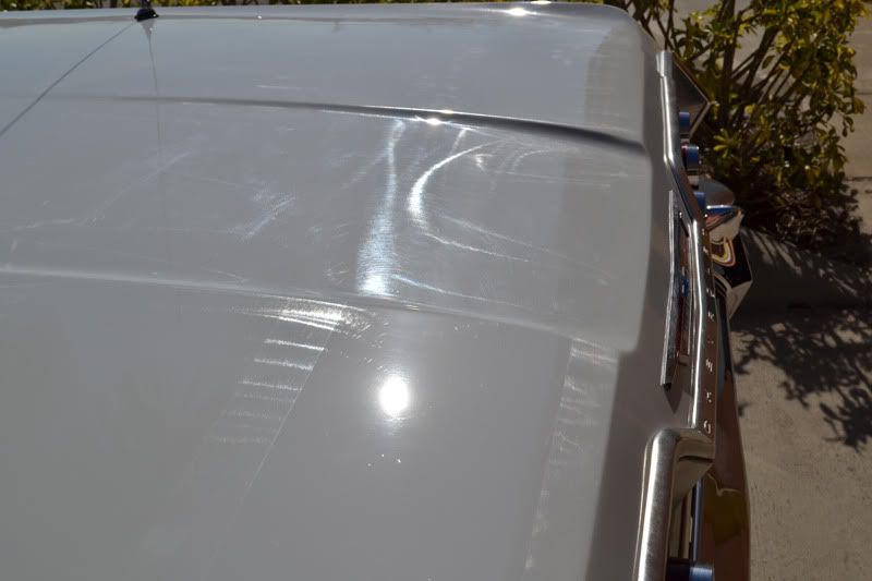

I started my testing at PBMG`s corporate offices. Mike Phillips had a friend in who had a very swirled out white car. I was in process of laying out the products and preparing the test panel when the opportunity to put both products to work on this mess presented...

I used Meguiar`s tape to mask off two test sections on the trunk of the car. On the right side (in this picture), nearest to the rear of vehicle, I used the new Menzerna FG400. On the left side (in this picture), towards the front, I used Meguiar`s venerable M105 UCC.

Being unfamiliar with FG400, I decided to test both products in a similar fashion. I applied 3 dimed sized drops around the outer circumfrance of the pad and polished on speed 6 using firm pressure. I continued working both polishes for approximately 1 minute, then wiped clean.

To revel the results we pulled the Impala into the sun. Up first, the side polished with FG400.
http://i184.photobucket.com/albums/x...megvmenz/8.jpg
And to the left, the side polished with Meguiar`s M105.
http://i184.photobucket.com/albums/x...megvmenz/7.jpg
Both test sections had noticeably more gloss. The side polished with Menzerna had slightly less defects visible.
http://i184.photobucket.com/albums/x...megvmenz/9.jpg
In the following, and for the rest this review you will notice that Menzerna will be compared directly to Meguiar`s. This is because, in many ways, Menzerna is a the new kid on the block. Another way to look at it is in terms of athletics. Menzerna FG400 is the challenger; Meguiar`s reputation in this segment of polishing is well established. Think of Rocky Balboa going against Apollo Creed. Will the challenger displace the champion? Will we have a knock out, a split decision, a majority draw?
My initial impression of Menzerna FG400, compared to Meguiar`s, was just how different it was. While Meguiar`s Mirror Glaze Polishes have a slightly almond, slightly chemical smell, Menzerna smells like it is all business. While the scent is not overwhelming it is definitely chemical in nature.
