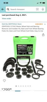

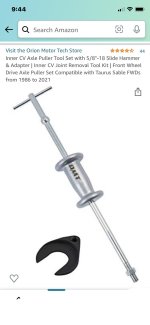

So this what I got give me your opinion. The hub grappler looked alittle better but was $500-$600 this was $300 I have done wheel bearings in over a decade where I did them also have cv axels I’m replacing I’ll attach that tool below too it was $50 if they don’t work I’ll ship them back.
next question which bearings?….Timken or Moog or other?

Both have a good reputation. I have moog on my Grand Prix that I swapped out myself and they have done well over the years.

Wheel bearing come in variety of prices and corresponding quality build and materials that reflect those prices. Attempting to save a lot of money on bearings by buying something that is "cost-effective" or "budget friendly" is a recipe for disaster. This is one of those cases where "you get what you pay for." I would still buy USA-made bearing if possible, BUT Japan, Germany, and Sweden (think SKF) make high-quality bearings with corresponding higher prices. You`ve put in all this work to get to this point. Don`t skimp on the bearing cost.
Since you`ve mentions F150 trucks as one of the vehicles you will/are working on, do you know if anyone makes a heavy-duty bearing, like Moog, that you can upgrade from over the OEM bearings?? And is there a special synthetic bearing grease that can be used to pack these bearings with??
