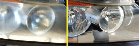

Hi all. I restored the headlights on a recently-acquired 2007 328i. They were bad. I used the 3M restoration kit to decent effect:
https://www.autopia.org/forums/attac...id=37010&stc=1
I masked (30 minutes) then sprayed (< 1 minute) the Meguiar`s Keep Clear Headlight Coating per instructions. Results were mixed. One light came out fine, the other was unacceptable. It was cloudy and irregular. The next day I lightly sanded it with 3000 grit wet, then polished with a blue pad and Menz 3800. This fixed the cloudiness and high spots. I re-applied the coating and it worked fine this time.
https://www.autopia.org/forums/attac...id=37011&stc=1
https://www.autopia.org/forums/attac...id=37012&stc=1
There`s a slight yellow tint to these cell-phone images. Disregard that. The coating did NOT yellow the lenses. You can, however, "tell it`s there". it`s no big deal on this car, but it`s not something I`d use on an expensive or prized show car. Instead, I would just apply a good sealant once a month. However, this is supposed to last a year ------ > we`ll see!

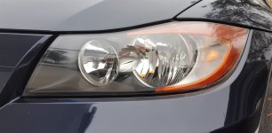

Here`s a clear photo of the restored and coated lens, after two days of curing. I`ll update later in the year. If you`re reading this by late summer 2020 and I haven`t updated it, please send me a message. I`m very likely to forget.
https://www.autopia.org/forums/attac...id=37016&stc=1
Re: Meguiar`s Keep Clear Headlight Coating Test
Geez, it looks great! We will all be watching for your future reports on longevity.
