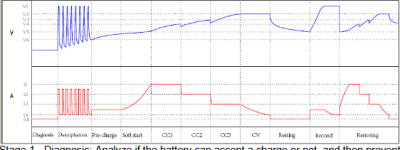

So, lo and behold, my last time at Costco they had an Energizer branded, made by Intertek "4A 9-step smart charger with LCD display" for, like, $25.
It`s this: https://www.energizerpower.com/product/enc4a/
The instruction manual has some translation errors, but it does 2A/4A, 6V/12V, detects sulphated batteries and runs a desulphation program (although it appears you cannot put it in that mode manually which is a bummer to me), and documents fancy-pants graphs (included below) regarding their 9-steps, pulse charging, bulk charging etc... To be honest, it all sounds very much like CTEK and NOCO, but google finds me no one actually comparing these chargers to anything else.
https://www.autopia.org/forums/attac...id=35497&stc=1
So, I`m wondering - is this a case where I can get 85% of the functionality for 25% of the price and I should take the "Energizer" charger from Costco? Or is there some clear superiority to either CTEK or NOCO? I realize that simply having a charger and using it semi-regularly puts me ahead of 95% of the folks out there. I don`t see any indication of an AGM mode, but it has a "cold mode" which I believe boosts target voltage from 14.6VDC to 14.8VDC which is the AGM max. CTEK talks about sensing high and low temperatures and adapting it`s charging, and has a dedicated AGM mode. ...or is that all just marketing?
