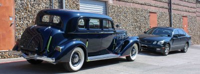

Does this look wet enough?
https://www.autopia.org/forums/attac...id=35485&stc=1
This is bare paint, FK1000P is to come.

This is one of those things that I can`t evaluate from internet (or other) pics, I`d have to see the vehicle in person under the right conditions to even venture an opinion. It`s *that* subtle (and maybe even that subjective, but I could argue that either way). Anyhow...

Interesting...much as I love FK1000P, to my eyes it gives the exact *opposite* if the wet/deep/jetting look. Switching to it from 476S diminished those characteristics dramatically, imparting a whole appearance that some would say was like a completely different paintjob. On a Classic, where IMO the objective should be to maximize the "this is old single stage paint" look, I`d lean towards at least topping it with something like their Pink Wax.
If I ever do get the Jag out of mothballs, I honestly don`t know whether I could stand seeing it with (only) FK1000P on it. And that`s a color that some would describe as "silver".

I know how to make FK1000P look wet... This classic was also repainted in the early 90’s or late 80’s with base coat/clear coat.

I have zero doubt :D Guess my reply was more for anybody looking to this thread for ideas.
I`m curious about what you have planned for it :D
Ah, yeah...a lot of `em got switched over to b/c, and I figure that`ll continue since there`s so little good ss out there now.
Trying to tone down the "b/c look" on my pal`s Jag took a little doing...and I bet that nobody else even knew what I was talking about!
