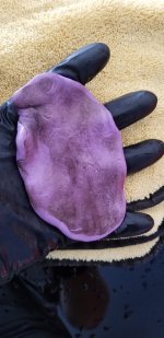

Ok, so I made at least some progress with a combination of tedious mineral spirits q-tip applications, thoroughly washing it to get it all off, and following up with multiple passes with clay. It`s still there and clearly visible, but a little bit less so (there`s definitely etching left behind, though). I`ll take a few photos tomorrow in the sunlight.
At one point, I did try an aggressive clay bar on a small section of the bumper to see if it`d be more efficient/have a better effect. There`s a photo of that clay after multiple kneadings on a small ~12x6 inch area. I`ve seen dirtier clay, but (1) not after so small a section and (2) not after chemical decon. The photos definitely don`t the contamination justice. I didn`t use the more aggressive clay after that because the marring was just too much, which turned out to be a very good decision. Because afterwards, I took out my paint thickness gauge. At some point (factory, dock, or dealer when it was used as a demo car for ~6k miles), a good bit of clear was removed from the hood.
