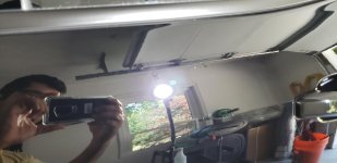

A few before/ after shots. These are just after perfecting cream and rupes yellow pad:
https://www.autopia.org/forums/attac...id=34717&stc=1
https://www.autopia.org/forums/attac...id=34718&stc=1
https://www.autopia.org/forums/attac...id=34719&stc=1
https://www.autopia.org/forums/attac...id=34720&stc=1
https://www.autopia.org/forums/attac...id=34721&stc=1
https://www.autopia.org/forums/attac...id=34722&stc=1
https://www.autopia.org/forums/attac...id=34724&stc=1https://www.autopia.org/forums/attac...id=34725&stc=1

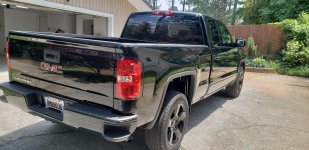

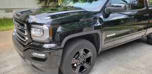

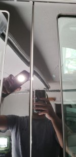

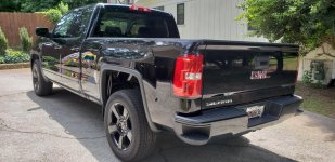

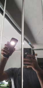

Finished shots:
Showing my Mother-In-Law that reflection because she said the car looked really good after the wash/ decon and didnt get why it needed paint correction. I had to show her the truth. hehe.
https://www.autopia.org/forums/attac...id=34723&stc=1
https://www.autopia.org/forums/attac...id=34726&stc=1
https://www.autopia.org/forums/attac...id=34727&stc=1
https://www.autopia.org/forums/attac...id=34728&stc=1
https://www.autopia.org/forums/attac...id=34729&stc=1
https://www.autopia.org/forums/attac...id=34730&stc=1
https://www.autopia.org/forums/attac...id=34731&stc=1
https://www.autopia.org/forums/attac...id=34733&stc=1
https://www.autopia.org/forums/attac...id=34732&stc=1
