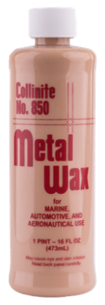

1 Attachment(s)
Re: cleaning chrome steel wheels
This works very well`
https://www.autopia.org/forums/attac...id=34504&stc=1
Easy to use polish restores, shines and protects in one single operation.
- Removes mild rust, salt deposits and heavy film
- Leaves behind radiant, durable wax coating
- Protects against future corrosion and pitting
- Available in 16 fl oz and 64 fl oz
