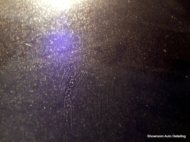

Ok, heres what plagues the whole car and leads me to believe that the marring and superficial scratches could have happened with their wash. You can clearly see the dried on dirt from their towel trails going in all different directions. This shows that they were drying a contaminated car, no? Actually looks more like ShamWow marks or a chamois.
http://lh4.ggpht.com/_SJ4i3ao0jME/S4...0/100_6237.JPG

Ok, do you guys think these marks could be made from basically sanding all that dirt in with a chamois or towel?

Honestly, other than looking like it was dirty and someone sprayed water on it and dried it, you really can not see any scratches. Yes on some shots you can make out a few light swirls in the paint that would be there from 6 months time. You would need to rewash the car get some pure shop light, halogen or sun shots of the paint to really see the damage.
Also your first shots really dont know anything more than reflection shots. So you really dont have much of a comparison other than clean vs. dirty. Until you can find your first light/sun shots vs. it rewashed and under some lights/sun.

I respect your opinion, but the angle and lighting I used was to capture how the car was basically washed with a bucket full of dirt and glass. If you look above the door handle you can`t see the damage. That wasn`t there before. Also see the sun gleaming off the hood in one of the shots from the side. The sun was high in the sky and burning on the car when those were taken. If she had told them to wash it and knew better than it would be different, even though anyone putting out work like that should quit the business asap. I have plenty of shots that show the new defects and I`ll post them when I get to my computer. Another thing is the guys who washed it looked at it in that condition and stood by there work saying they use the best products. I hope you can understand why I`m a more than a little heated over this, sorry If I`m coming off rude, no offense.

It looks like they gave it what I call a whores bath. They sprayed it down and dryed it. The prob is it looks like they did it with a muddy chamios, and the mud is what did the damage. You and I both know these super high volume shops don`t have time to rinse out their chamios and wash buckets after every vehical they do. As for them paying for the damage...unless the lady gets a lawyer and takes the case to court, it probobly won`t happen. If they were an upstanding company they would do everything they could to keep this from getting out and risking their reputation over something like this, not to mention a thing called customer satisfaction, no matter how big or small the job was.

IMHO, there are several shots that look like poor wash/drying technique induced marring/scratching. A friend of mine just did the same thing to his show car and it all looks like what you have above. I had did a full detail on the car for him in November and he decided it needed a wash. Almost immediately after, he called and I went over and looked at it and it looks almost like what you have posted. Albeit, he did clean it better than what`s in your shots.
As far as the other detailer goes, your client should push them to pay for the correction. I doubt seriously they will and there`s not much she can do short of small claims court which is probably more of a hassle than it`s worth. But if they have a kiosk in her building she can gently remind them that word of mouth bad publicity does and will hurt their business. And she has every right to give her opinion to anyone who wants to listen about how poor the service was she recieved.

The wash job is pretty poor by our standards but pretty much par for the course for production work. Maybe they ARE the "best" around compared to other production car washers, but that`s really not saying much. I`ve corrected MANY cars that were subjected to so called "best" detailers.
