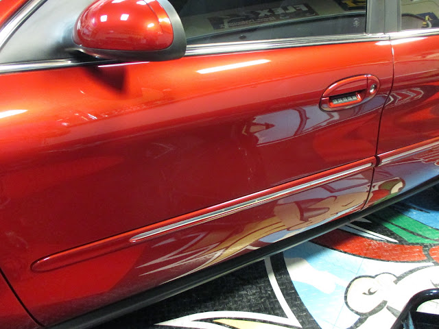

Here`s the vehicle before washing. Not too shabby since I wash and waxed the car 5 days ago.

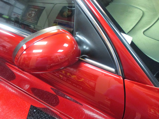

Before applying any coating, it`s recommended to remove any defects from the paint. The Toreador Red Pearl Metallic did a great job of hiding imperfections. I used my FLEX Swirl Finder Light to inspect the true condition of the paint.
I decided to use a RUPES LHR15ES to try out the new Lake Country HD Orbital Pads. I started my test spot with the orange polishing pad with BLACKFIRE SRC Finishing Polish.

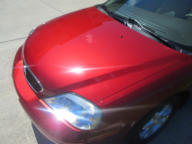

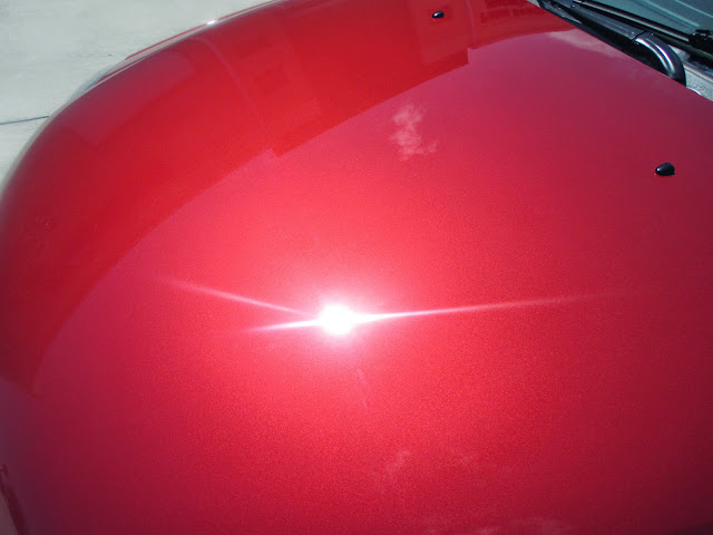

I decided to use the kit "as-is", so I used the round yellow applicator pad and Gold Plush Jr. microfiber towel that are included with the kit. After applying Gloss-Coat to the roof, my initial impression was that Gloss-Coat seemed slicker and thicker to apply compared to any previous application of Opti-Coat 2.0. The applicator slid across the paint easier and the product spread out farther than I ever remembered Opti-Coat. It seemed more "substantial", if that makes any sense. It was easier to see which area had been coated.
The gloss was amazing. The paint seemed dripping wet.

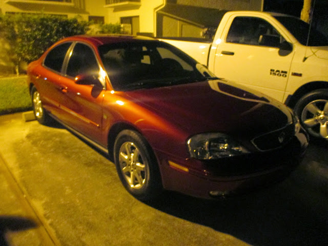

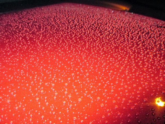

Later that night, I went outside to check on the car and noticed I parked a little too close to a water sprinkler. The rear bumper and trunk lid were wet. Luckily the Gloss-Coat was allowed to cure for 10 hours in extremely strong daylight before the rear got wet. I wiped the area down with ONR (QD dilution) to avoid and water spots. But I was able to get some early beading shots.
