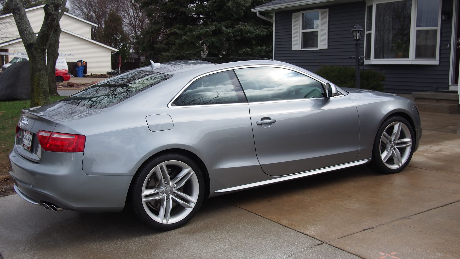

Well I will see how my car holds up. I did a 2 step with 3500 and a hydro tangerine pad 4~6 passes and followed up with 4~6 passes with 3800 on a crimson pad. I then just finished putting on CSL and 2 coats on exo on Monday (it was a long weekend for me.). Then I had 2 appointments at the VA on Tue and had to leave while it was still raining. The worst part is I can`t wash till next week. Picture is just as I pulled it out to leave.
http://i1068.photobucket.com/albums/...9.jpg~original
