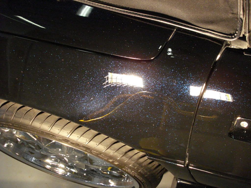

As you will see from the photos below, the car had a severe case of swirls and deep, long scratches in the very hard Corvette clear coat. I knew that it was going to require a tremendous amount of work, but it would look stunning once properly leveled and polished out. We opted against a lot of wetsanding, and knew that it could only be brought back to about 90% of new without it, but at that rate it would still look better than most vehicles on the road. You can quickly achieve a point of diminishing returns on paint correction, so it is important to establish goals and expectations with the customer, as well as the budget that they have to work within. A 90% correction on this was 17 hours’ worth, whereas a 98%-100% could have taken 30+ hours.
Now that we’ve established a bit of history as well as goals, let’s go through the inspection to see what we have to work with.

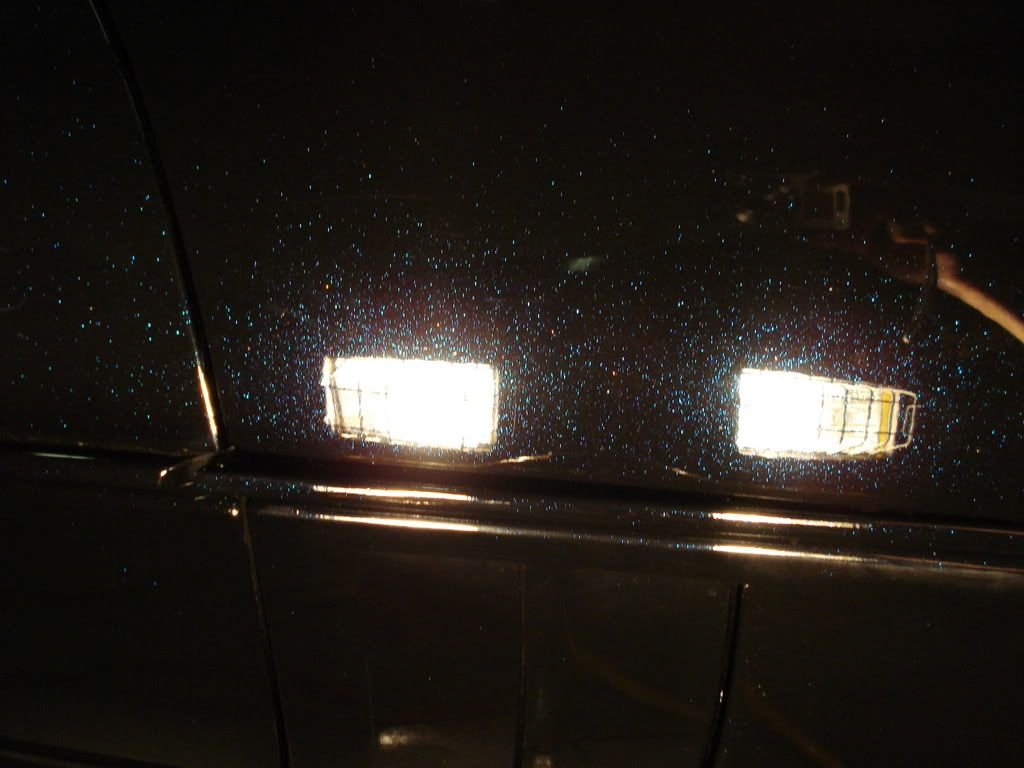

When you have a black car with a notoriously hard clear coat like the Corvette, and it pulls up looking like this, you know you have some overtime to work! Swirls this severe will hide the true color (especially on black), and in this case they made the car look charcoal-grey.
There were holograms mixed throughout as well.

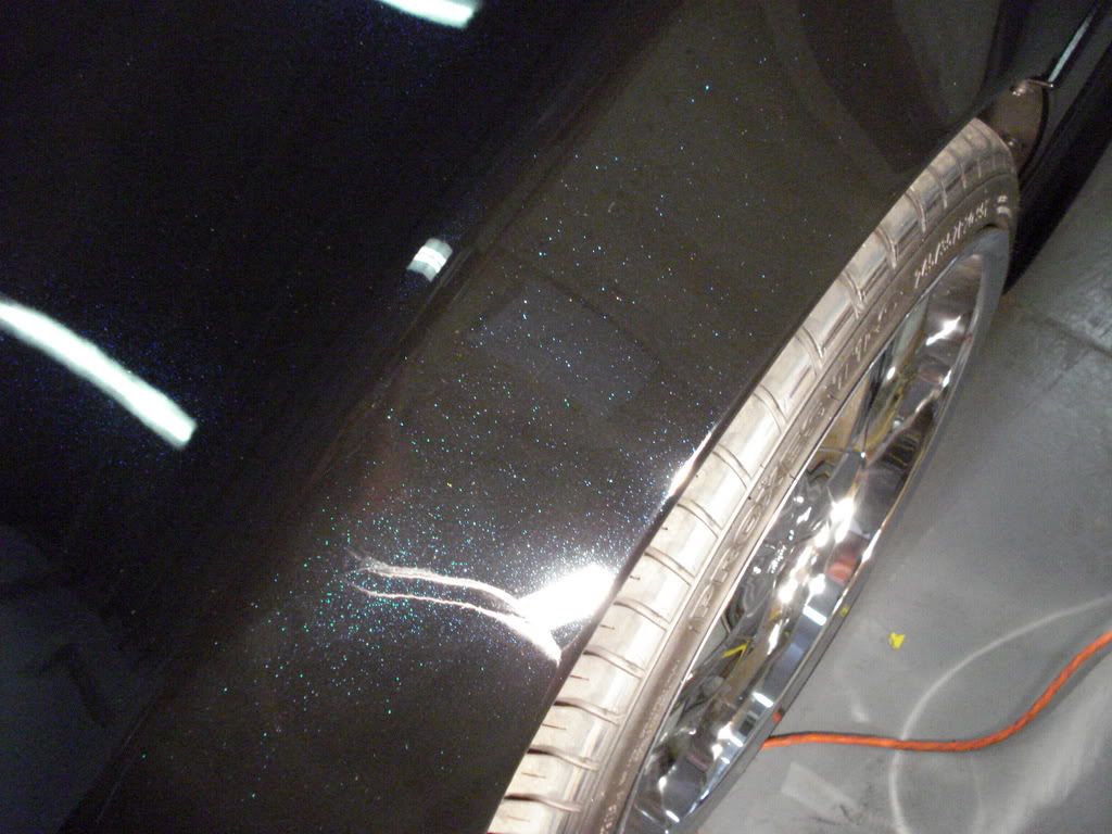

Here you can see where somebody tried to spot-fix a problem, and did more damage than good. Look at the hazy spot in the center of the photo.
The hood was exceptionally bad. You can tell where somebody had attempted to polish the hood in the past, but gave up…leaving a hazy finish. This area would require more work than the rest!
So now you have a good idea of the amount of work that lies ahead.

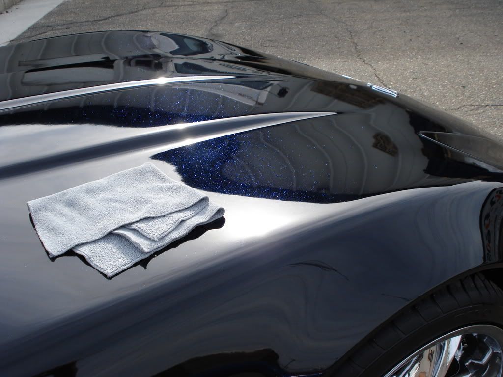

For the plastic back end of the vehicle, I used my PCXP with an orange pad and Megs 105. This combination did a good job of cleaning up the defects.
If you look closely you can see some sizable scratches mixed in with the swirls. The whole car was covered in these.
I hit this section 3 or 4 times with PFW/105 to clean it all up (sorry for the fuzzy photo)
After compounding, you can tell that the color has been restored already. Clarity will be brought out when I come back around for finish polishing.
Megs 105 around a lot of taped edges means dust…lots of dust!
Once I was finished with the compounding stage, I washed the car again to remove all of the dust and carrier oils and got it ready for polishing.
For the next stage, I used Menzerna Power Finish on a white pad with the Makita rotary. Power Finish provides almost as much cut as SIP, and does a tremendous job of restoring clarity on the hard Corvette clear. Since it finishes down almost as fine as 106FA, having it combined with a white polishing pad left the finish LSP ready. If it were softer black paint however, I would have finished it down with 106FA instead.
Since the hood was in such bad condition, I went with a slightly different combination. After compounding with M105/PFW, I went with SIP/orange pad, then 106FA/white pad. Since I wanted to extract as much gloss as possible out of it, I then finished it up with PO85RD and a blue pad.
Here’s a peak at the hood when I took it outside for an inspection after the 106FF/white combination. Don’t worry about the polish smudges…I haven’t gone through the cleanup stage yet.
After all the polishing was complete, I wiped it all down (again) with IPA, did all of the finishing touches, applied a coat of Optimum Opti-Seal, and then buffed it out with Optimum Spray Wax.
Are you ready to see the transformation? On a few of these I’ll take you back to what it looked like before so you can get a real appreciation for the change.

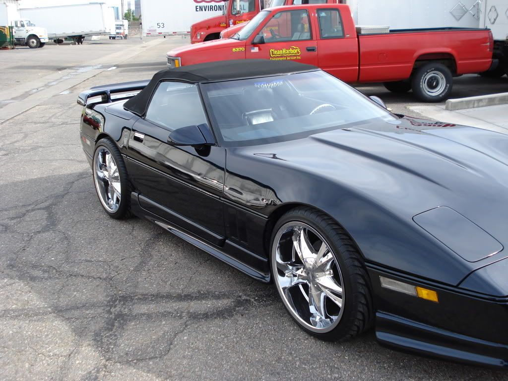

I wanted to take a few moody shots, so I pulled it back in the garage and liked what I came up with.
And the last few…
The owner was absolutely floored by the results, and after spending some time teaching him about the after-care of his new Vette, he looks forward to keeping it looking this nice for many years to come.
Thanks for taking the time to review my work. Total time on this exterior-only job = 17 hours.
