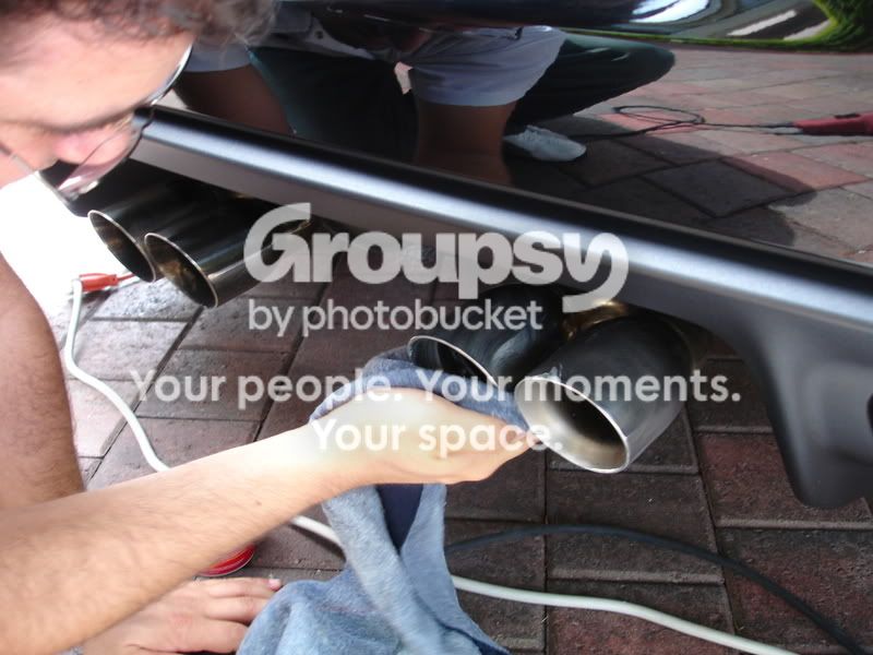

• All chrome and metallic surfaces cleaned and polished using Swissvax
Metal polish.

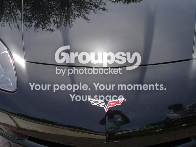

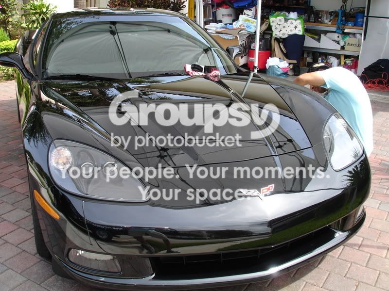

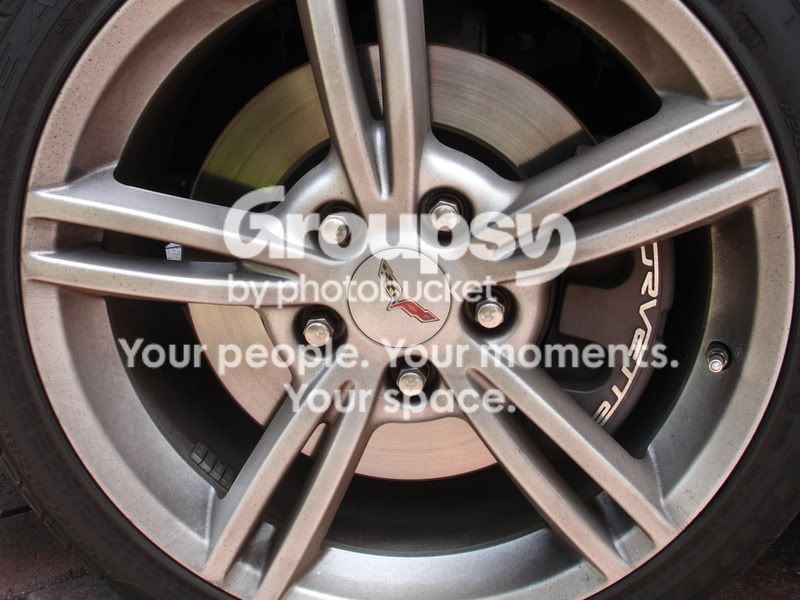

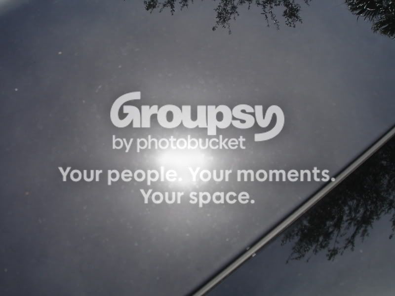

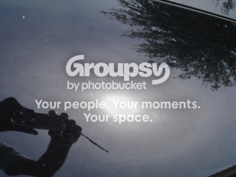

some before shots
[IMG][/IMG]
[IMG][/IMG]
[IMG][/IMG]
[IMG][/IMG]
[IMG][/IMG]

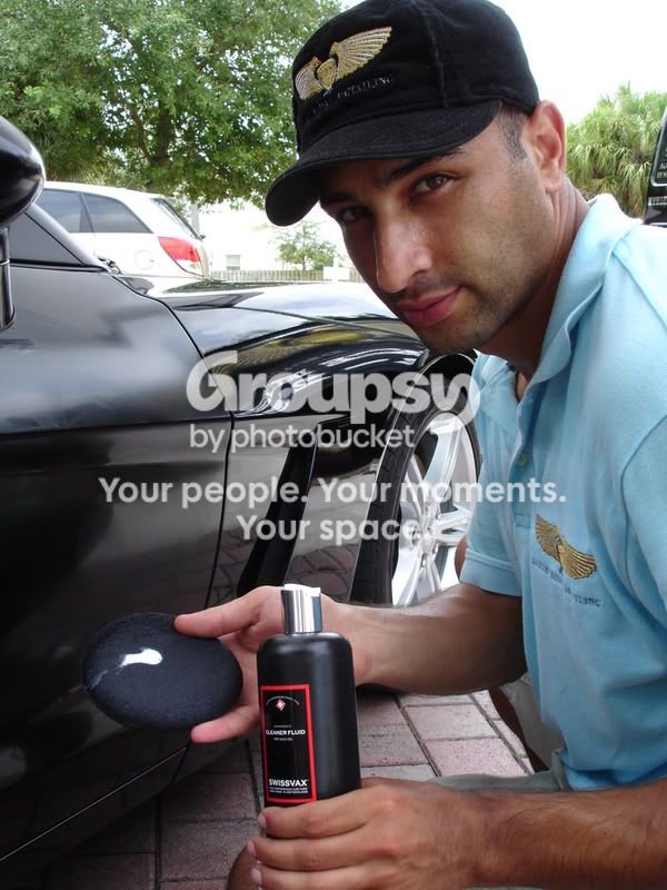

Swissvax cleaner fluid
[IMG][/IMG]

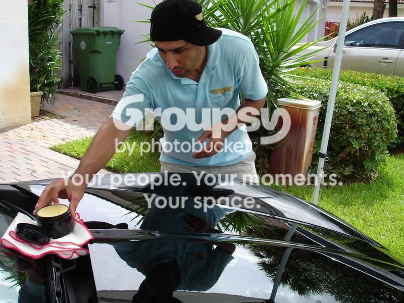

Swissvax Concorso
[IMG][/IMG]
[IMG][/IMG]
[IMG][/IMG]
[IMG][/IMG]
[IMG][/IMG]
[IMG][/IMG]
[IMG][/IMG]

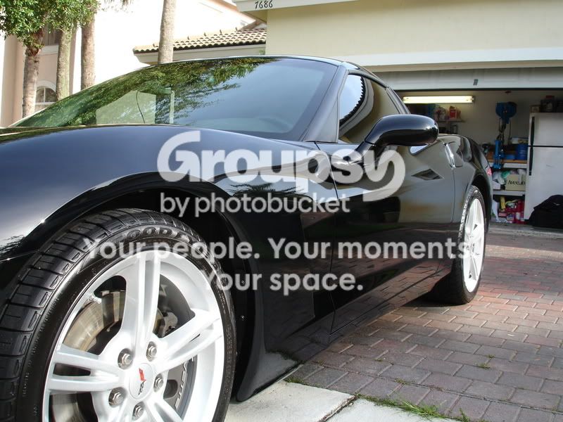

wet shine
[IMG][/IMG]
[IMG][/IMG]
[IMG][/IMG]

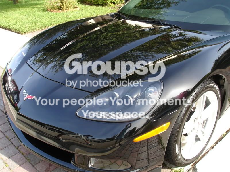

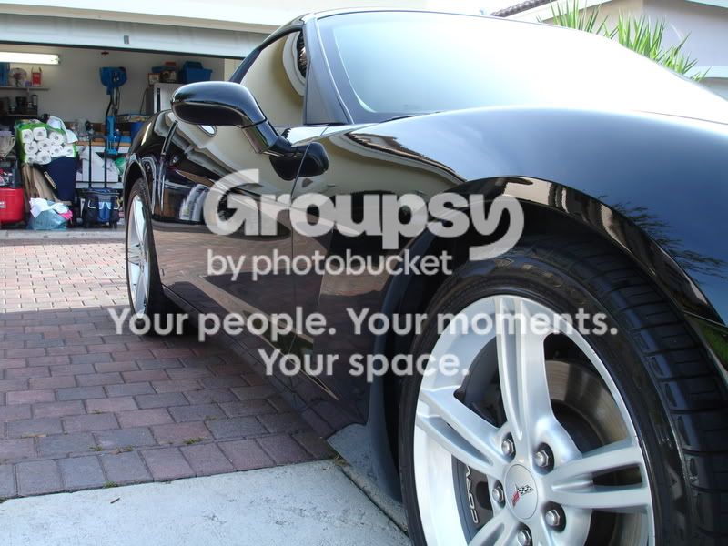

some quick finish spray and we are done
[IMG][/IMG]
[IMG][/IMG]
[IMG][/IMG]
[IMG][/IMG]

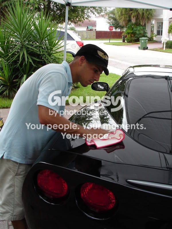

The Concorso goes on so nice and thin and easy with an applicator, why apply it by hand. I guess different strokes for different folks.

z06...
you are right...the Concorso goes on nice and thin.
when I apply Swissvax Scuderia, Zuffenhausen or Shield I use an applicator, but when
I apply Concorso, Mystery or Devine I use my hands for three reasons...
* The paint was so smooth...He beg me to massage him
* "Wealthy Clients" LOVES when you do that to their cherished vehicles
* Swissvax Factory tells you to do that with the Concours Waxes !
I tried to apply it once with an applicator and it didnt feel right, I had to warm it
up a little bit with my hands and then apply it...what a diffrent...like butter
I am sure that there are many detailers that apply it by hand and detailers that use an applicator...
I believe that you should go with what works good for you

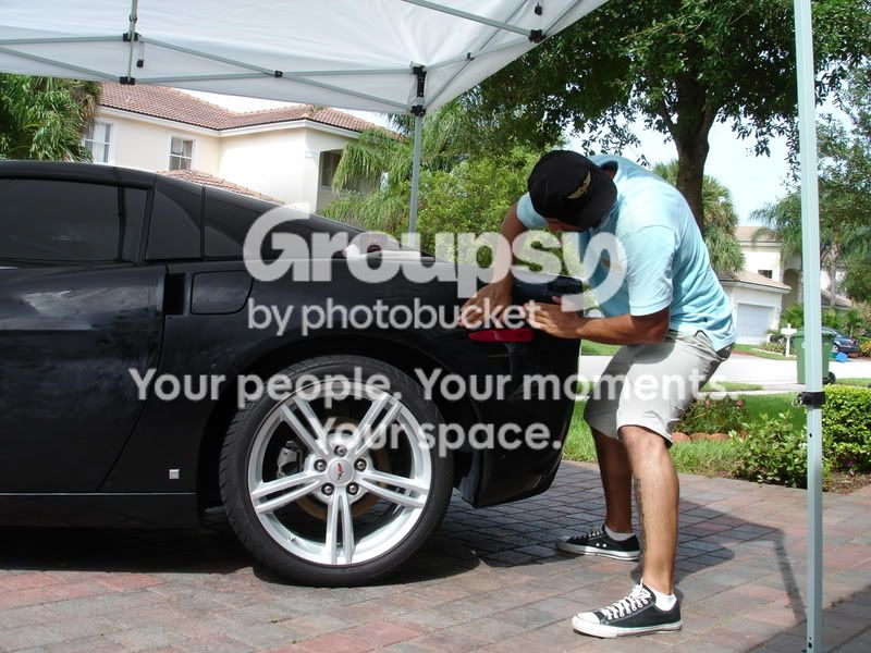

when i have to do a detail outside I try to do it later in the day and using my
Costco Tent...works good for me
