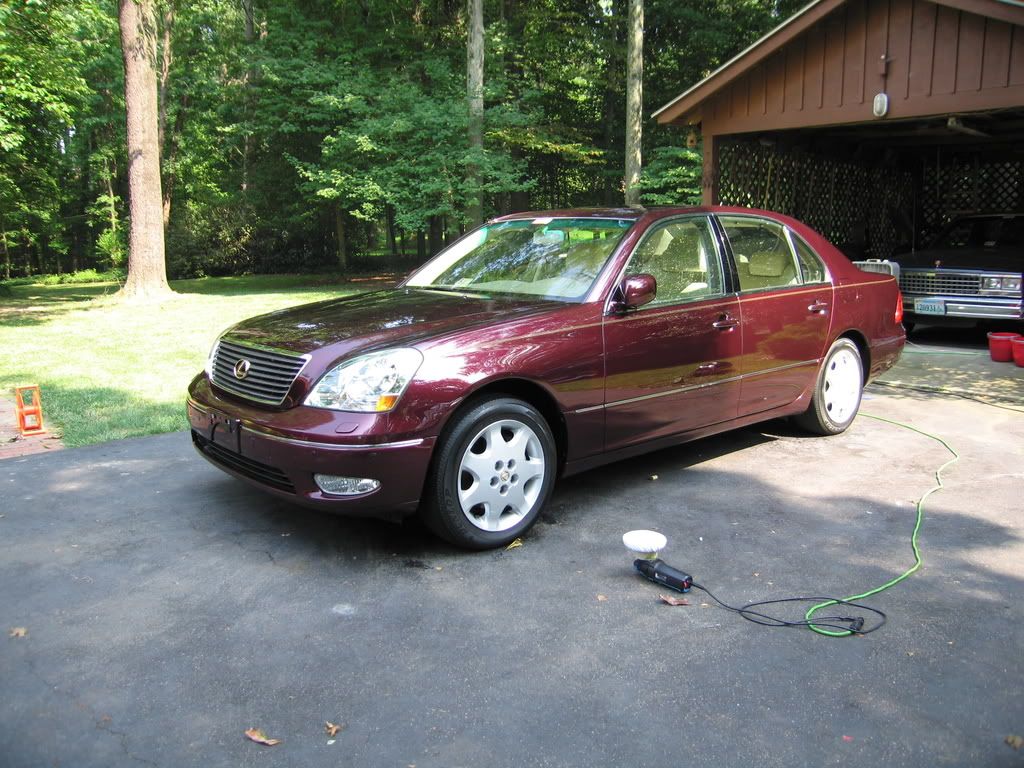

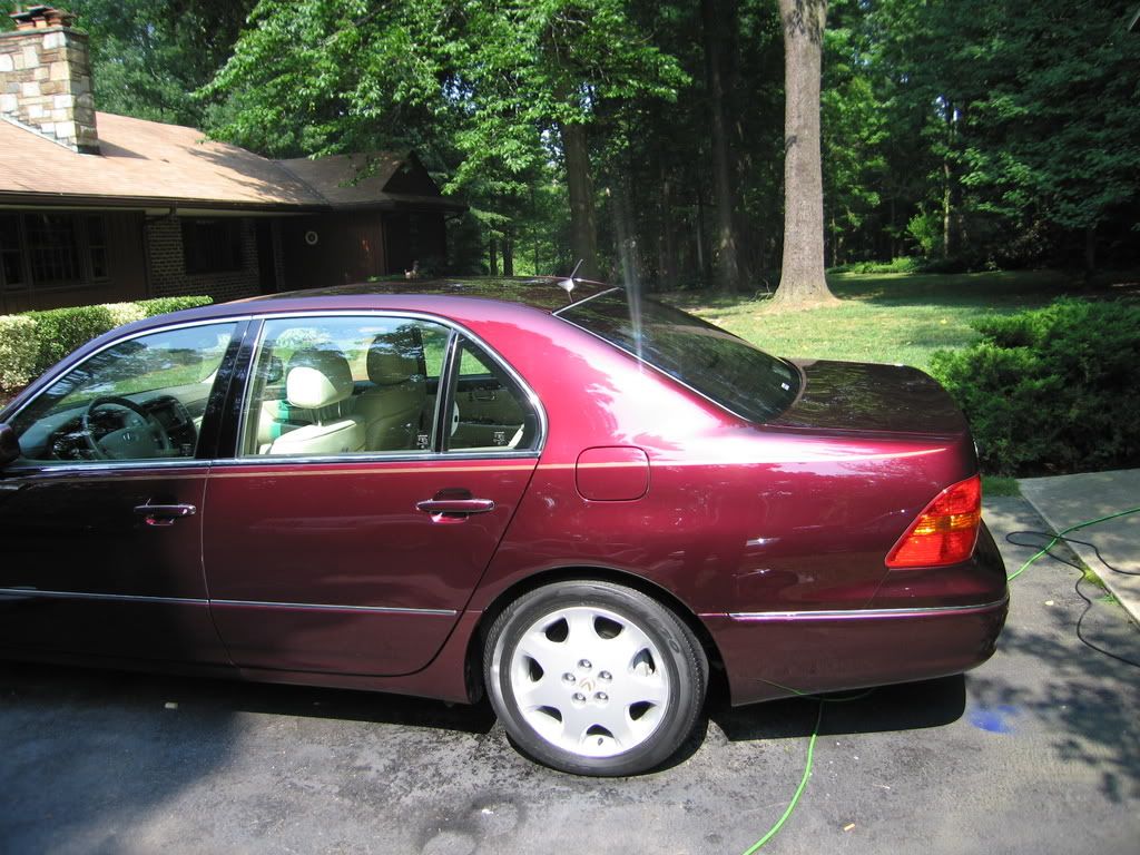

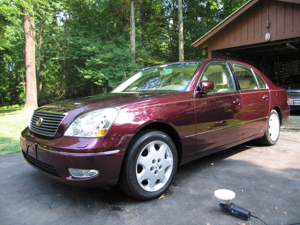

Not a full correction detail but (later I did the hood anyways) as it looked pretty bad.
the rest of the car was ok and many lighter swirls were removed in the polishing process. The trunk would also need some deep polishing.
wash
clay
poli seal udm gray 3M pad
Extreme top coat to protect udm gray 3M pad
grape dressing on tires/wheel wells

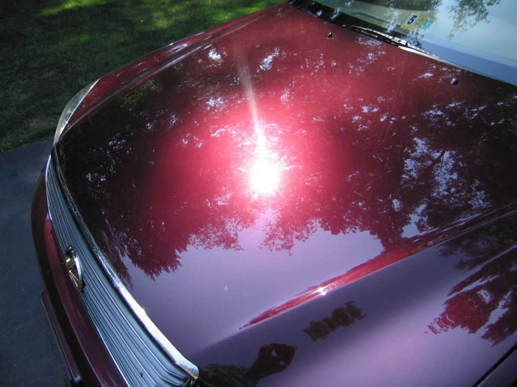

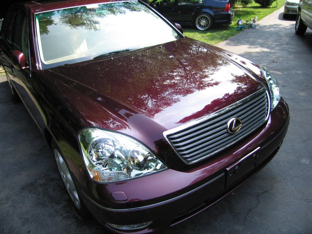

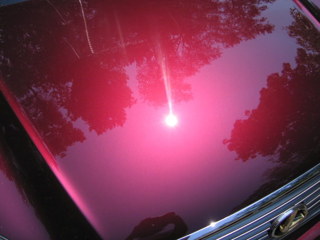

HOOD
EC pfw 1800rpm (3 passes)
UF gray 3M pad 1800rpm
poli seal
Hood before
HOOD after

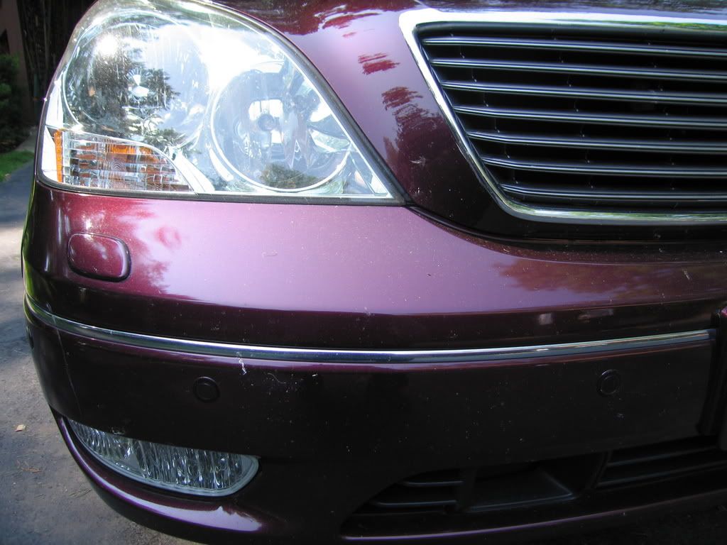

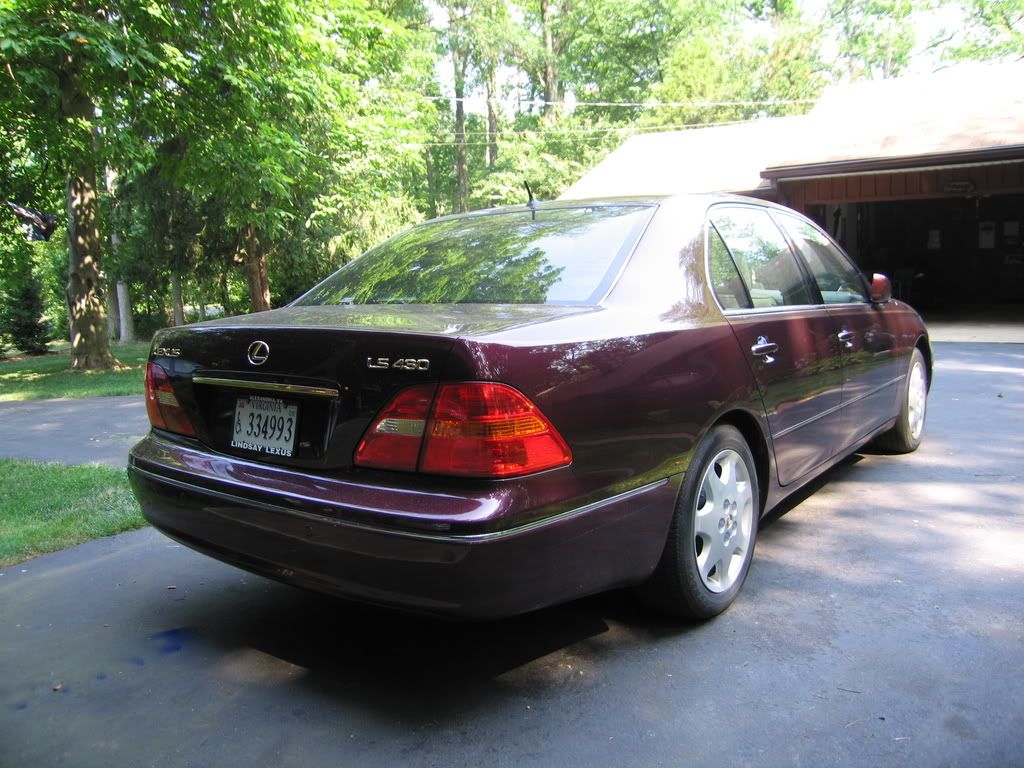

before
after
before
after
before
after
before
after

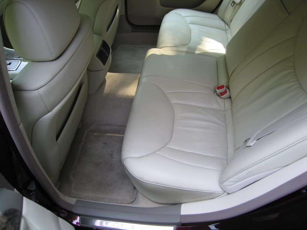

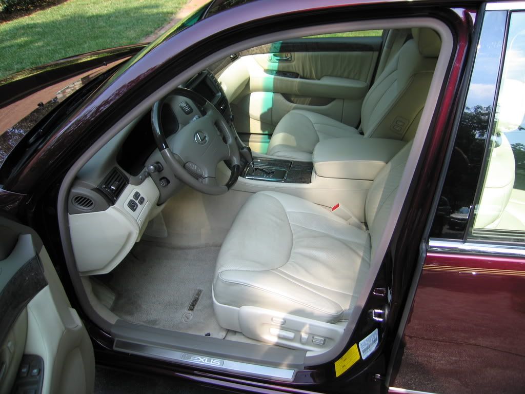

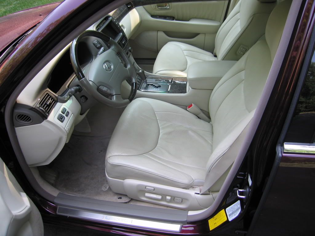

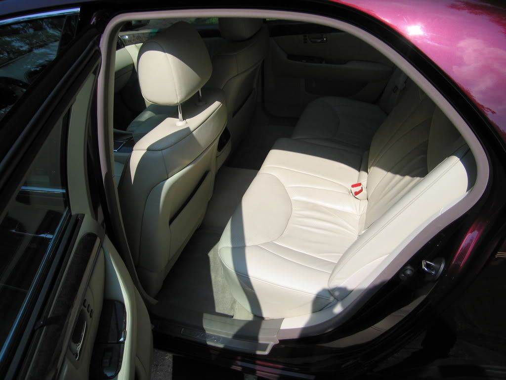

interior
vacuum
tol leather cleaner
tol carpet cleaner
steam - floor mats
S&G on windows and trim
before
after
before
after
Its nice to see a before shot that is clean and not full of crud and bugs. I dont know why people post before pictures of cars that have not been washed in months and then compare that to an after shot. I guess they feel its more impressive.
