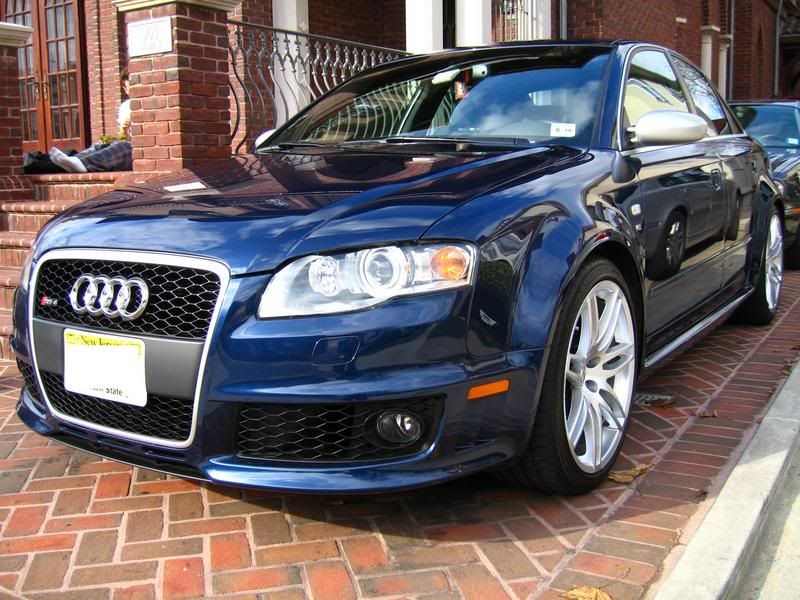

You guys will never believe me, but this Audi's clear was great to work with. This was a great relief from the usual clears that I have to deal with. Granted the car was between 4-6 months old and was in good overall shape.
Process was
Wash with ONR
Clay: Adams Detail Clay
Polish: Malco Swirl Remover via rotary at 1700 rpm with a grey finishing pad.
IPA wipe down to make sure no polishing oils left behind.
Seal: Zaino Z5 Pro x2

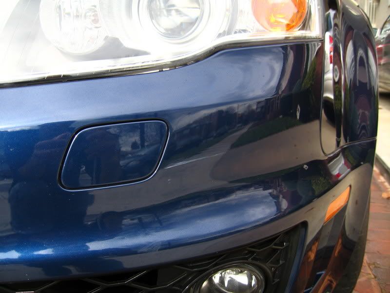

There was a slight paint transfer on the front bumber which I used the rotary w/ a white lc pad and Optimum Compound to remove it. I used the grey finishing pad on this application because swirls were very minor and they were coming very easily and the grey pad really finished off perfect.
Bumper scuff

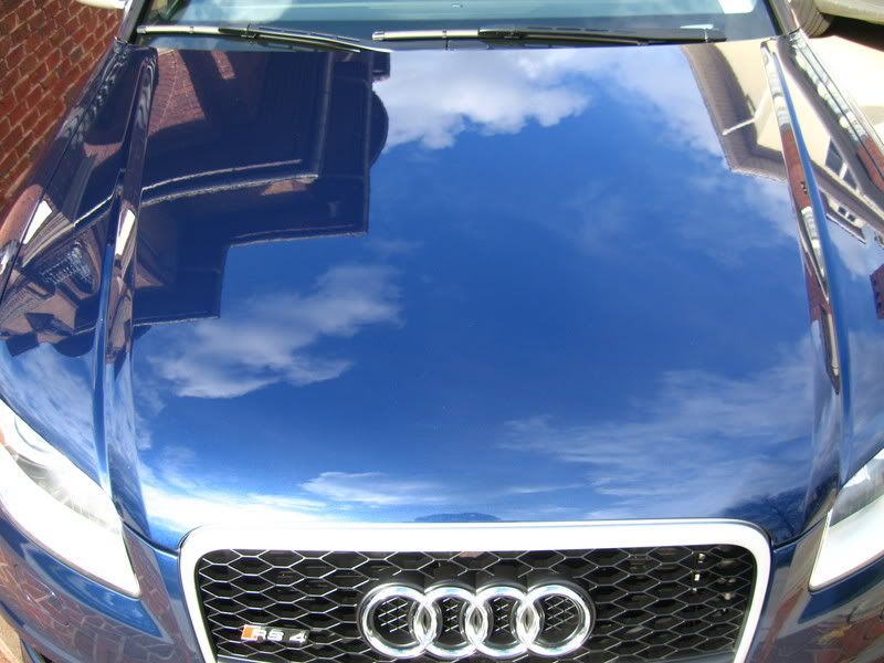

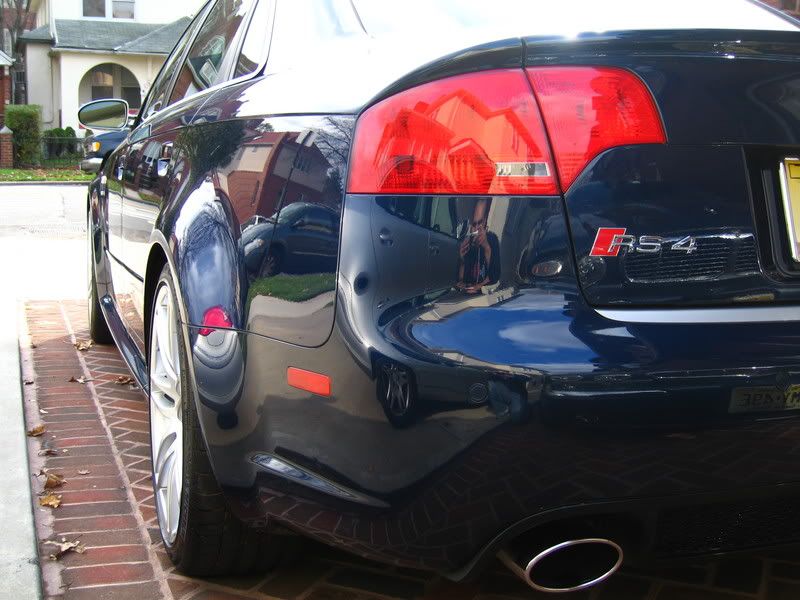

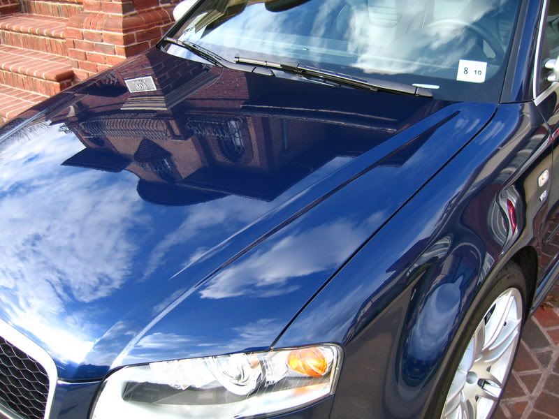

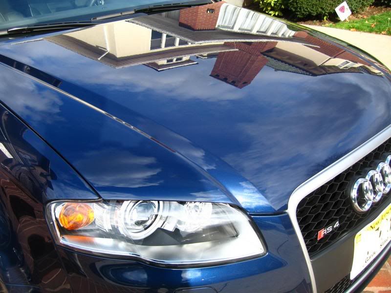

Completed Product
And the good old hood shot
